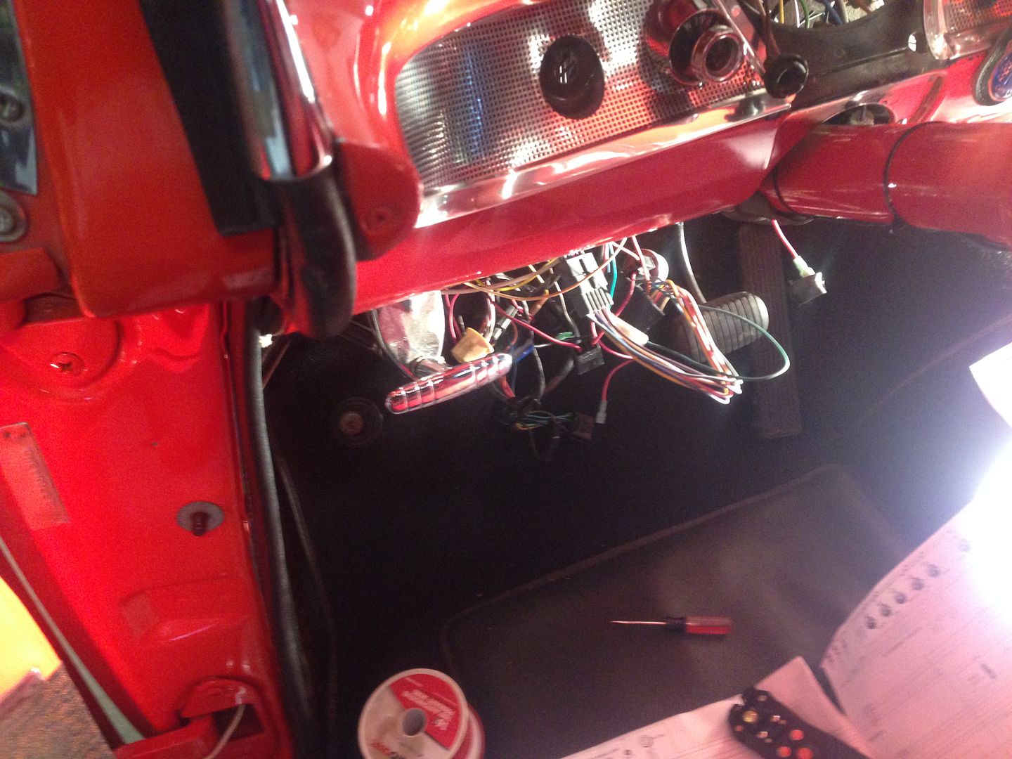

I finally got the motor mount situation corrected.......Lets just say the old engine fit.......but it wasn't correct....I cut out the mounts and basically raised the mount position 1/4&quot; to give me a little more pan clearance and made the mounts the same height relative to the frame (there was 3/16 difference)........I welded the spacer plate to the cut off mount......used my Jig and bolted the mounts in ......after everything checked out I welded them in......Side story........I have a good 110 volt Miller wire welder and got an education about extension cords......LOL.......I now have a new 12 Gauge wire one in the garage..........&quot;I are Smart&quot; now.........
Cleaned and painted the mounts and put the engine back in.......Fits &quot;Perfect&quot;.......Still waiting for the Supercharger &quot;snout&quot; to come back from Lingenfelter with the pulley mod for the Concept 1 Front Drive set-up......So...I started the wiring process with American Autowire Classic update kit ....Here are some pic's
