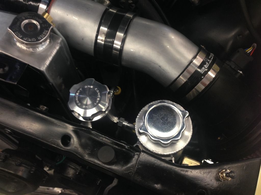

Update...........The refining process continues......(Does it ever end).........After installing the Supercharger and Hydro-Boost, everything got a lot better.......But.....Fitting everything together with parts in place at that time left a little room for fine tuning.........the car was perfectly fine, but a couple of little issues.......#1.....using the existing down flow radiator with the Supercharger caused a issue........to clear the new drive system, I had to run the upper hose up and over the system and the hose ended up slightly above the radiator tank leaving it with a large air pocket........it ran and cooled fine, but it wasn't a recommended way to do things........I decided to get a cross flow Radiator with both fittings on the passenger side of the car to correct that issue........After seeing the quality of the Auto Rad set-up for the Nomad, I decided to buy one from them........I made the right decision ..................Quality, Quality, and Quality........
Second Issue........After installing the Hydro Boost........I had a little minor issue of while turning, I would get a little intermittent loss of power assist.......I did some research and was told there was a slight amount of air in the system........I noticed that in the reservoir there was some turbulence from the return line in the tank with possible aeration..........I checked online and found that Concept One had a tank they specifically built for these applications that controlled the flow and softened the flow entering the tank to eliminate this problem......So.....
I took the car to Frame-Up Wheelworks and they went thru and installed everything as well as neatened up my mess of wires around the battery........after getting the car back all I can say is....getting everything close and working is O.K..........But......Putting the Bow on the Package and Fine tuning everything makes driving the car nothing but sheer enjoyment......Damm!!.......This Beater is Fun !!!

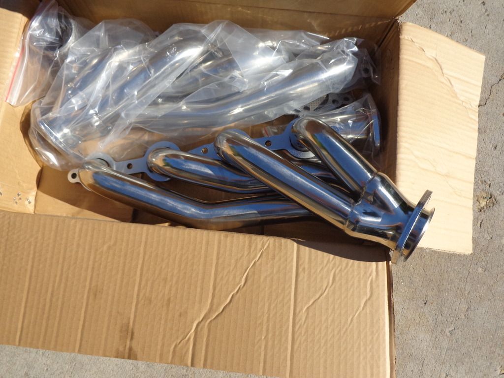

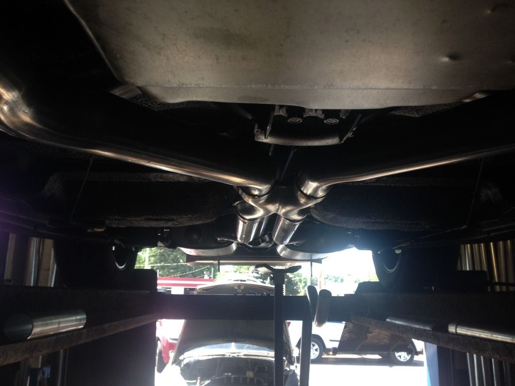

So..........The refining process continues.......But.....We are getting very close........When I did the car originally, I didn't know how to deal with the LS &quot;Rappy&quot; exhaust sound.........after getting the exhaust on the Impala during the initial build.........I had to go thru 3 sets of Mufflers to get the sound to go away and to quiet it down..........Ended up putting Cadillac Mufflers on it (Choke ,Choke).......since then I've learned that LS engines don't like long exhaust pipes (these go all the way back to the rear Bumper)..........and a &quot;X&quot; pipe helps kill the &quot;Rappy&quot; sound also.......
So....After finishing Gary's 65 and getting the exhaust completed with DynoMax Super Turbo Mufflers, an &quot;X&quot; pipe and tail pipes that exit behind the rear tires........His car sounded perfect........So.....I decided with last Winters mods to the Impala I needed to free up the Exhaust system.........It's going to the Exhaust shop on Monday for this &quot;Correction&quot; ....LOL.....I also bought a set of Headers off eBay that are supposed to fit........We will see........

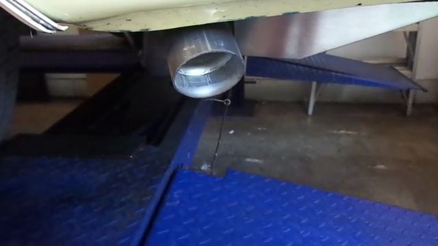

  #1298
Old 06-22-2016, 12:55 AM
kwhizz kwhizz is offline
Join Date: May 2004
Posts: 7,746
Thanks: 851
Default Re: Next Years Power Tour Car
Took the car to Dave's Mufflers in town and they installed everything........The Headers fit perfectly with out any modifications at all...(that was a surprise)........In and out in a day...........Here's a bunch of pic's
