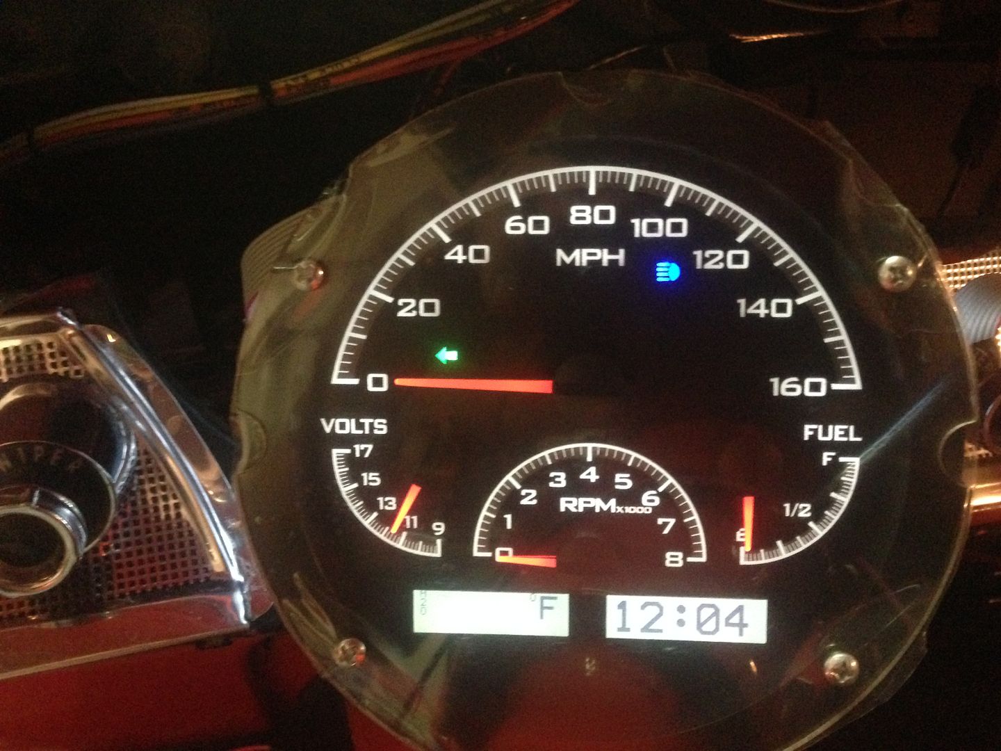

A little update......Still waiting for the new Front Drive to show up,...The Supercharger snout is still at Lingenfelter Performance for mod's....and the stock dash gauge housing was sent out for stripping to get the chrome off and ready for paint.....that will be painted and ready for final assy in the Dash next week ....so.....After finishing up the basic wiring under the dash.......the next big wiring issue is getting the Dakota Digital modules in and wired........there are three modules....the main VHX module......the Fan Control module.........and the GPS Speedometer module........Got everything hooked up and decided to take the Speedometer module out of the box and plug it in........ The Voltmeter guy does it again....Got Lucky (so Far) as the basic functions even work........LOL
