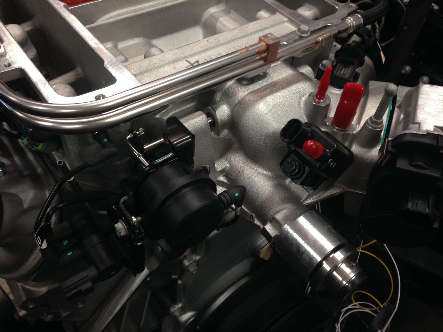

Just to get everything up to date...........I ordered a Concept 1 Front Drive set-up, and with this set-up........I had to take the snout off the supercharger and send it off to Lingenfelter Performance for modifications that are required for the new Pulley set-up.........So......I have been waiting for these items to arrive.........the Snout arrived today so I put the unit back together.....Hopefully the front drive itself will show up later this week..........

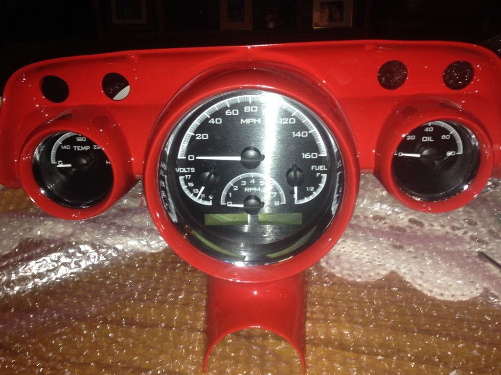

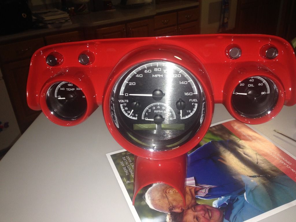

Here's a picture trail on the progress on the dash cluster.........When I got the car is had faded chrome on the cluster and the lower column cover......I sent them out and had the chrome stripped, then along with the cluster and cover I also sent the ash tray and glove box door to Puleras for painting...........the guy's at Puleras hit a home run again as far as matching the paint and the quality of the work done.........picked up the parts yesterday and installed the Dakota Digital VHX Gauges.....

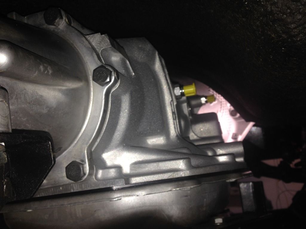

Now we get to the part I have been worried about..........Getting the 4L85E transmission into the car.....Get the car up on the lift and the moment of truth.......5 minutes later the trans is bolted in place with no issues at all.......plenty of clearance all around.......the 57 has an extremely large trans tunnel.........the Trans mount even bolted in place with two of the existing bolt holes.....But....After looking at the relation between the engine and the firewall, I may move the engine forward 1/2&quot; to give the engine harness a little more room.........gonna check it out a little closer today...........
