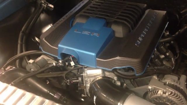

So......One of the maintenance issues with the 2014 and older LSA engines is the Isolator coupler between the drive pulley and the rotors.......originally it was designed with a spring mechanism to cushion the force put into the rotors.......well...in theory it worked perfectly........the downside is that the spring wears into the shaft and makes a Rattling noise that's sounds like marbles being ground up inside the unit........GM changed to a composite solid coupler that does the job and it's Quiet.....
So.........I decided to work on the Chevelle today and replace the coupler which requires the snout removal......Everything went smooth till it was time to break the snout loose.....Didn't want to come off, so....rather than force it , I decided to remove the whole assembly from the engine to do it correctly.........more work, but I can sleep at night now..............Got it all back together and all the marbles are gone.....LOL

Engine looks &amp; sounds very good, should move that vehicle effortlessly .Nice work.

What happens to all the little ground up pieces of metal from that internal snout coupling getting chewed up? Does it stay in that snout area or circulate somewhere more damaging? I imagine that after enough of it is created it just becomes a more aggressive grinding media that further escalates the erosion? How many miles did it take to get to that degree of damage?
This took about 14 K for that to happen.......Stayed right there in the case..........Eventually if not repaired with the new coupler it will take the bearings out........
