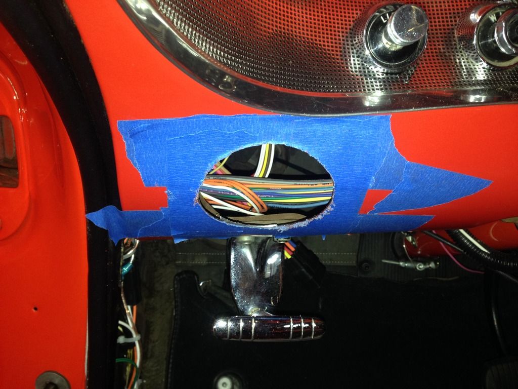

Easy project for today........Get the new (OEM) A/C vents in the Dash....Hole Saw, Carbide Burr to elongate the hole to fit , add the screw mounting holes ..........and get the "Tweeters" installed in Kick Panels......Easy day.....Now....Time for a Nap and some Football..........
Kick panels roughly stuck in place

a/c cars should have a spacer at the top of the park brake bracket to move the handle down. The spacer is about 1/4", intended to save the drivers knuckles from hitting the vent when grabbing the handle.

Thanks.........I'll make one and add it.............

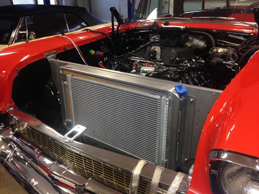

Christmas in January.......Came home to a bunch of boxes today.......
The small white box has the Vaporworx Fuel pressure control system in it.........The other three boxes had the AutoRad aluminum Core Support, aluminum Radiator that is all set up for the LS configuration, A/C Condenser and they built in the mounting for the Intercooler also..........A work of Art........Nice to get something that is better than expected........doesn't happen too often anymore...........
