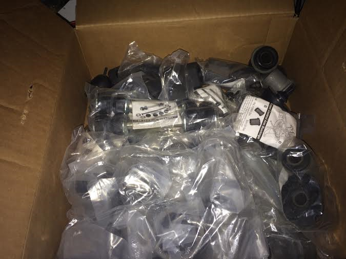

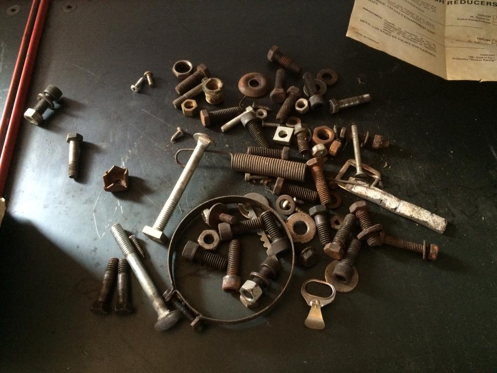

Sorted through all my boxes and labelled everything, except a few misc bins like this:-)
Even the misc boxes are cool 1976.... last year the car was driven.

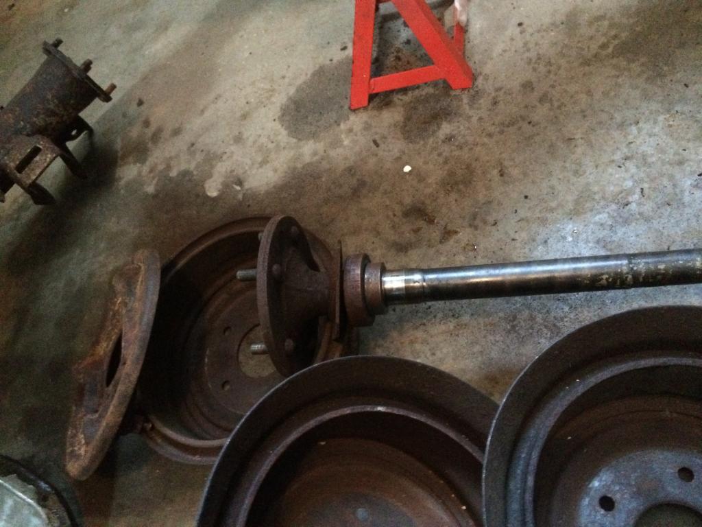

Have to press off the bearings and sleeves

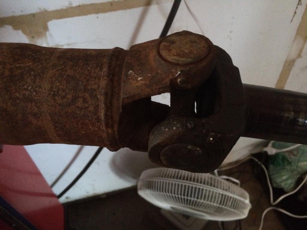

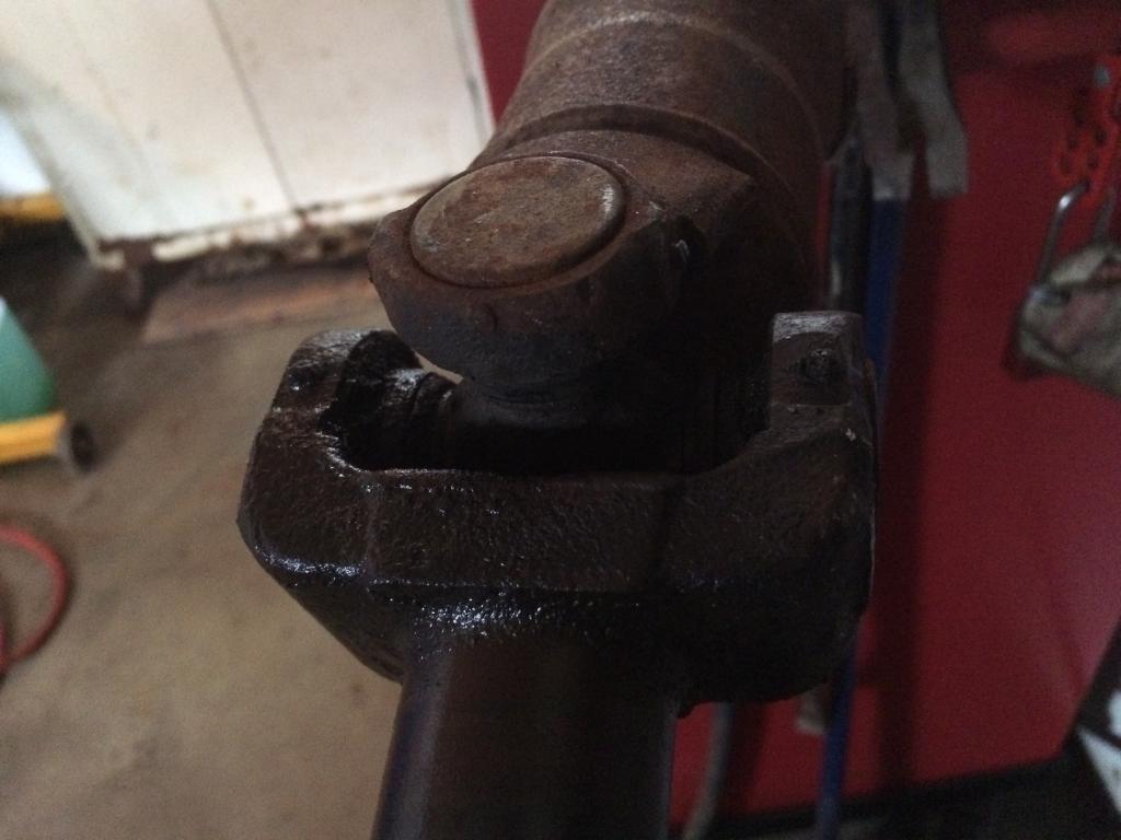

Found out I have to heat up these plastic plugs to get the original U-Joints out:-)

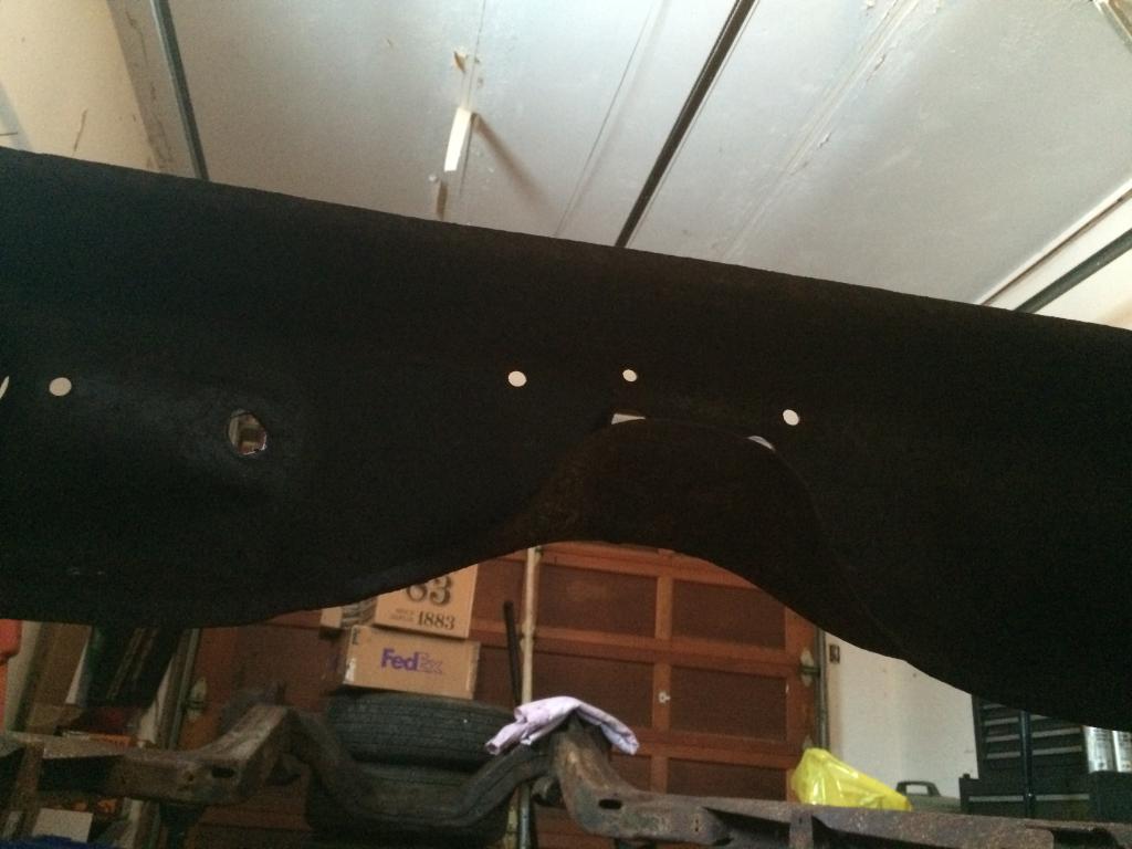

On Chevelle's I see a bumper/pinion snubber in the middle of the frame.... mine has a hole but no bumper..... should I add one? Is it a bumper for full down suspension travel of a pinion snubber like in leaf spring cars?

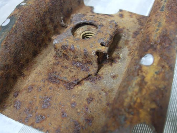

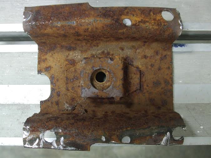

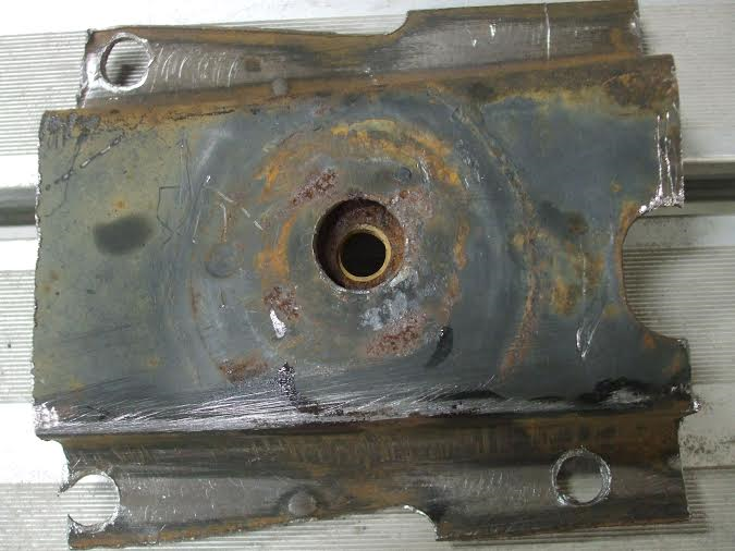

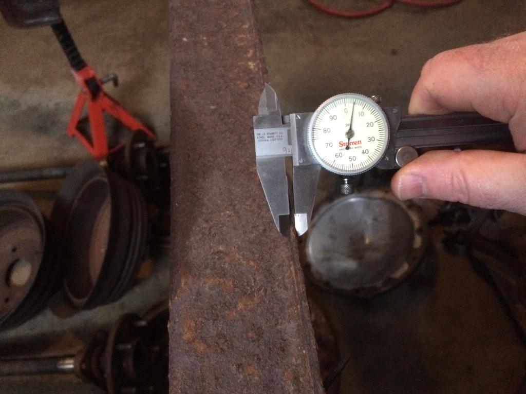

Need to make up washers to repair the two rusted body mount areas on the frame, thickness looks like 10 gauge will do, 1.25"

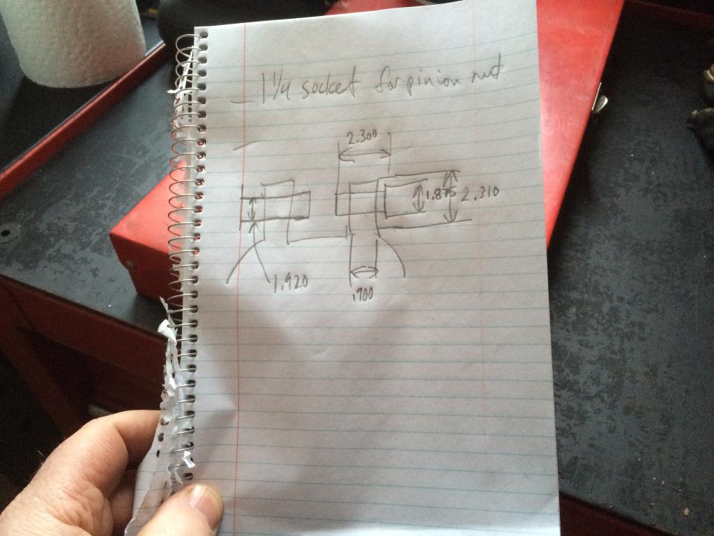

Terrible sketch to show bushing sizes in the upper ears of the rear end housing, and a reminder to borrow a 1 1/4 socket to remove the pinion shaft.

If there is no visual evidence of the rear end bumper snubber.....then it never had one. No reason to remove it, why would Al remove it?
I would ask this question to the Olds guys. if it did not have one....I would not add one.

I checked with a bunch of Olds guys and even a Buick guy (W-31-Killer Tom Miller 14K Mile car) and no indications that 68-72 Oldsmobile A-Body cars had them, other than potentially the Canadian made cars with the Chevy 12 bolt rear end.
I still don't truly know what this bumper would do.... my assumption is it would come in contact with the rear end housing after going over a set of rail road tracks at a high rate of speed (Bottom out) With a four link the geometry/pinion angle is set by the links (and the arc of travel) not like a leaf spring car with axle wrap to reduce with a snubber.....
I don't have any issue doing small GM bolt on improvements to my car, like trailing arms, and bumper/snubber for example, if it works better there is no downside. My focus is drive-abilty. &quot;Day 1.5&quot;

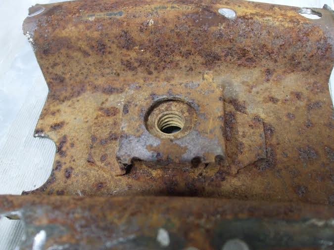

Rick Pauley sent me detailed pictures of the body mount nuts.
This makes sense now, I assumed the nuts are square inside the cage?
Thanks Rick!!!

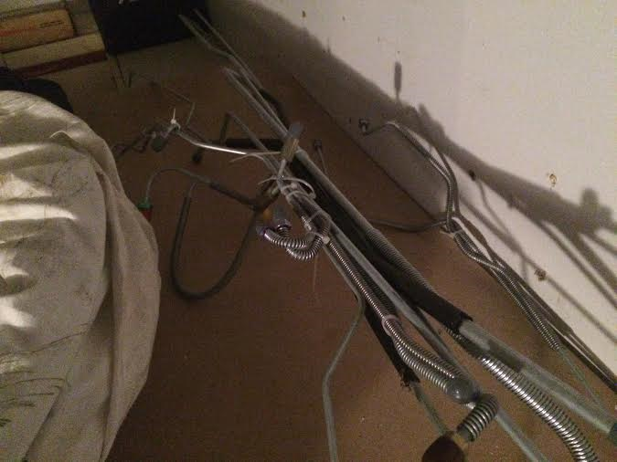

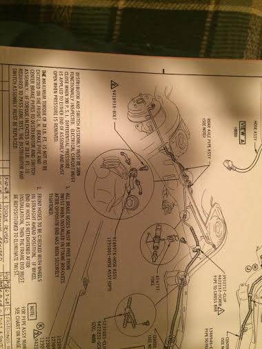

I have done a little research in the assembly manual, what a treasure chest!!!
For example Chevelle's have a bracket to hold the brake lines above the rear end housing, but Olds is threaded right into the housing, as shown in the assembly manual.
Started digging through my Inline Tube order this stuff is gold!!! I am so happy with the quality, looks like new parts.

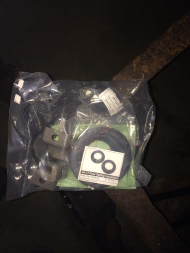

Lots of fun!! I also accidentally bought the rear bumper so I don't have to decide to use it or not...... I have it and I have a wrench:-)
Lines look perfect, I thought I was missing the little lines from the front wheel cylinders to the flex lines, but they are right there, complete with special fittings just like the originals from the car:-)
