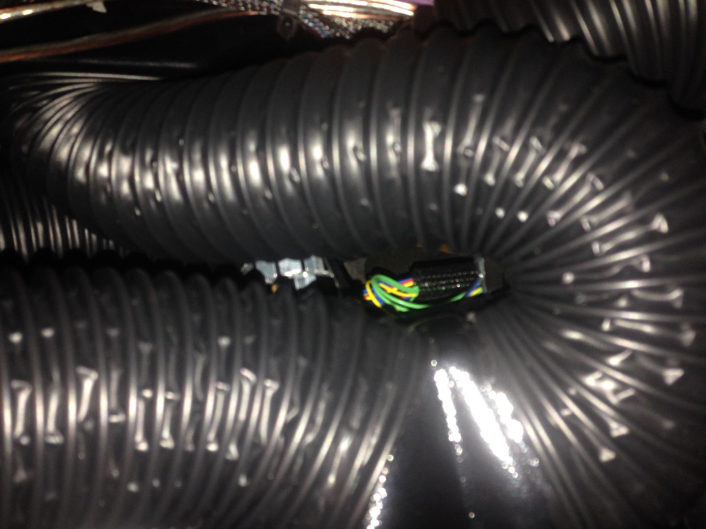

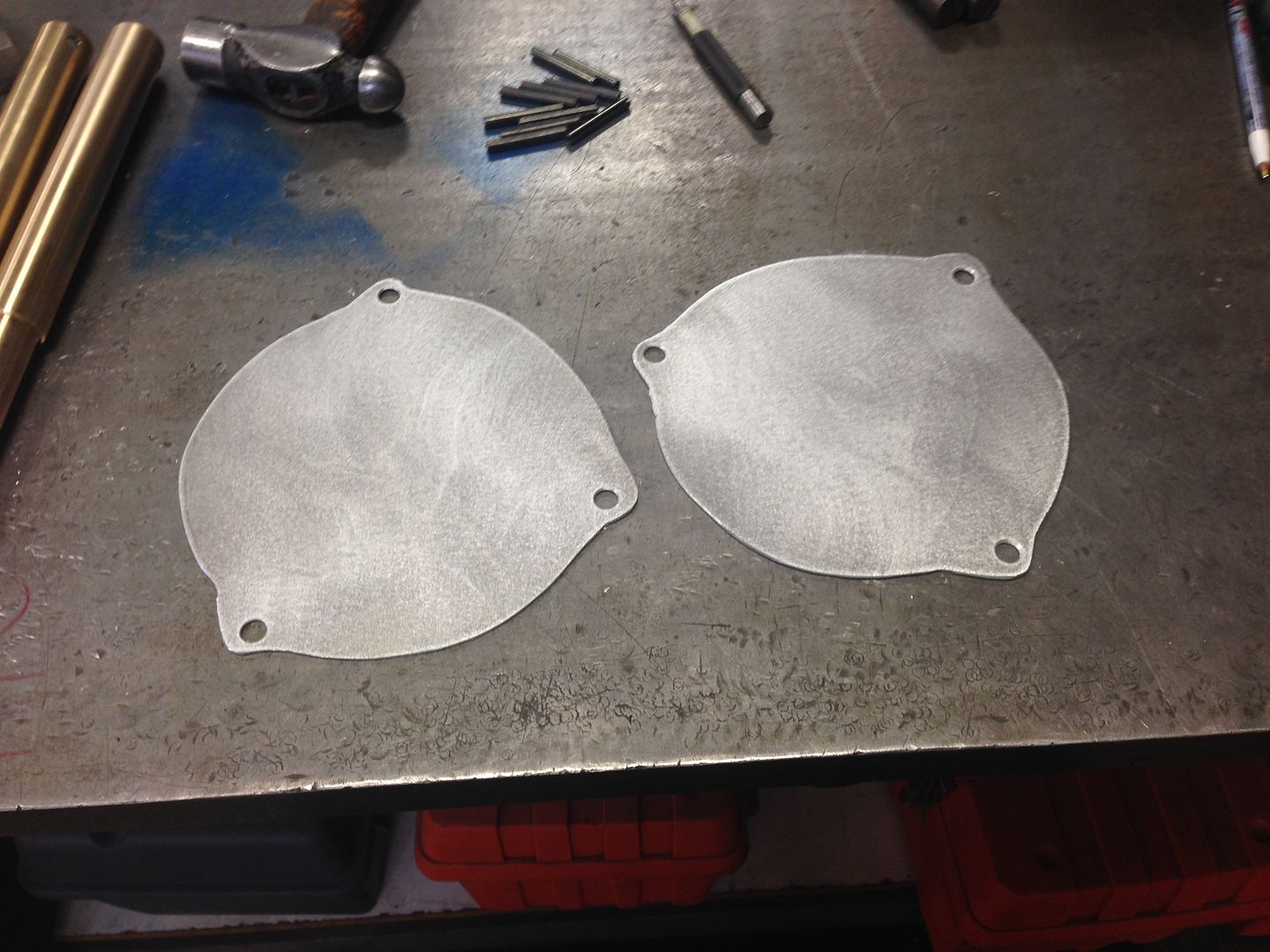

Before I could finish up the engine compartment wiring......I had to close up the fresh air vent openings in the Firewall after removing the vent tubes for mounting space for the control modules......So....I made a couple plates to seal the holes today......Got the passenger side installed (LOL...No room to get at the upper screw as it is right behind the A/C unit.....Took awhile)......And........While I was at it.....I had another issue that was making me crazy.....After getting the basic engine wires hooked up, I turned the key to start and expected the engine to crank over......Nothing.......Humm!!.....Checked the wires at the neutral safety switch.......Power there.......Solenoid wire at the starter.....no power.....Call the Tech Line at American Autowire and explain the situation.....I was told to check the plug where the wire goes thru the firewall......I forgot about that....and it's tucked up behind the A/C unit......(Damm that thing)....finally get it to where I can see it and noticed that the power terminal wasn't snapped into the plug body all the way and when I plugged it in it pushed the spade out.......Duhhhh!!!! Starter now works correctly....also got the GM supplied engine compartment fuse panel installed .......and Time for a Nap!!

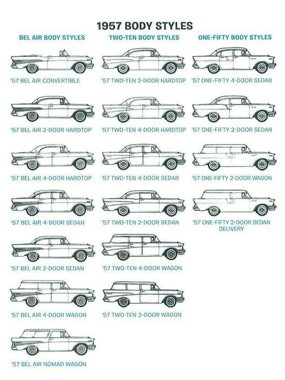

How to spot a '57 Chevy body style at a glance...
I currently own a 1969 Camaro SS350. Although the original drivetrain is long gone, this 4/speed car has a March '69 HC coded block with #041 heads. The transmission is an M20 Muncie #660 case and the rearend is a BS coded 12 bolt posi. Built in Van Nuys.

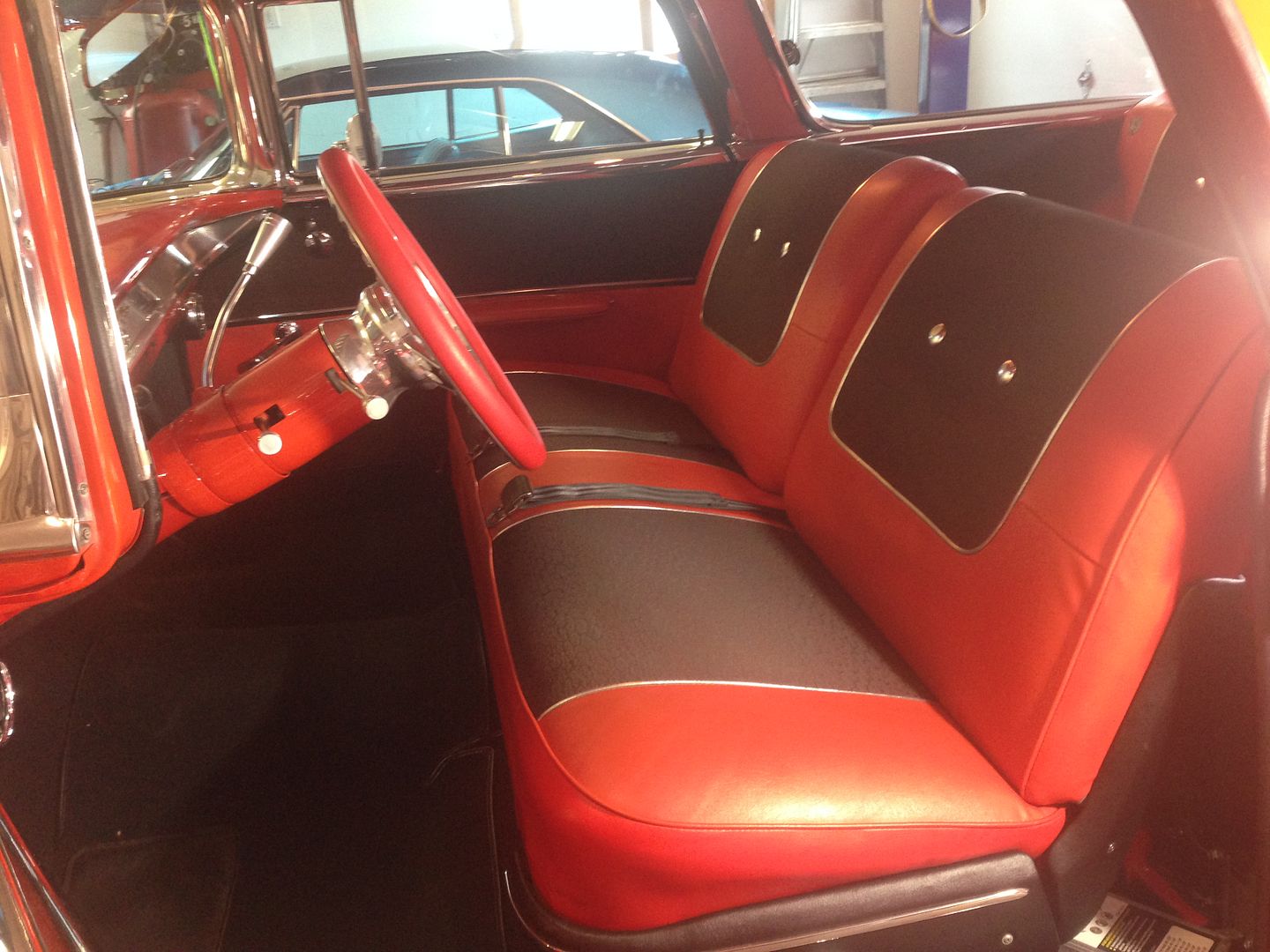

Got the drivers side fresh air vent cover plate installed.......I added a slotted area for the harnesses that needed to go inside the car......worked out perfect, after proving everything out I will seal it up with urethane........I also got the Dakota Digital gear sensor installed and hooked up inside the car along with a couple loose ends.....so.....all the wiring is completed inside the car......I just have to get the drive by wire pedal installed........so I decided to get the A/C and Defroster vents installed and put the gauge cluster back in.......everything works......even the check engine light (MAF) sensor not installed along with the gas pedal plug)........Getting Closer......Here are a bunch of Pic's
