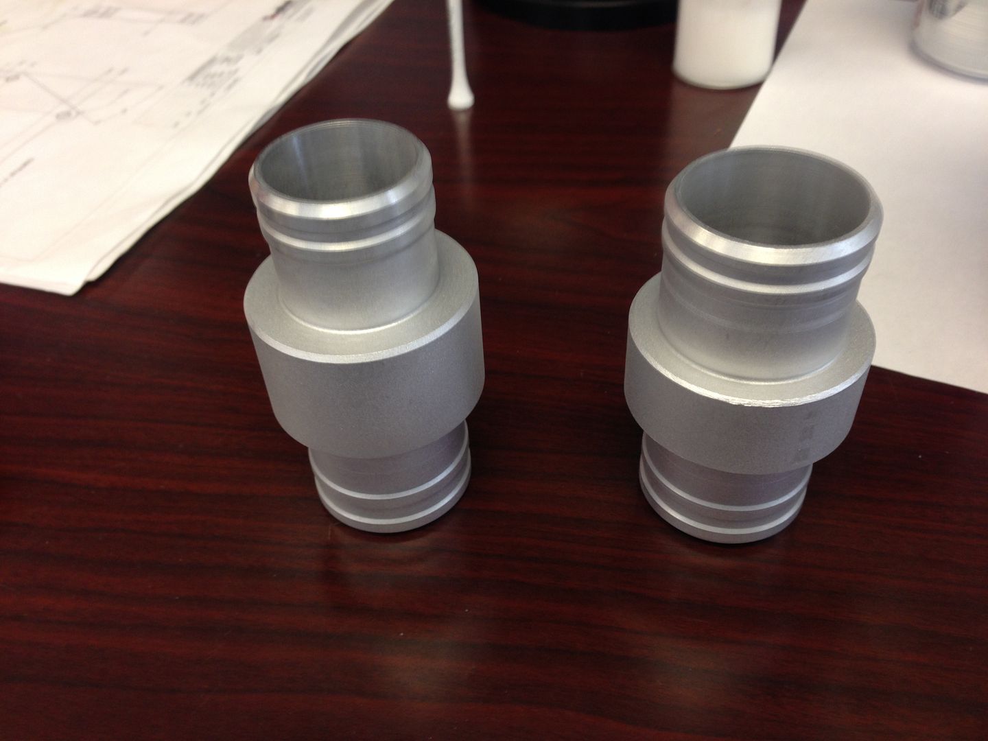

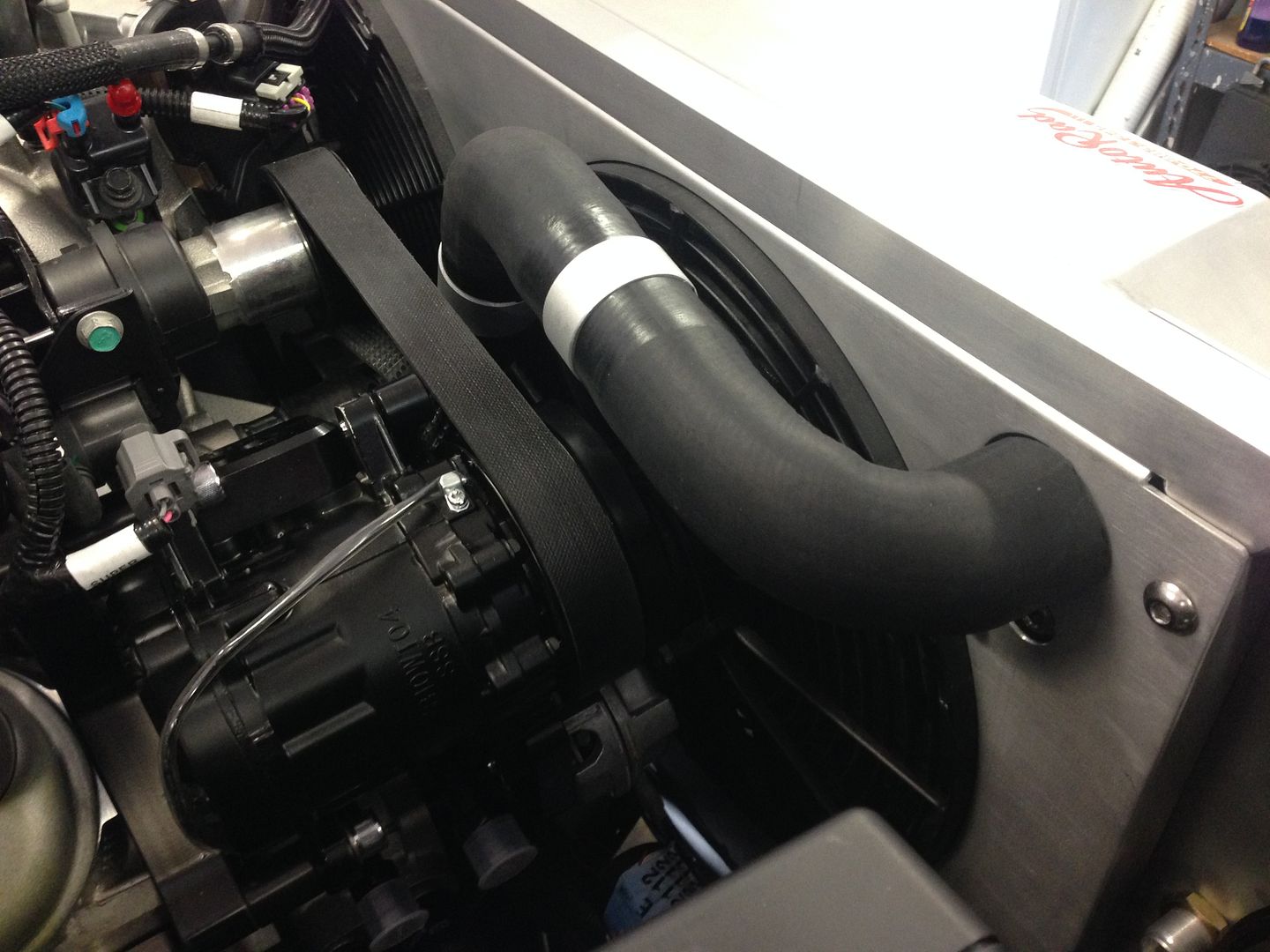

Moving along.........Got the heater hoses installed and on to the part that is a real pain in the rear.....piecing together radiator hoses.........So.....I made some adaptors today matching the different upper hose sizes and then went to the auto parts store trying to visualize cutting sections out of hoses to get then to suit my application.......ended up being simpler than I expected.....I ordered a bunch of heat shrink hose clamps that will be here Monday so I can get them finished....Supercharger intercooler hoses are next........Getting closer......the adaptors are Aluminum Glass Beaded

Love them adapters....very nice work [img]<<GRAEMLIN_URL>>/biggthumpup.gif[/img]

Ken, you found a way to fill that big open space in front of the rad support that always looked like a place for a spare tire. Looks great!
