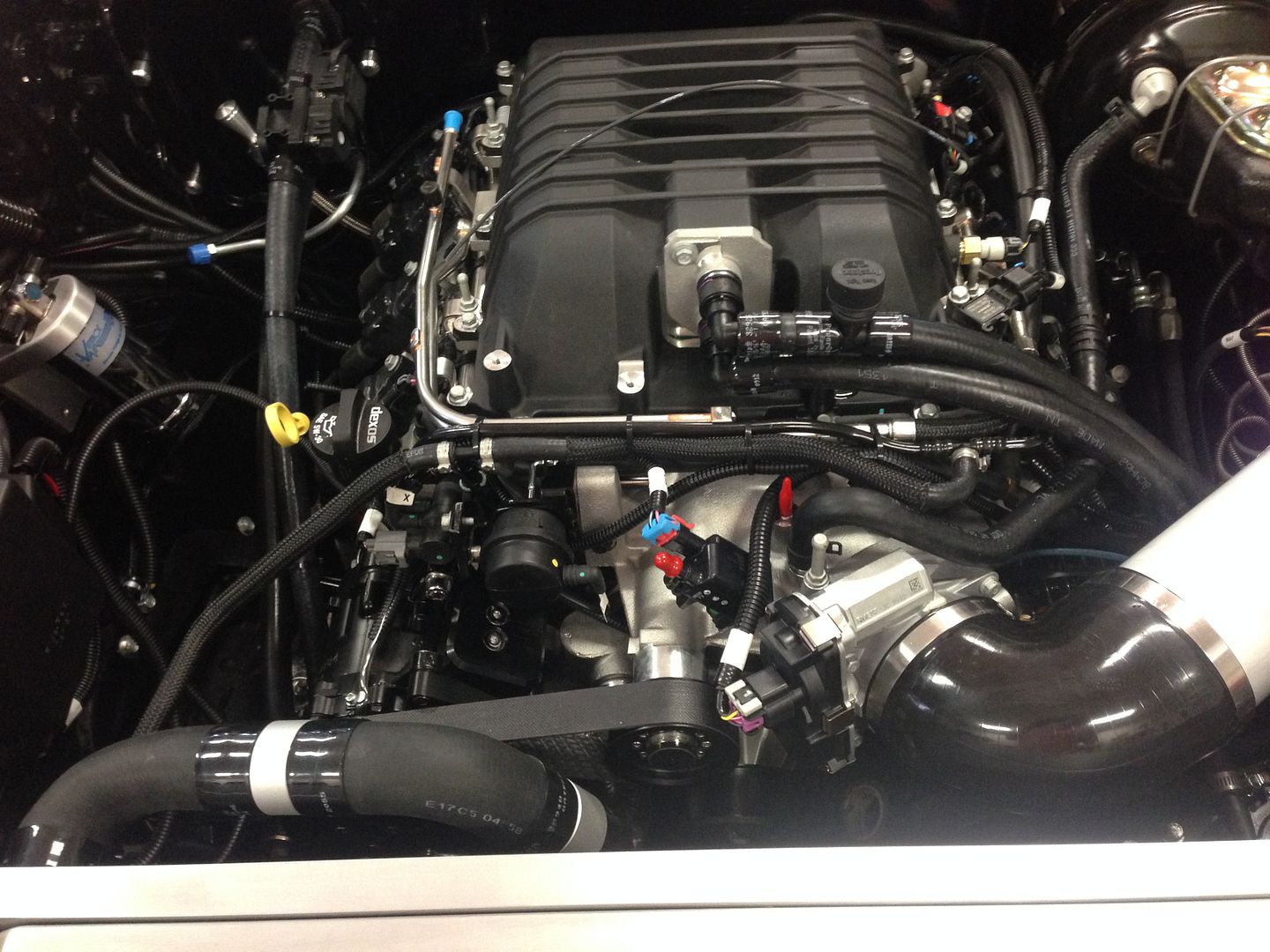

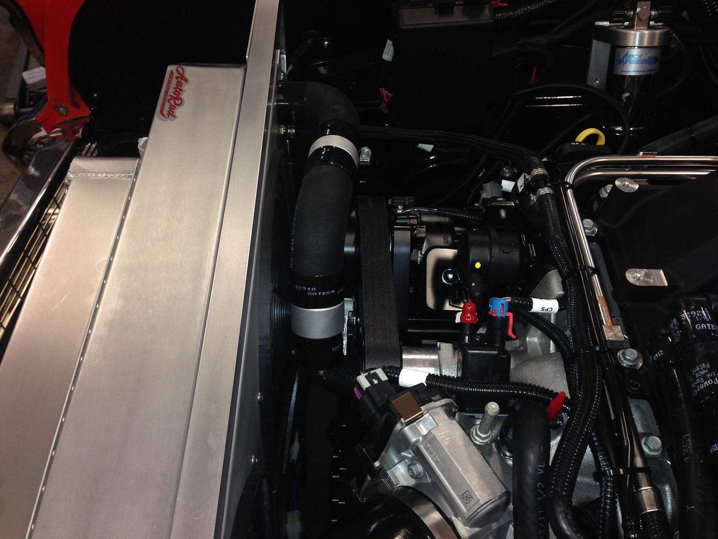

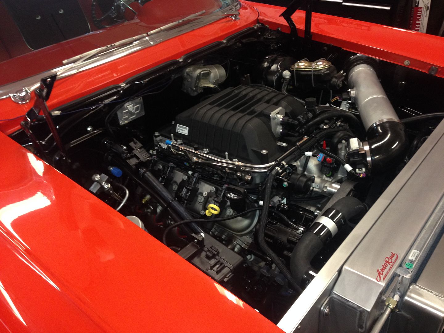

Got all the radiator hoses installed and sealed........also got all the intercooler lines run and sealed up then filled both the Radiator and Intercooler........Almost time to put the Hood back on........so.....I have to make a mount for the throttle pedal and get the fuel system mod's completed and the exhaust system made.......But...other than that.....Engine compartment sure filled up....LOL

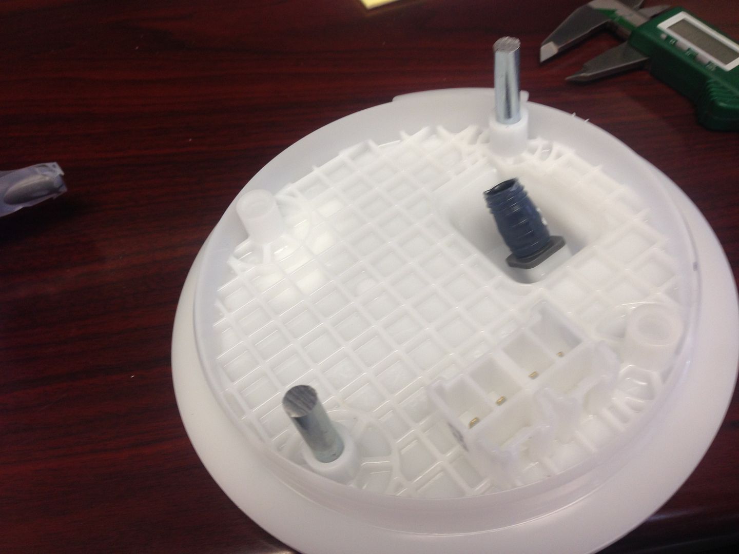

Well........The last big hurdle is the Fuel system......Two issues here.......#1....The Nomad gas tank is nothing like a stock 57 tank......with the spare tire well in the rear floor....there wasn't too much room left for a gas tank.....so GM pretty much form fit a tank in the space that was available......as you can see........
And a new tank I bought for Modifications.............
I'm using a GM LSA Fuel pump which is 7 1/2&quot; high and the Nomad tank is 12&quot; deep.....So......two problems....the GM pump needs to be spring loaded against the bottom of the tank......so...I need to build a recessed mounting system for the GM pump......and I need to lengthen the stock LSA pump to replicate the stock compressed GM specs......Here are some pic's of the Tank Modifications.......Should be finished later this week........

And........The Fuel pump.........A couple of concerns here.......The GM pump has exposed wires that are submersed in the gasoline........So....I found out by asking the experts on LS1tech how to extend the wires while lengthening the pump......I was told to use PTFE wire and shrink tubing only.......took a while to locate the Teflon insulated wire and shrink tubing......finally got everything and got the wires fixed.........next was the flexible &quot;Soda Straw&quot; feed line from the pump to the outlet port on top of the assy........couldn't figure out a good way to lengthen the corrugated plastic tube without crushing or restricting the line........so.....I ended up getting some -8 braided stainless fuel hose and it worked out perfectly......I cut off the plastic tube and left the stock GM RF sealed tube ends on the fittings.....the -8 hose fit over these tube ends perfectly and will be held on with stainless hose clamps.....then I made some stainless rod extenders and longer springs to make the pump to the new length.........all finished, just need to wire tie the wires to neaten then up.......
