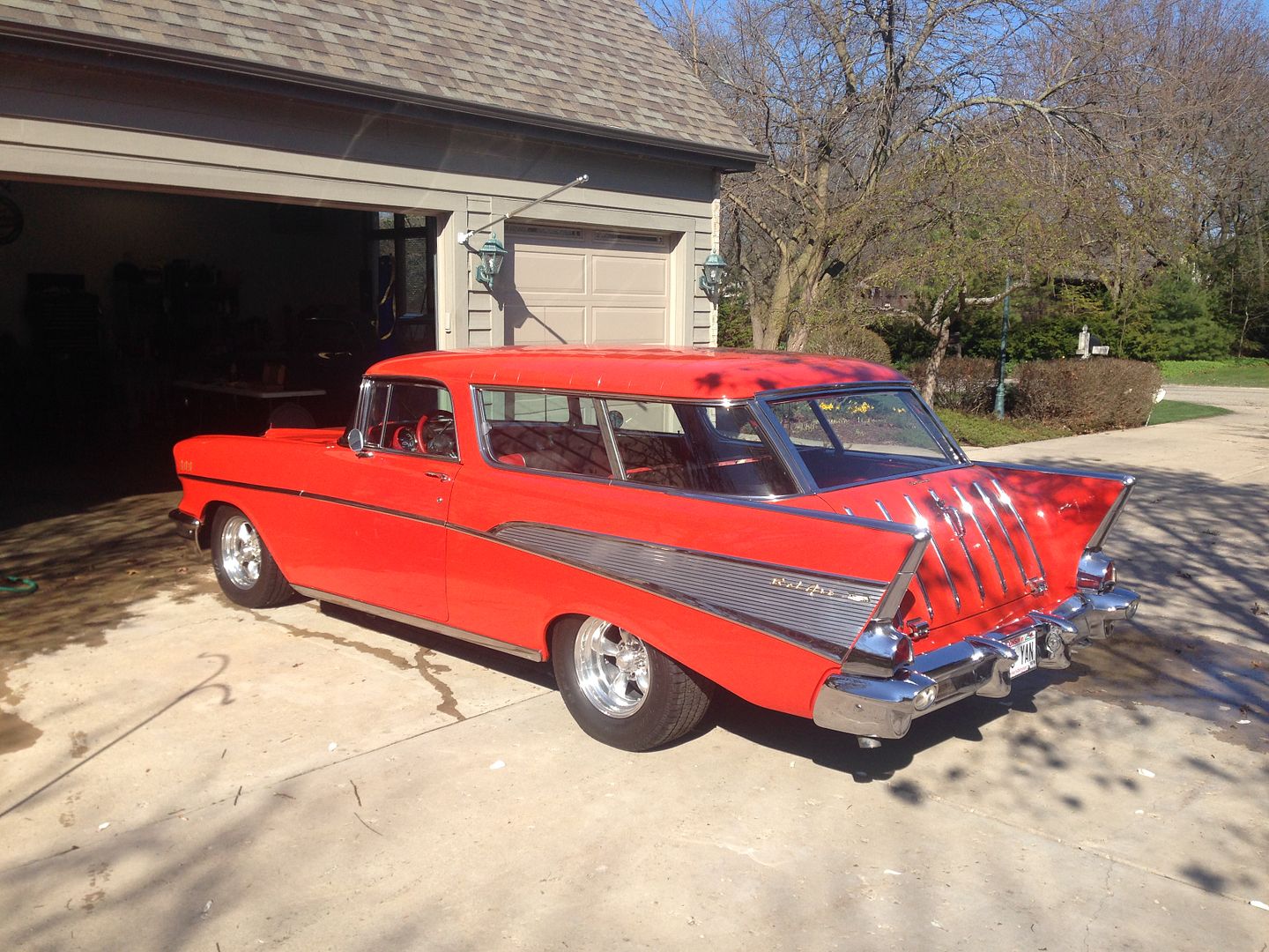

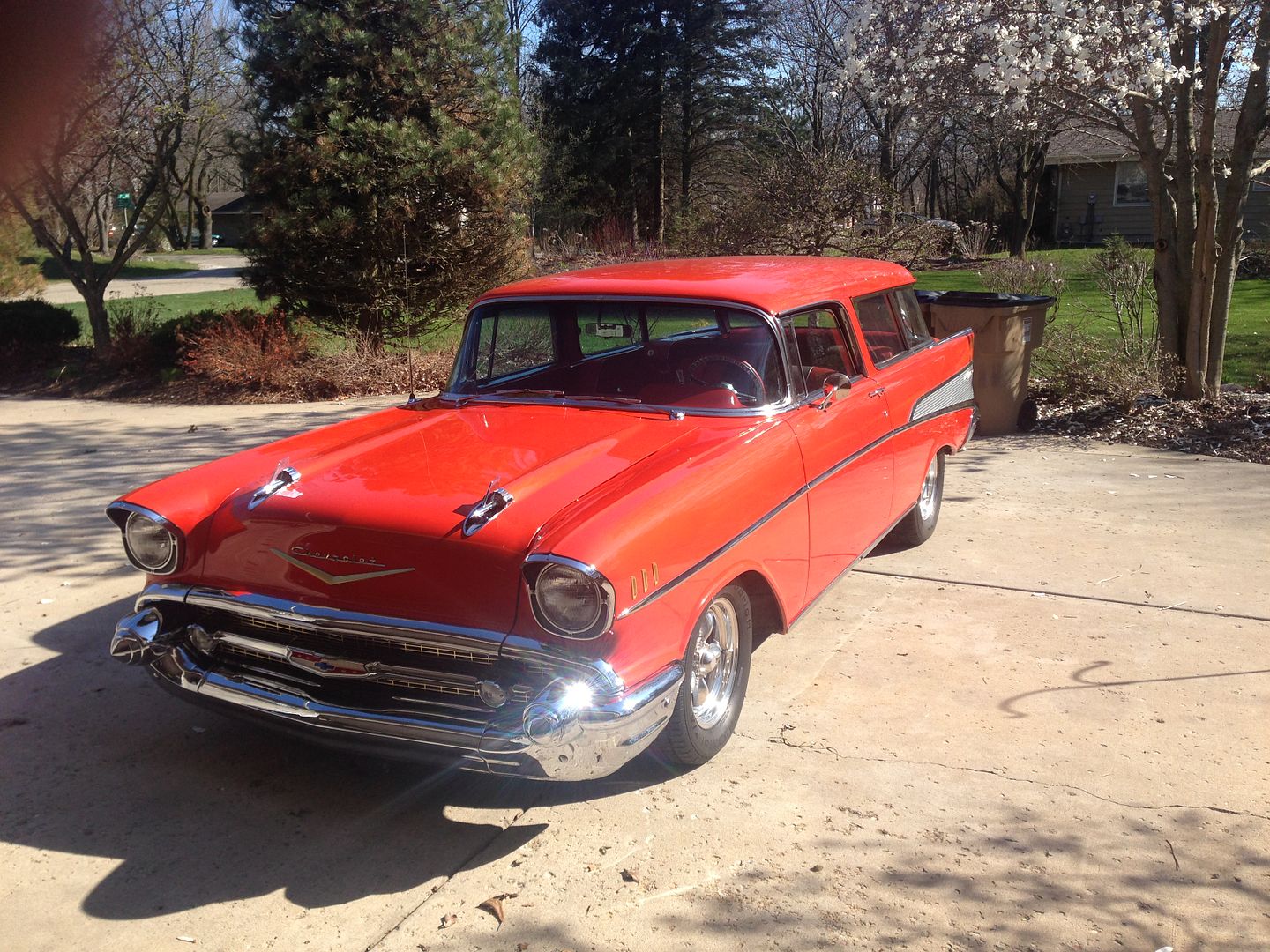

Had another little issue come up......when I did the gas tank revision I didn't think it thru correctly, the stock fuel level sender had the float arm going in to the left.......LOL.....it and the new fuel pump were fighting for the same spot..........I ended up ruining the original sender in modifying it......new one showed up and was modified correctly ..........cut off the pick-up tube that the sender was mounted to and rotated it 180 degrees......and since I am not using the tube anymore we welded it up solid to eliminate any fuel leaks.......installed it and everything works perfectly....Two little issues remain (until I find more).........the intercooler pump doesn't turn on and the fittings I used to connect the intercooler lines to the Supercharger leak.........Always something.........the exhaust will go on this week and I moved the car under it's own power for the first time ........just in and out of the garage.........
