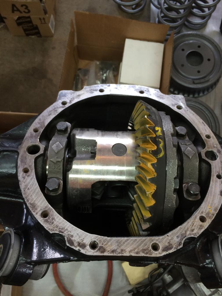

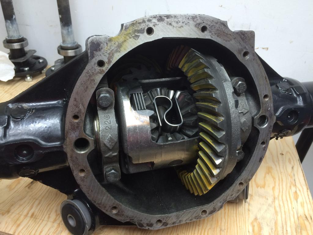

I am learning quickly about O-Type anti-spin rears:-)
Chatted with Greg Rollin at Supercars Unlimited, and Brian Trick Olds rear expert, and I now have the confidence to set up my "Posi" and get it hung on my chassis. Also Tweed V. And Dave H are helping me on FB (It takes a community)

Ended up adding 0.012" to each side of the posi to bring it back within specs:-)
She should grab and go now:-)

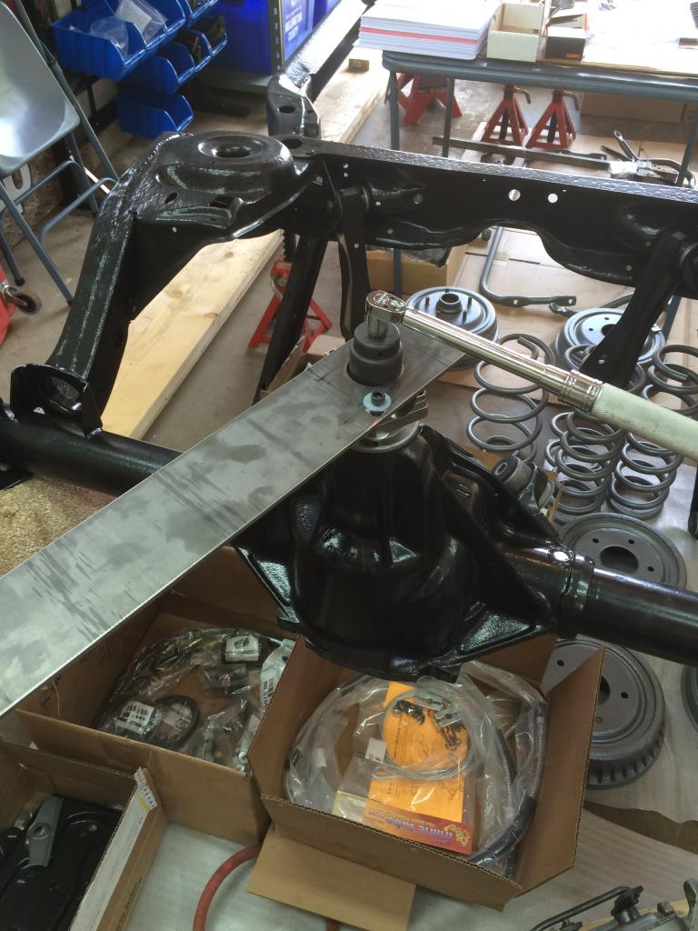

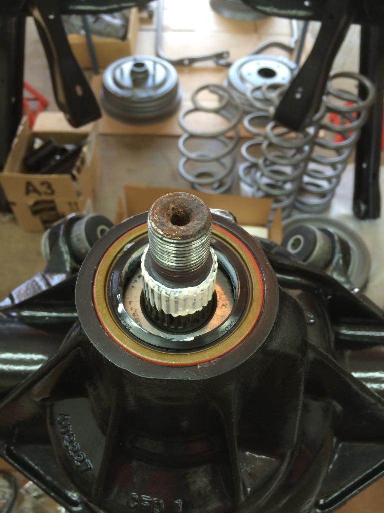

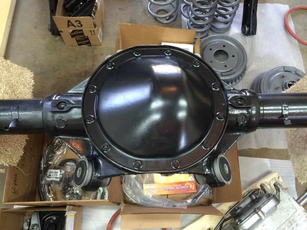

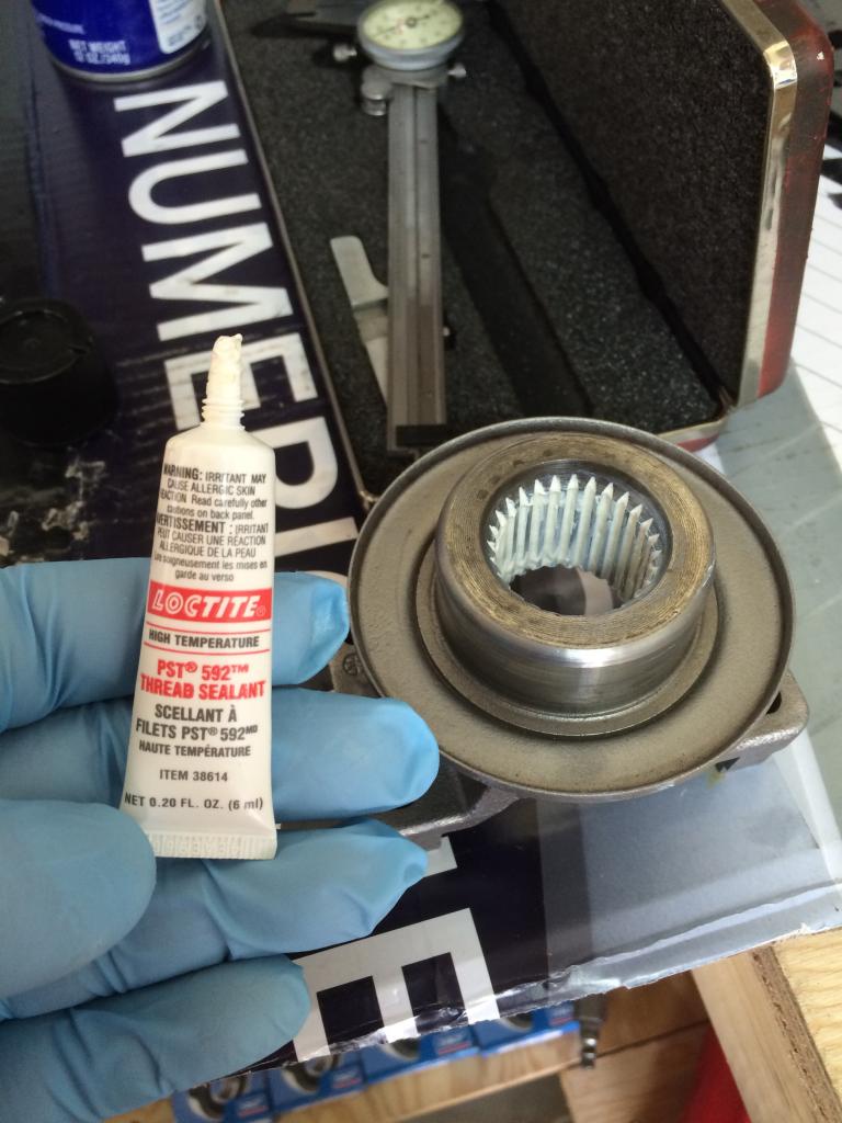

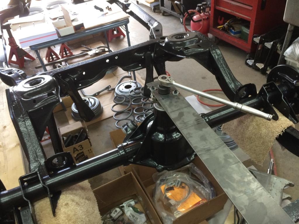

Home run today!!

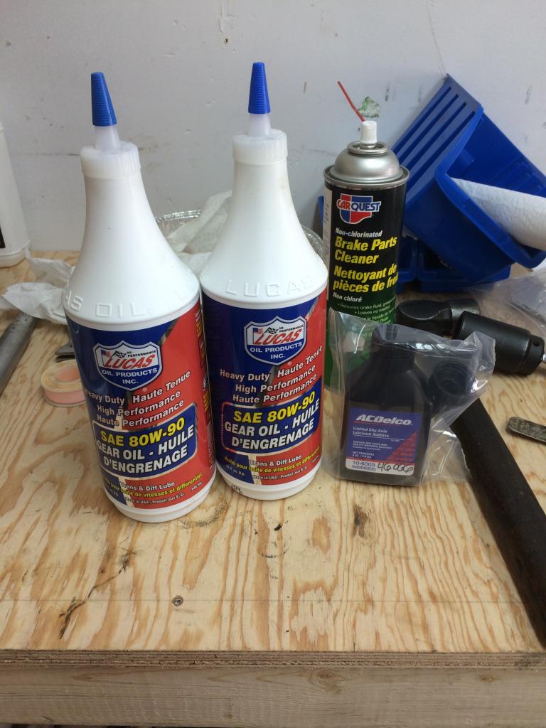

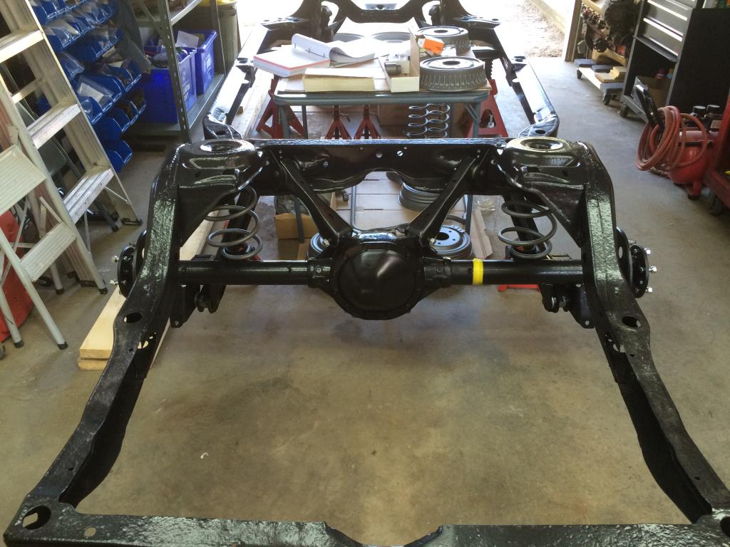

Wrapped up the rear end rebuild.

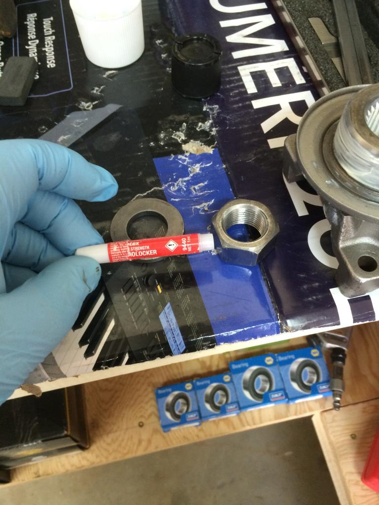

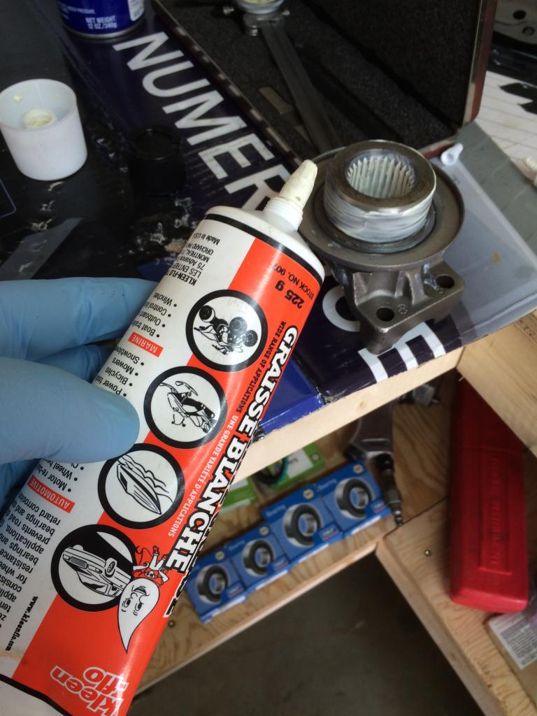

Red locktite for the pinion nut and cross shaft bolt, sealant on the pinion yoke splines, and white lithium grease on the seal surfaces. Then Lucas gear oil and GM posi additive:-) I even restored the original cover bolts. Done!!

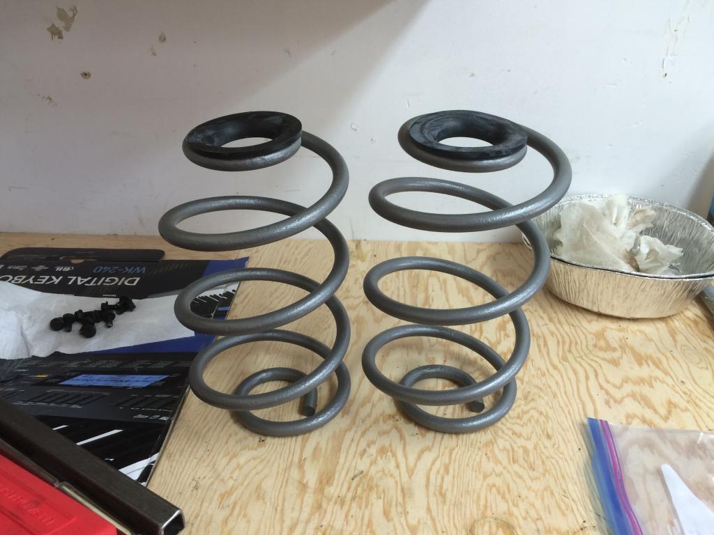

My neighbor, Jamie and I installed the differential in the frame, that felt good!! I put the springs and insulators in. Next step is to paint the shocks and install. (I am using generic shocks as the repop spirals are so expensive and these are an easy upgrade in future if the need arises) I also may get drag shocks for PSMCDR)
  #1525

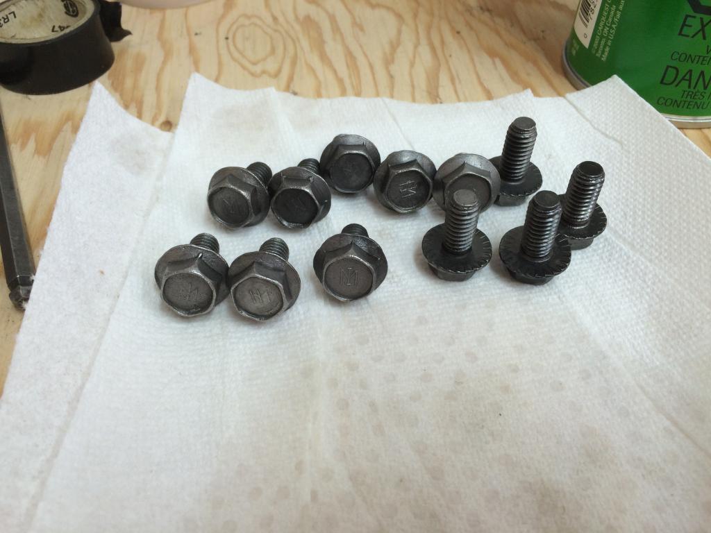

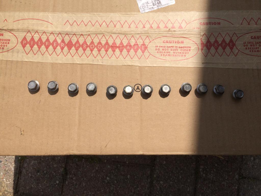

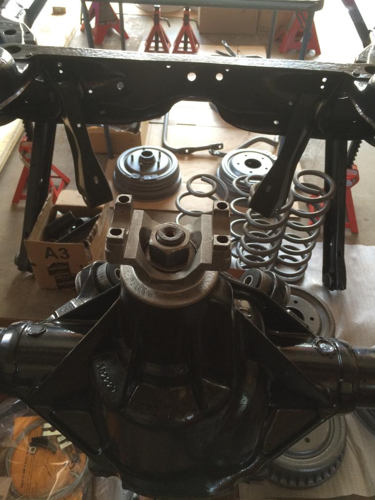

More pictures:-)
i even restored to cover bolts, they have nice markings:-)
Ryan
