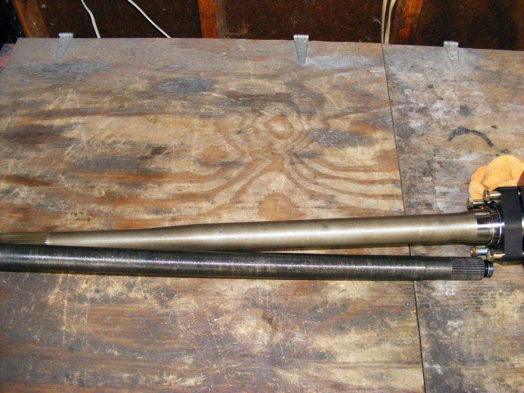

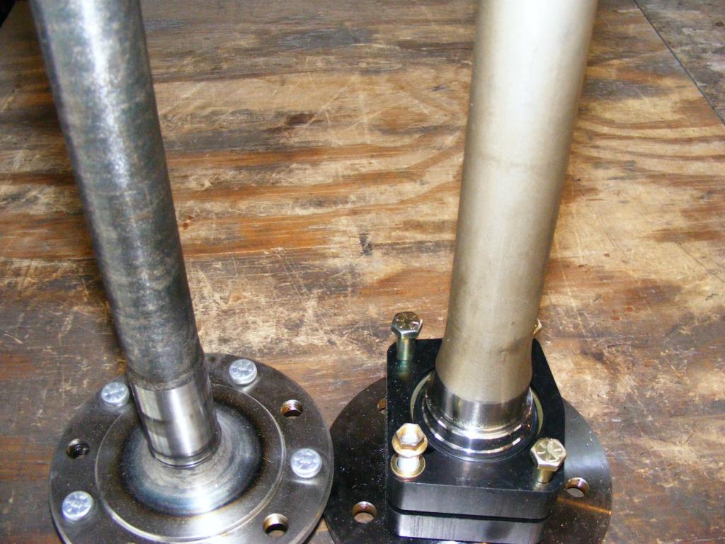

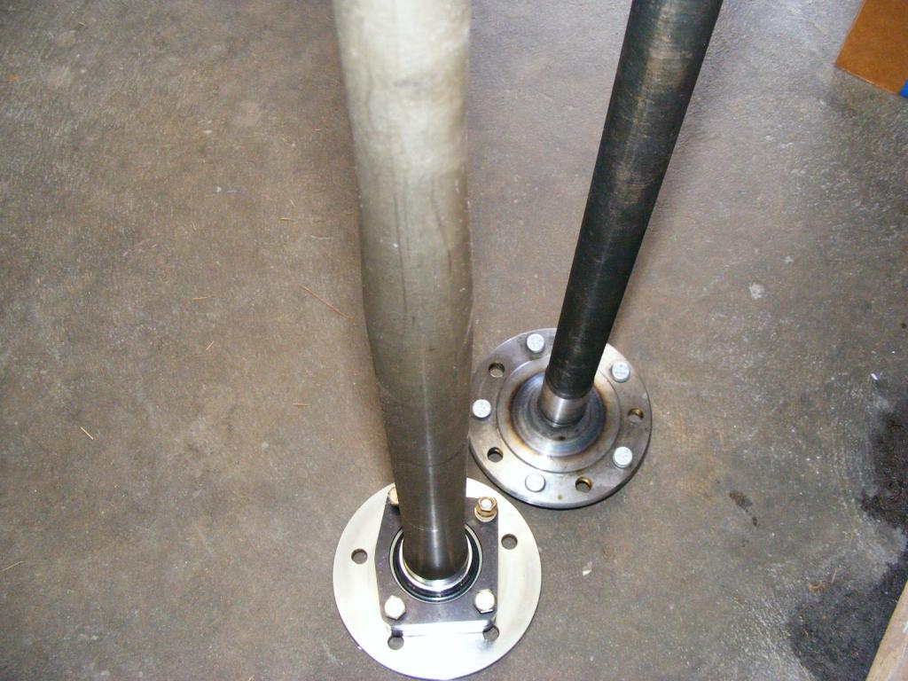

Below is a side-by-side comparison of the Strange axle next to the Yukon replacement axle:
As you can see, the difference is huge, save for the very end where the splines are. It is possible to machine an OEM posi case for larger 33 spline axles and swap the spider gears out for the larger shafts, but again, I'm not going to put any more $ into this 12 bolt than I have to for now since it's not going to be under the car for much longer.

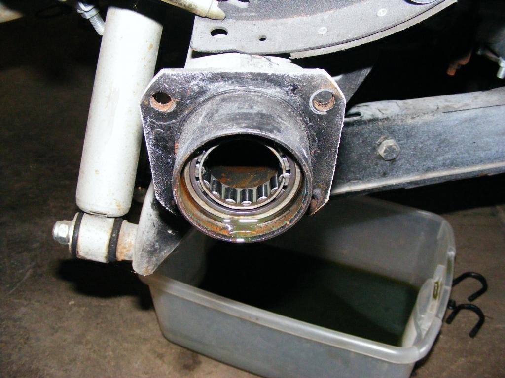

After the axle seal has been removed, the OE axle bearings have to be removed. Typically a slide hammer is used to remove these, but since I don't have one and wasn't going to buy one just for this job, I made do with a home-made puller using a long piece of allthread, a few nuts and some large washers. Worked like a charm.

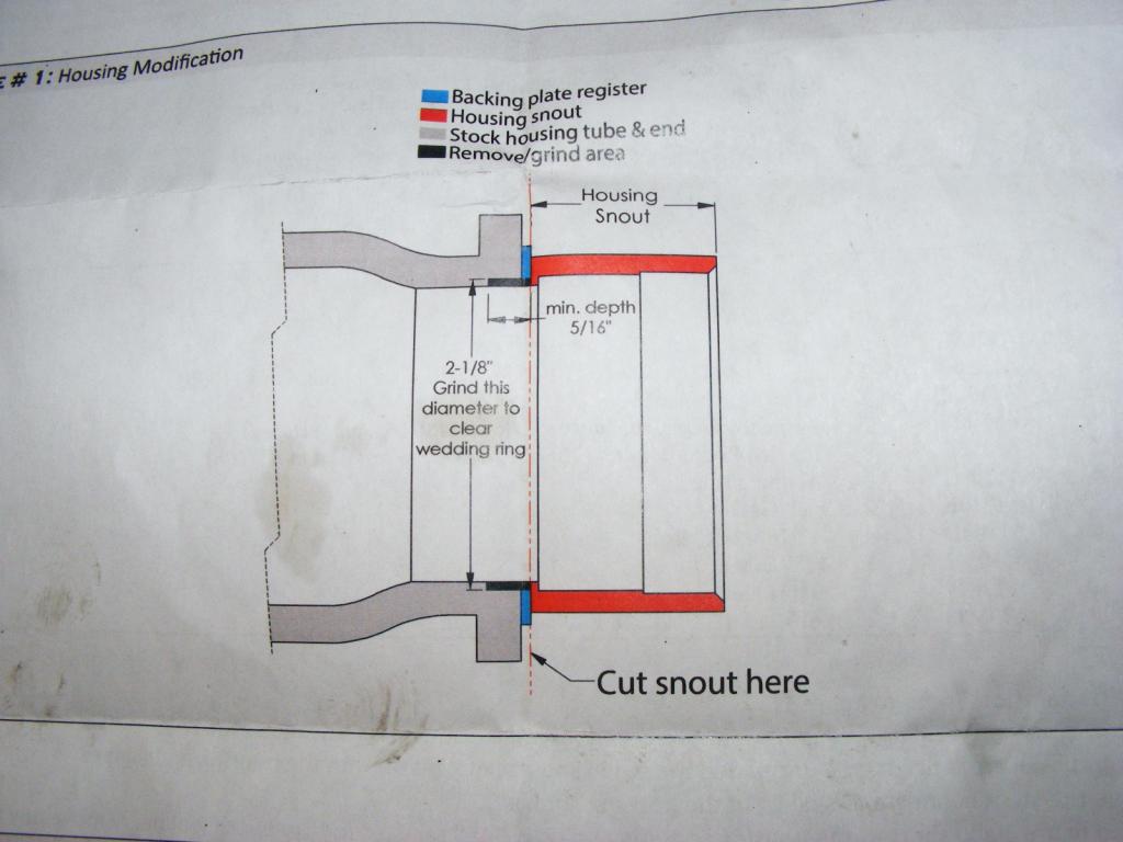

Once the bearing is out, the end of the axle tube is trimmed off. In this instance, Strange calls for no more than .0625" (1/16&quot total height from the flange to the register for the backing plate.
Here's where it got a bit complicated;

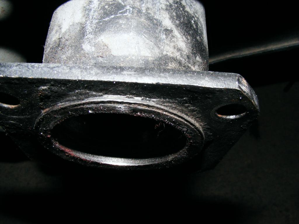

Since these axles use such a huge outer bearing, you have to machine the inside diameter of the end of the axle tube out to 2.125" to ensure clearance for the "wedding ring", which is the small pressed-on sleeve that helps retain the axle bearing. The area to be removed is highlighted in black in the pic below:
Problem is, how in the hell do you machine it? [img]<<GRAEMLIN_URL>>/hmmm.gif[/img]
I spent over an hour trying to use a stone grinder on the passenger side tube, and only managed to get it out to just over 2.100. By that time my hands were stinging from the vibration of the grinder, so I threw in the towel on that approach and came up with a better plan.

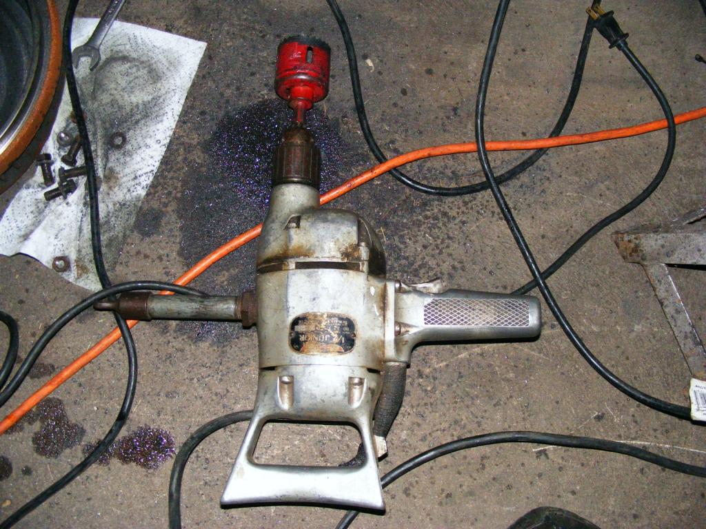

I went to my tool box, rummaged through the drill accessory drawer, and sure as God made little green apples, it just so happened that I had a 2 1/8&quot; hole saw! [img]<<GRAEMLIN_URL>>/biggthumpup.gif[/img]
As luck would have it, it <span style="font-style: italic">just</span> centered into the remaining register on the axle tube, so I fired up my trusty cordless drill, aaaaaaaannnnnd proceeded to get absofriggenlutely nowhere. [img]<<GRAEMLIN_URL>>/rolleyes.gif[/img]
Turns out if I was gonn'a use this hole saw to do the job, I was gonn'a need something with substantially more &quot;oomph&quot; than my 18v cordless drill.
Luckily, I had that base covered too.
Meet &quot;the arm breaker&quot; [img]<<GRAEMLIN_URL>>/grin.gif[/img] :
This was handed down to me courtesy of my great grandfather. This thing has saved my butt on numerous occasions, but as the name implies, it ain't to be trifled with. I learned early on to be <span style="font-style: italic">very</span> cautious using this thing, `cause if it grabs something, it's likely gonn'a break the drill apparatus you're using, or you're gonn'a pirouette like an ice skater whether you want to or not.
I loaded up the hole saw in the arm breaker, and <span style="font-style: italic"><span style="text-decoration: underline">cautiously</span></span> I started to grind away at the tubes. Took less than 5 minutes for each tube. [img]<<GRAEMLIN_URL>>/biggthumpup.gif[/img]
It ain't pretty, but it clears!
So now everything's machined and ready to be put back together. I have to clean the axle tubes out, but that's all that's left to do.

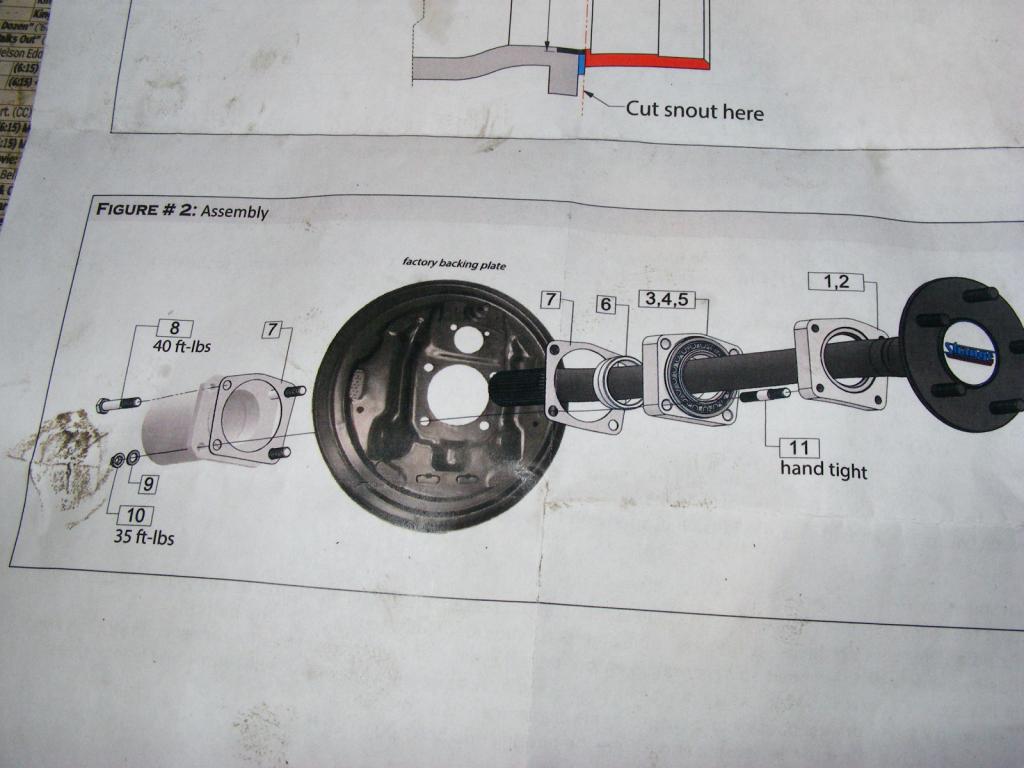

Below is the installation diagram should anyone be interested:
With any luck I'll have everything buttoned back up tomorrow.
