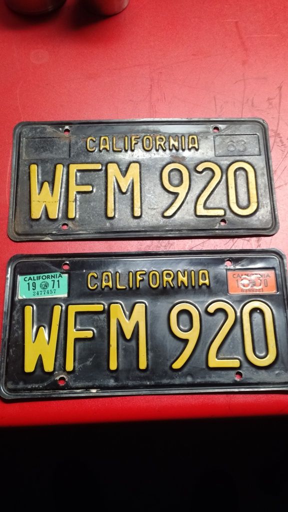

I've got the original plates for the car now!

Very cool plates!!!!
The editor of Hemmings told me you can Liscence those vintage California plates:-) He is a real plate lover:-)
