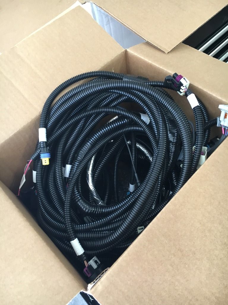

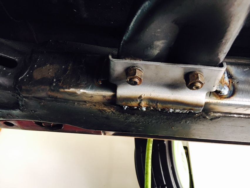

Getting closer........But........I found more "Dirt" !!!........Sheesh.......Does it ever end...In these "B" body LS swap's......the rear trans cross member needs to get moved back 2 1/4".....so.....I cut the frame mounts out and will re-weld them in position as required upon install..........Got the engine mounts installed and also the engine and transmission harnesses........Next......Get the drivetrain in the Car......Here are some Pic's

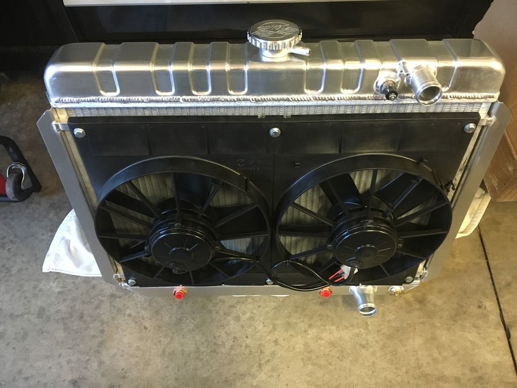

The Radiator showed up also

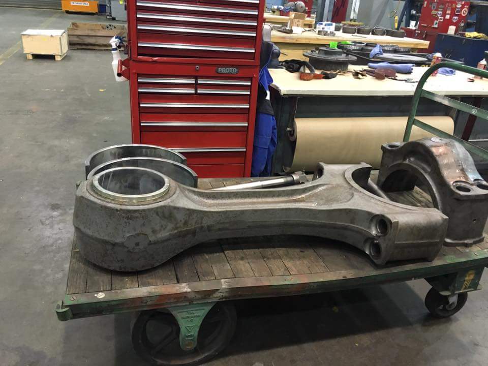

That's the smallest tool box I've ever seen. [img]<<GRAEMLIN_URL>>/naughty.gif[/img]

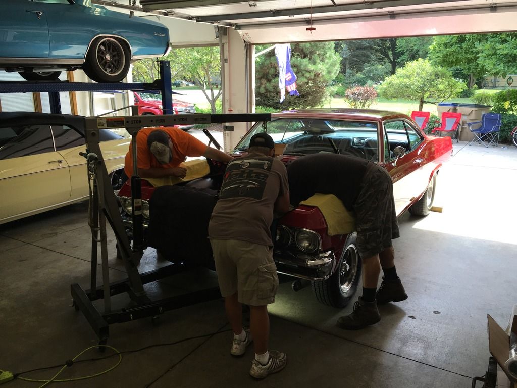

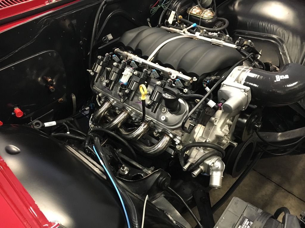

Moved a couple steps forward today........Got the trans cross member frame mounts cut off the frame and the frame cleaned up and ready for welding them in their new position.....and Dave and Gary stopped over to help get the engine in the car.........Got it in and installed the trans cross member , then got everything in position and Brent was there to weld the frame mounts in their new position......started to separate out all the wires and got the Headers installed........Moving along..........

You could of at least loaned him the yellow Impala while you have his apart....... [img]<<GRAEMLIN_URL>>/haha.gif[/img]

The LS Garage and Crew [img]<<GRAEMLIN_URL>>/youguysrock.gif[/img]
