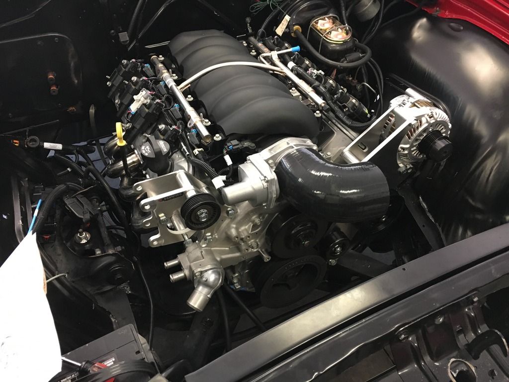

The new Alternator showed up today.....so...I decided to get the accessory drive system installed today....Got the Alternator side finished.....started on the Compressor side and realized we didn't order the belt tensioner........Ordered one (Be here Monday).........so.....I decided to get the A/C condenser and Radiator installed.......Moving right along

Ken, what front drive system your using, and where did you get it ? Thanks,Roger

Kwik Performance system..........
www.kwikperf.com
Ken

Had a little spare time today.........Got the Starter in........got the Fuel line installed up to the fuel filter on the firewall (one fitting short of finishing of course).......and believe it or not .....the Tensioner assy for the belt drive I ordered from Amazon was delivered today (Sunday).......So...I put it on and installed the compressor.....Just need to get the proper belt.......A little bit every day

I was going to take a Break for a day and get other stuff done today........Walked into the garage and as I looked at the firewall........(LOL.....can't leave stuff alone ya' Know).......I was unhappy with one of the screws that was holding the A/C firewall plate in position.......Darn !!!........Went in the house and that dam screw was haunting me.......went back out and removed the inner fender panel again and got it fixed correctly..........and I also got all the A/C lines fit and made ........get them crimped tomorrow......
