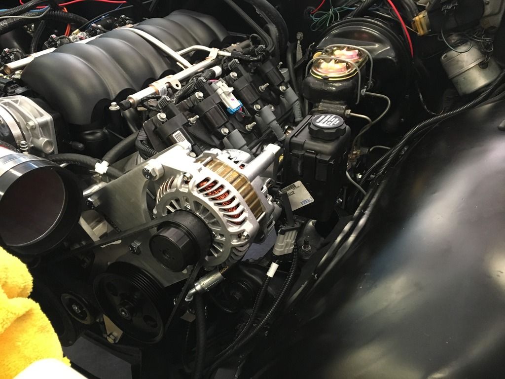

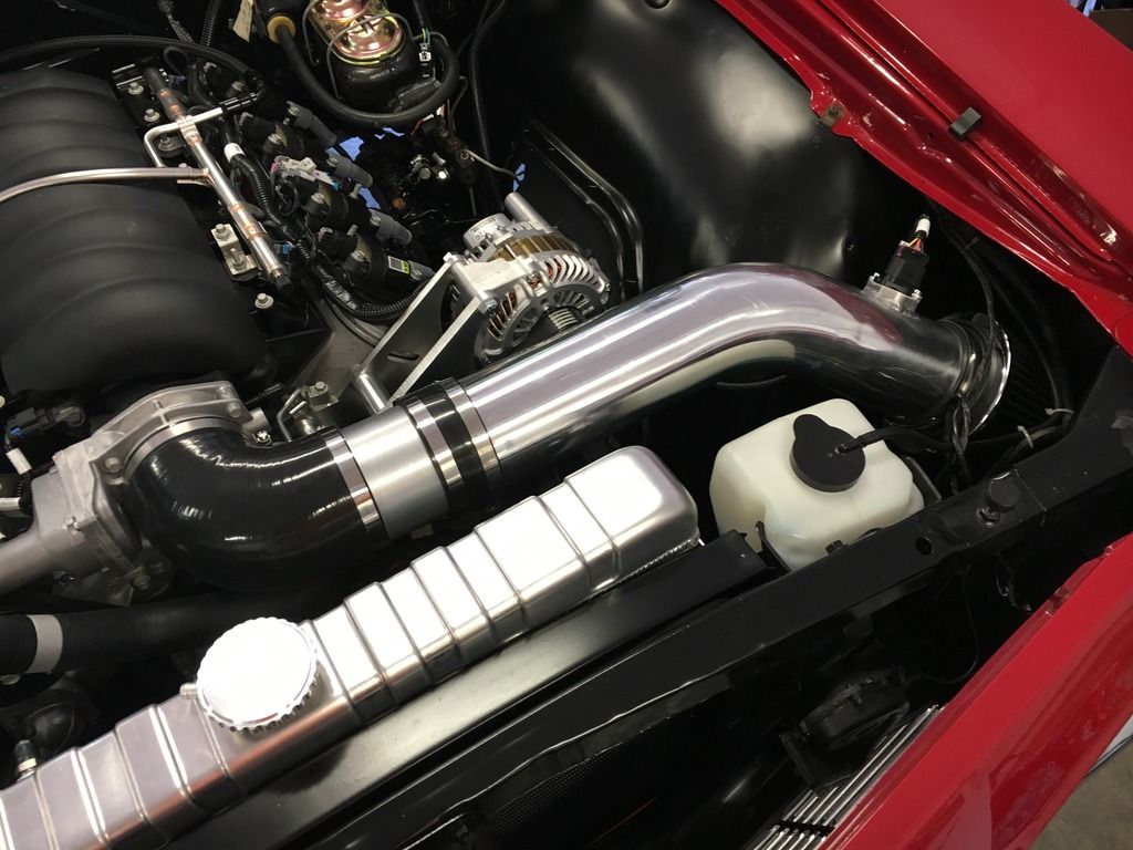

O.k.........Update......Got the fuel line completed......new spark plug wires to clear the headers.....upper and lower Radiator hoses pieced together and installed.....and the air inlet system is completed and installed.......Steam line and heater hoses will be completed today........PCV system and Power Steering hose are about all that's left to do in the engine compartment other than wiring.....Here are some pic's

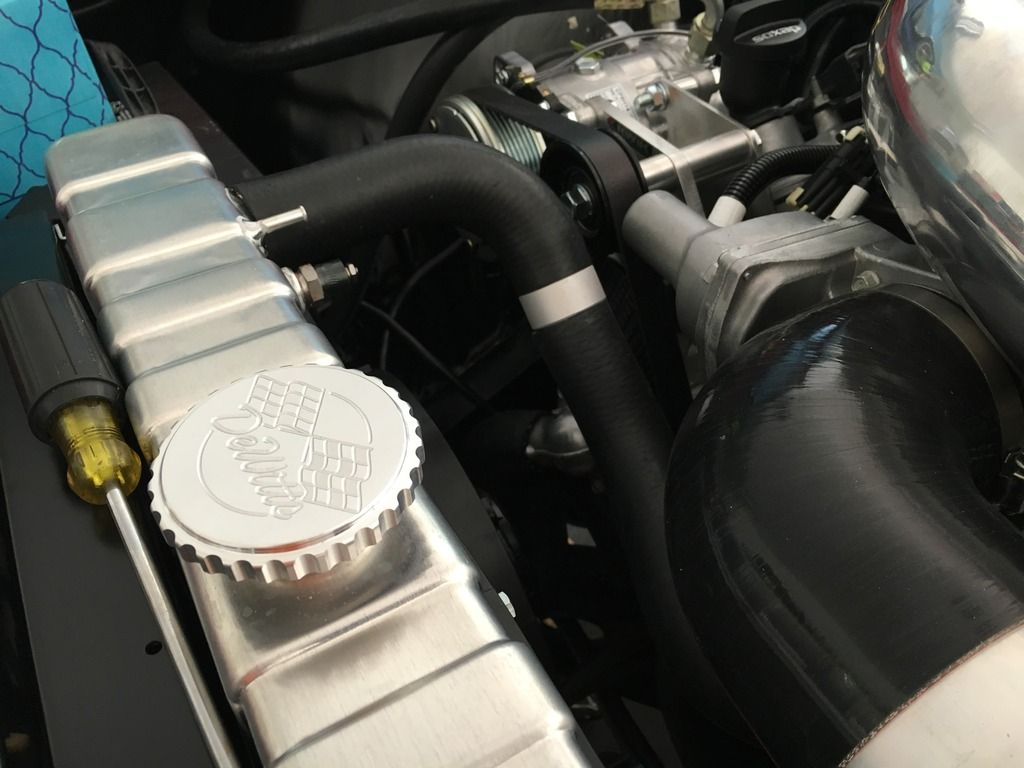

Got all the heater hoses hooked up along with the steam port line.......Filled the system with coolant....no Leaks........started filling the trans with fluid also.....Monday I'll deal with the power steering lines and reservoir.......Then Wiring........Getting closer....We might be able to save this "Beater".......now that we knocked all the dirt off of it !!!!!......Just say'in !!!

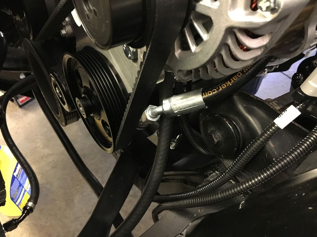

So........We did a lot of driving back and fort to the hydraulic hose shop......first to find the correct fittings.....(11/16-18 flared at the box and 16MM &quot;O&quot; ring on the pump) then fit the line and then Crimped....Got the pressure side installed then installed the reservoir and return lines.....added fluid and again......no leaks.....

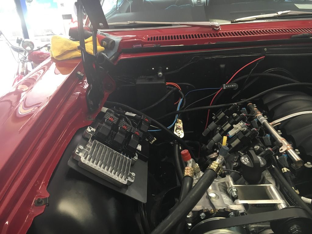

Then I made a mount for the GM fuse panel and got it mounted...........then installed the modules.......the mess of wires is starting to disappear.....
