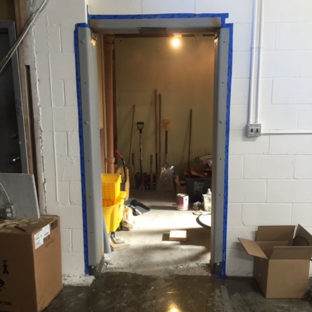

Through May and June we concentrated on some of the smaller stuff like getting the back wall insulated. We had to leave it in this state for a while as we waited for the electricians to install light boxes and power outlets.
The building initially had three washrooms, we wanted to consolidate down to one and create a &quot;wet room&quot; for parts washer, stainless sinks, storage cabinets and floor drain. We needed to open a 24&quot; opening to 40&quot;.
A jack post was installed before demo as this was a load bearing wall.
with our vertical cut made it took about 5 swings and a mulligan to bring down the brick.

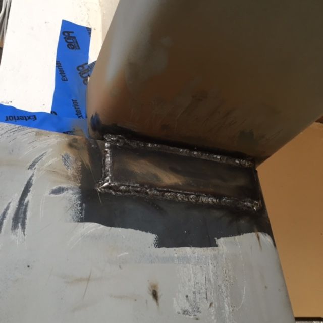

We ordered up 1/4 inch C beam channel from a local machine shop cut and drilled to measure.
We welded tabs at the top and bottom for strength and ran anchor bolts both sides front and back.

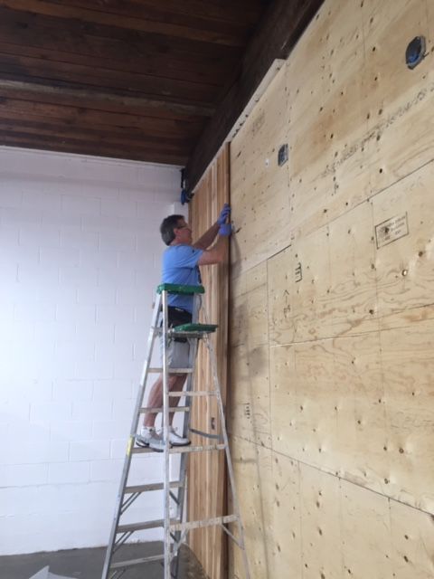

The high bay wall required planks 12 feet long, again routed for an overlap and 6 cutouts had to ne made for electrical boxes.
Mr C climbing the corporate ladder for plank fitment. Notice the use of all the latest safety gear.
With 5 planks left to go it seemed a good idea to sign off on the wall build. It was known as the 8 ply wall, studs,3/4 outside sheeting, Tyvek, cladding, insulation, vapor barrier, 3/8 sheeting and cedar plank. WE signed off with moniker we had earned for the construction.
