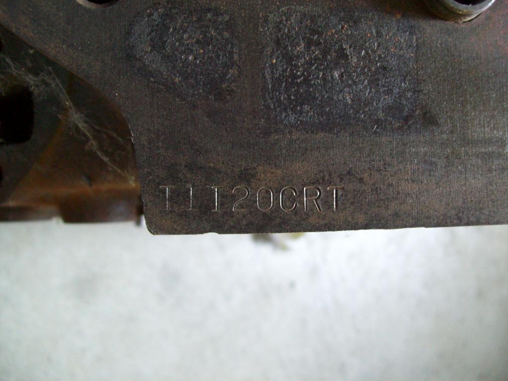

Here is a pad stamp from a 1970 LS5 Chevelle. No one sees a problem here?

i know you think the C is wrong on the Nova stamp i appreciate the help, i do....and i do see what you are saying.

Your C does look more open than others I've seen.
Dale has some nice photographed examples too. http://chevellestuff.net/1970/engines/index.htm

Troy says the C should have a straight back and not the curve like this one..as i look around, i see both styles some are called right out re=stamps some are accepted as real????hows a guy to know..
.too bad theres no known/confirmed willow run stamp pics avail to do a side by side..even 325 horse stuff just to compare..the C doesnt bother me too much..its the W..and a friends statement this morning kinda shook me a little...he's seen more BBC stamps than anyone here could ever..he liked it except he said "boy the stamp sure looks fresh"
i see the small block "C" and CE share the same font thats on this block..throws a few questions up....
i am not smart enough to tell..but i did find a willow run 396 and it has the same C as the one i am looking at..close to this on production number too..just a few thousand cars away..

CKP stamp is not an original stamp in my opinion. Sorry.

The broach lines just don't look parallel on the CKP stamp. Look at the broach lines at the top left of the "P" and top right of the "P" and the lower left of the "O" and lower center of the "O", they are way off of parallel.

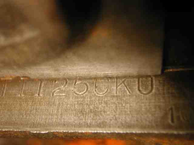

It took awhile to find this photo...note the 'C' in CKO. This is from our 22k mile 70 survivor...you can decide.

FWIW, I wouldn't pay a premium for that short block based on that deck stamp. If I were inspecting it for a customer based on issues that I see that others have pointed out I would tell them it's not in my opinion an authentic stamping. Since this motor is already mostly apart I would perform a deck height measurement. That will most likely put this debate to bed.

def a different C...thanks Wilma..appreciate it
