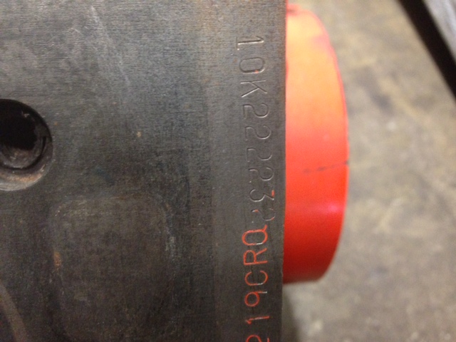

Here is another pad stamp from a documented, original 1970 LS5 Chevelle.
Bill

Nice suttle looking broach marks, with the patina. [img]<<GRAEMLIN_URL>>/biggthumpup.gif[/img]
Mike

No question in my mind, that's a restamp.
Those aren't broach marks, but sanding marks.
I have quite a few 70 WR VIN stamps, including several in this VIN range - it matches none.
Kurt S - CRG

yes, i understand it now...i appreciate you weighing in...
Mark

<div class="ubbcode-block"><div class="ubbcode-header">Originally Posted By: Kurt S</div><div class="ubbcode-body">No question in my mind, that's a restamp.
I have quite a few 70 WR VIN stamps, including several in this VIN range - it matches none. </div></div>
