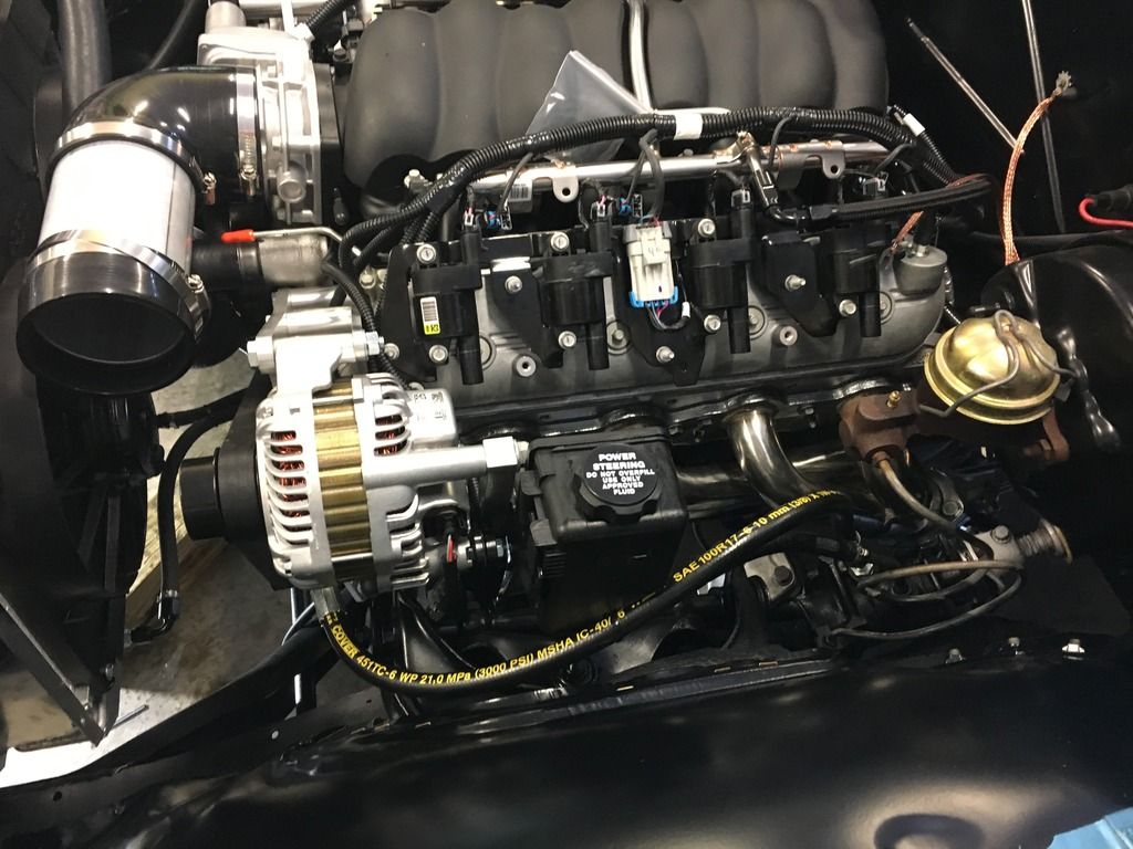

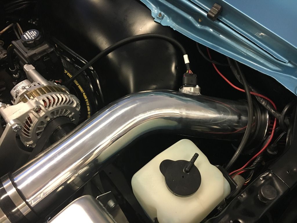

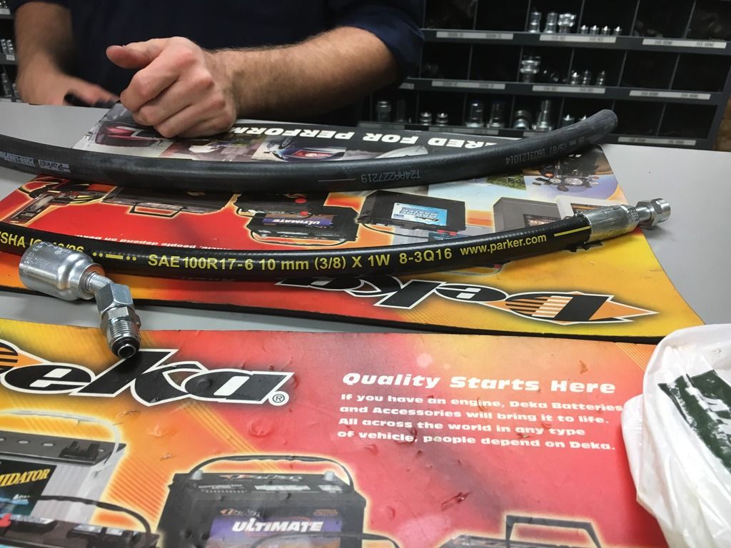

Upadate.........Got Lucky and found a upper Radiator hose that fit perfectly......Got the Air Intake set-up completed with fittings for the PCV system and MAF sensor.........and Got the power steering hose made and installed, along with the reservoir.......started on getting the fan relay's wired and installed......Moving along..........

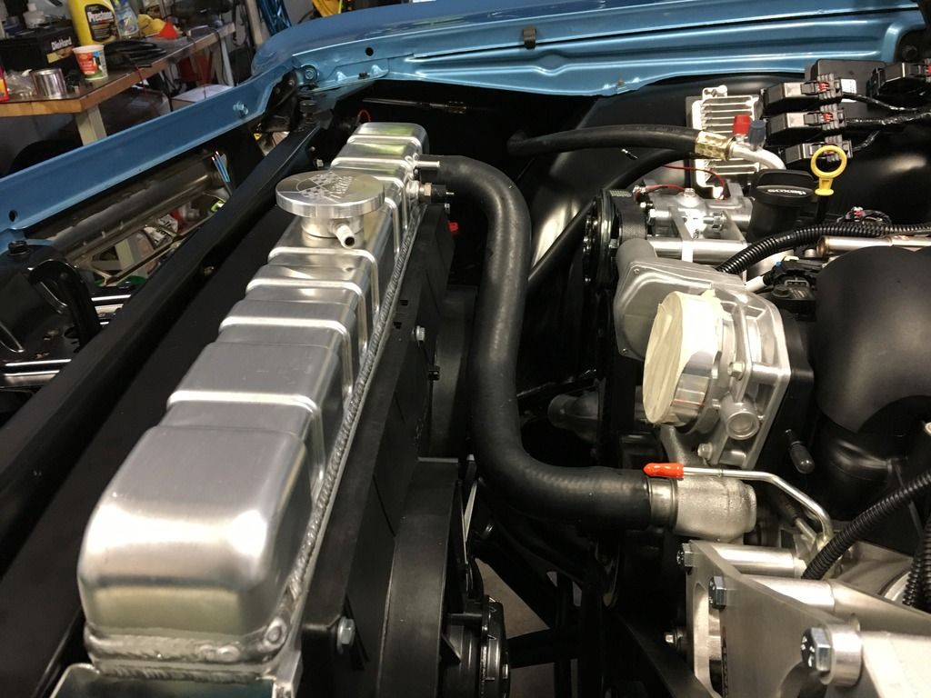

Great looking car and love the swap threads. Im sure you know this but in the past when doing LS swaps I would back fill the engine through the upper rad hose to help with getting the t-stat to open and allow circulation due to air being trapped in the system. Had it happen more than once with an engine going over 220 and it not opening and it would work every time.

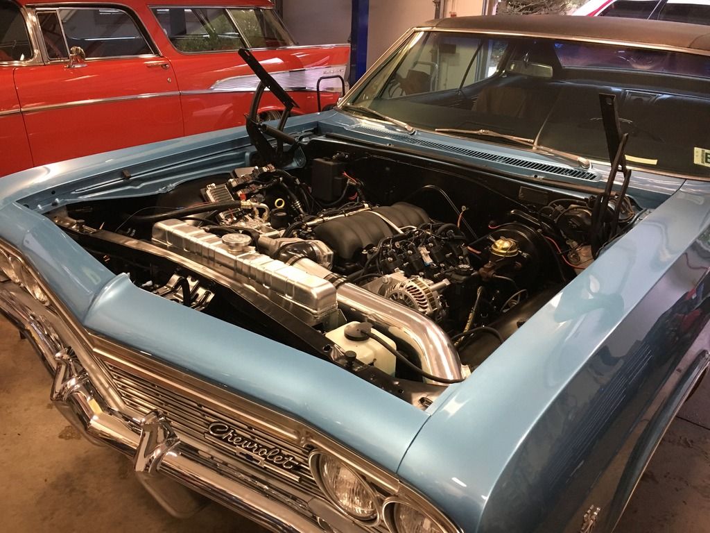

Got the radiator hoses completed......got the steam port line in......Filled the system with coolant....... (No leaks.....That's a good thing)....LOL......got the PCV system installed.....Got the wiring roughed in for the Fan Relays.....(Thanks Donnie)...The car is being flat bedded to the exhaust shop for the system to be installed tomorrow........The Dakota Digital Cluster and modules will be arriving tomorrow also........After the exhaust, I need to spend about a hour finishing the wiring under the hood and about a day getting the Dakota stuff installed..........Getting real close...
