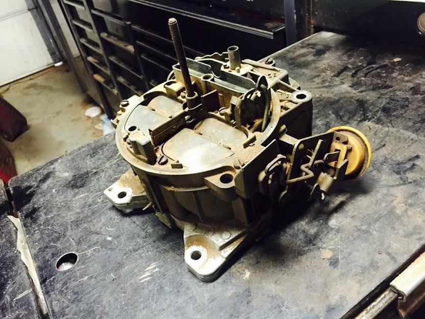

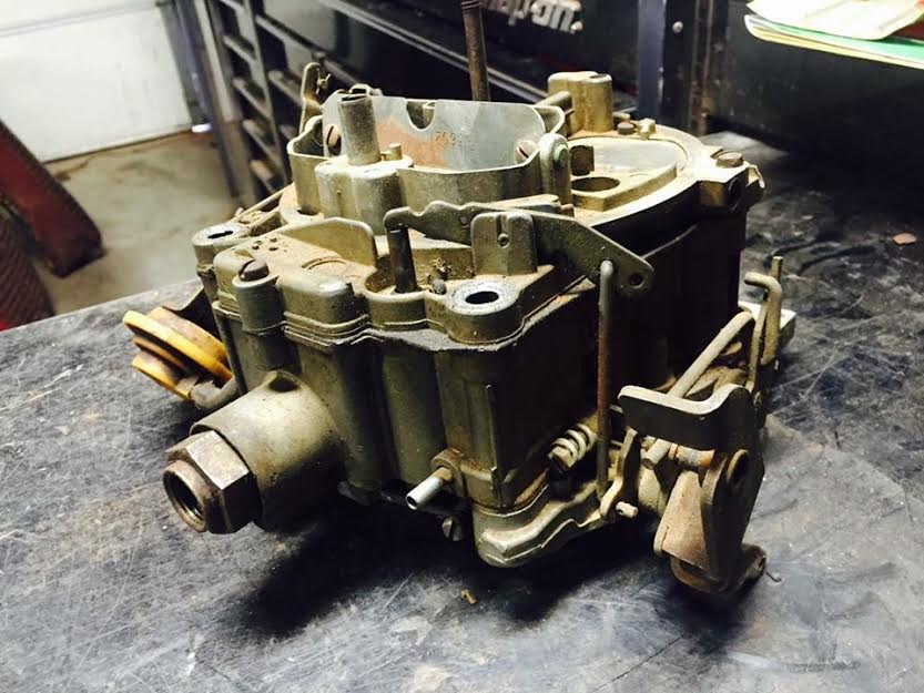

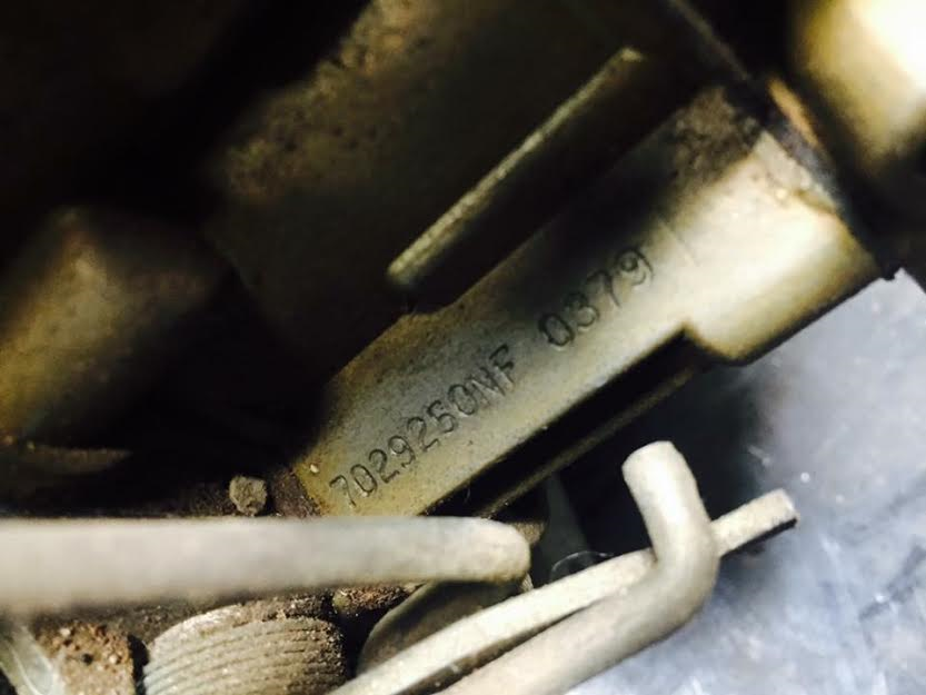

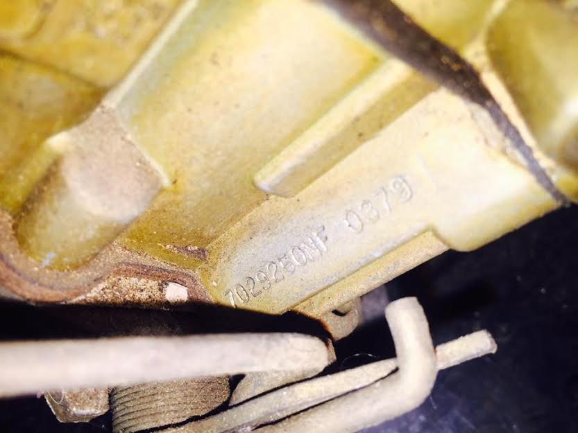

I even got a 7029250 1969 350 Carb (Non W31 7029255) to use for the PSMCDR engine.

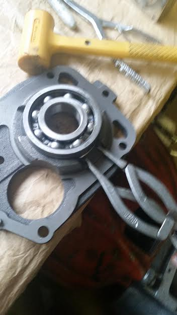

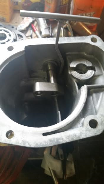

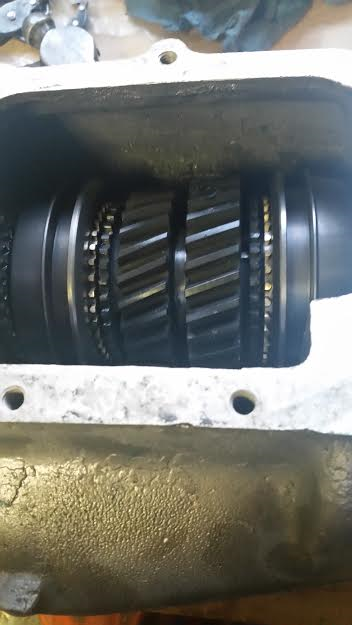

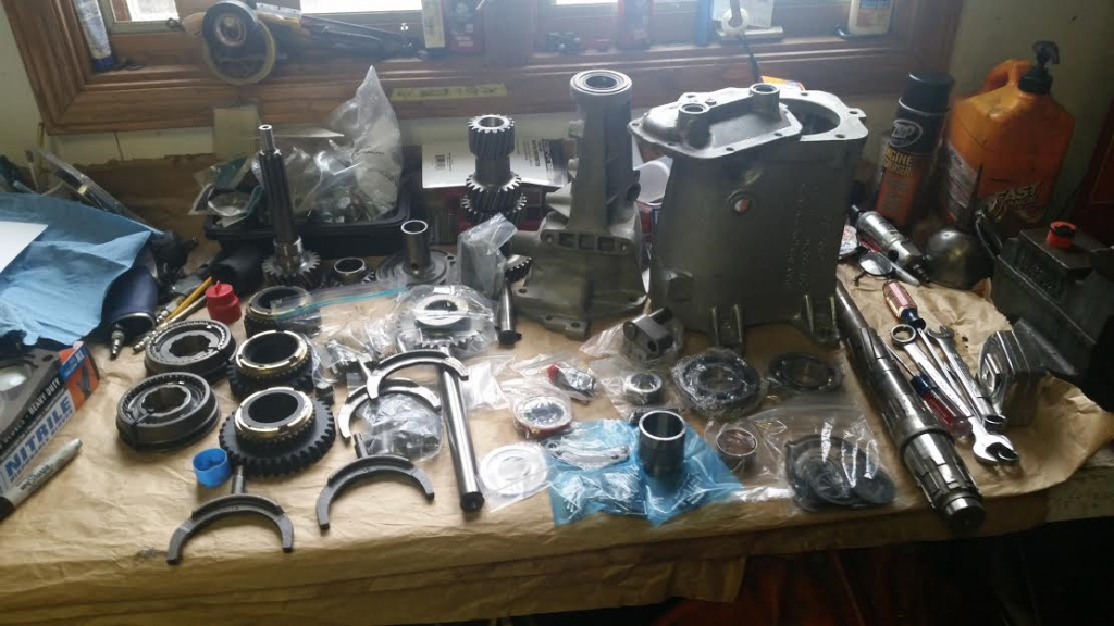

Nick Morocco sent the assembly pictures of the M22Z:-)
Those are some strong gears:-)

The M20 (2.56 first gear) that was in the back seat of the car when I got it is all rebuilt. This trans may be used for street, TBD.
The M22 (2.20 first gear) that was in the car when I got it is rebuild. This trans will probably sit on the bench.
The M22Z (3) that Nick just finished is a new gear set with an extra wide ratio. 2.98 first, 2.04 second, 1.47 third, 1 to 1 fourth. This trans is optimized for a reasonable set of highway gears like my 3.42's. This trans will most likely be used for PSMCDR and street duty.
