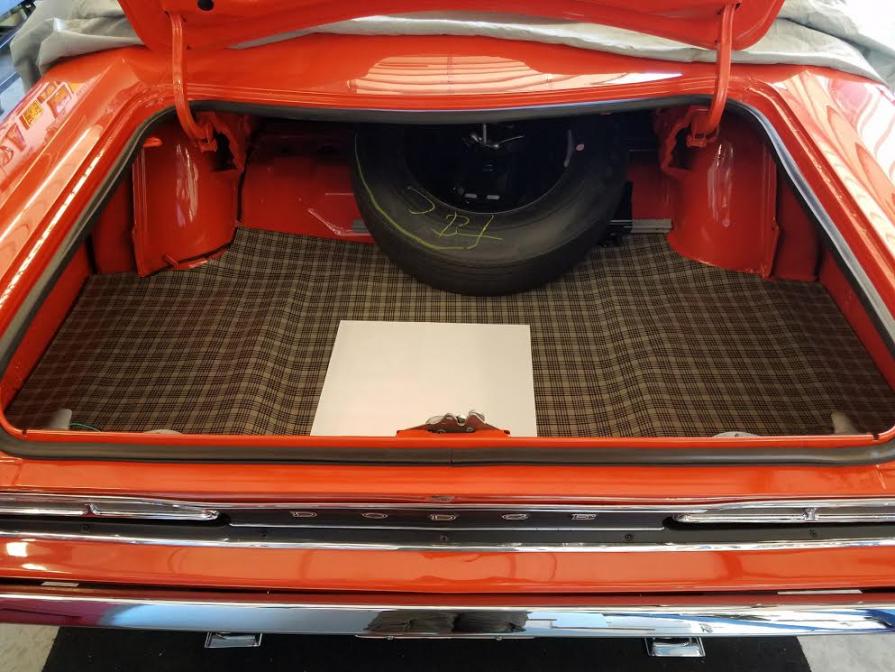

Did a few small detail items which was paint the grease on the trunk hinges.
Ya know....I find it amazing I'm replicating slop.....
Last shot is the trunk done with delivery floor mats (upside down, of course to protect them for right now!) waiting to be laid out on the interior floor.
