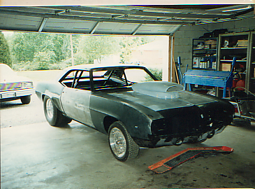

The first picture is what it looked like when I got it in Feb '84 when I was 18. I traded a pretty nice '67 SS396 Chevelle for the Camaro. The Chevelle had a Powerglide and the Camaro was a 4 speed. I don't like automatic transmissions, so I traded because of the transmission. The car had Z28 badges on it and a 350 from a truck. It took me a while to figure out that it was actually a SS396 car.
This was an original X22 RS SS396 4 speed car. It was huger orange with black top and black hockey stick stripes. The interior was black deluxe with the full gauge package. It was probably a 325HP 396, but the engine was long gone. The transmission was the M20. The rear end was a 3.73 12 bolt with the Eaton Posi.
The second picture is the beginning of the build that took 18 years before I got to drive the car again. I was probably 19 years old at this time, was working as a mechanic at Lester Ford, and was still living with my parents.

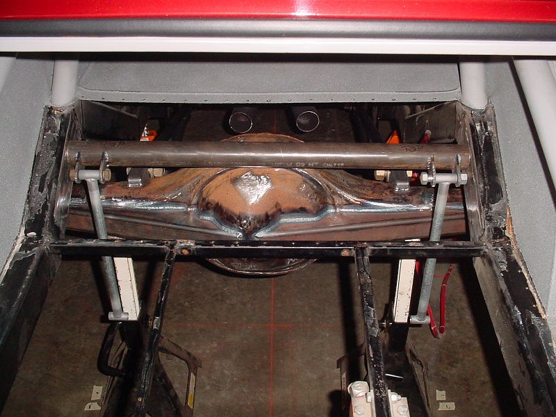

The next picture is the frame that I built at the age of 19. I had quit my job and was going to vocational school to be a welder. Most of the frame was built at school. This was the very first of many rear ends that I narrowed.
The car sat for many years due to a serious lack of money. After getting married, getting a real job as a DOD aircraft certified TIG welder at GE Aircraft Engines and buying a house and building a garage I was able to start on the car again. The reason that I decided to go Pro Street was because the car was full of rust and some after market parts were not yet available to fix it. This last picture shows the entire back end of the car removed.

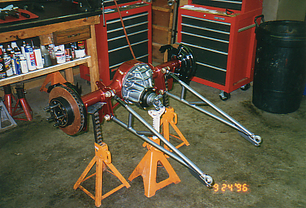

This was the first rear end under the car. The housing is from a '64 Galaxy, the nodular case, Daytona pinion housing and Detroit Locker are from a '69 Mach 1, the axles are from a '65 Galaxy, the 4.11 gears are from a F150 and the disc brakes are from a Lincoln Mark 5. I had to use what I could find due to lack of money. Some of you might notice that I had the ladder bars upside down. I was still learning.

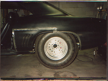

Things starting to come together. This is how I cut the new NOS GM quarters to fit the larger tires. In the late '80s these were still available and cost around $230 each.

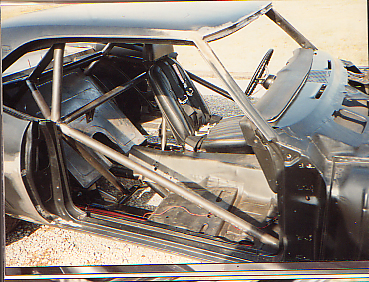

Roll bars and floor coming together. This was the first time that the car had rolled out of the garage on 4 wheels in many years.

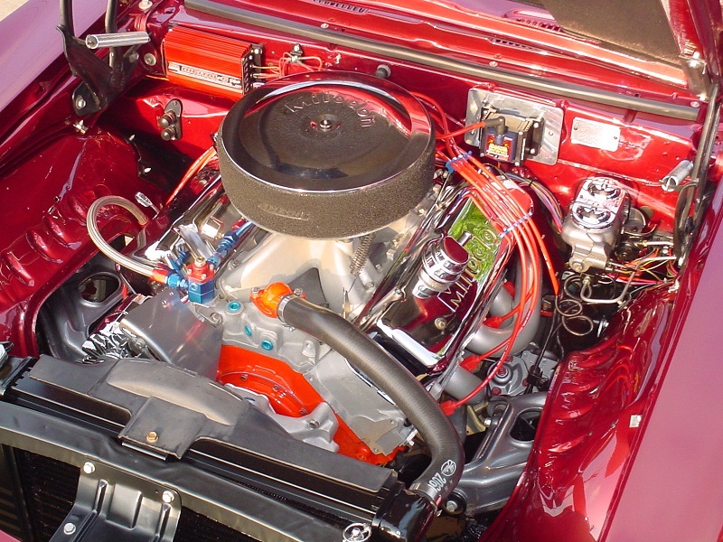

Early picture of the 427 with the Milodon valve covers, high mounted alternator, plug wires laying on the valve covers and the old MSD ignition. This was the 3rd of 4 MSD boxes that have been in the car. At this time it still had the original big block radiator in it.

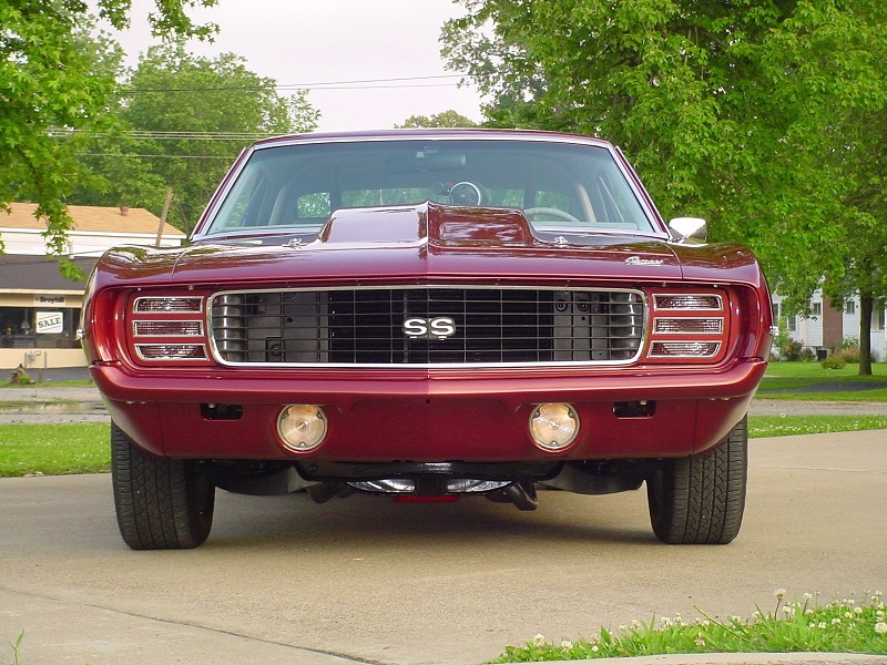

Some pictures of when I first started driving the car again. The Pro Stock Centerlines were some of the first that were made. They have 1986 dates on them. The rear wheels are 15X14 and the fronts are 16X7. This might be the only set of 16 inch Pro Stocks that were made. The Unlimited Fiberglass Products hood took a lot of work to make it look good.

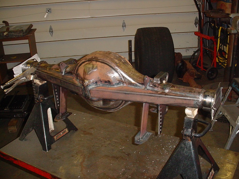

I decided to redo all of the rear suspension several years ago. I got rid of the leaf springs and installed a set of Varishock coil overs. The shocks in the picture are some old Chassis Engineering shocks that turned out to be no good. I made a new set of ladder bars and built a F150 9 inch housing. I made all new brackets and added a brace to the housing. I've got a set of wheelie bars for it, but I haven't put them on.
