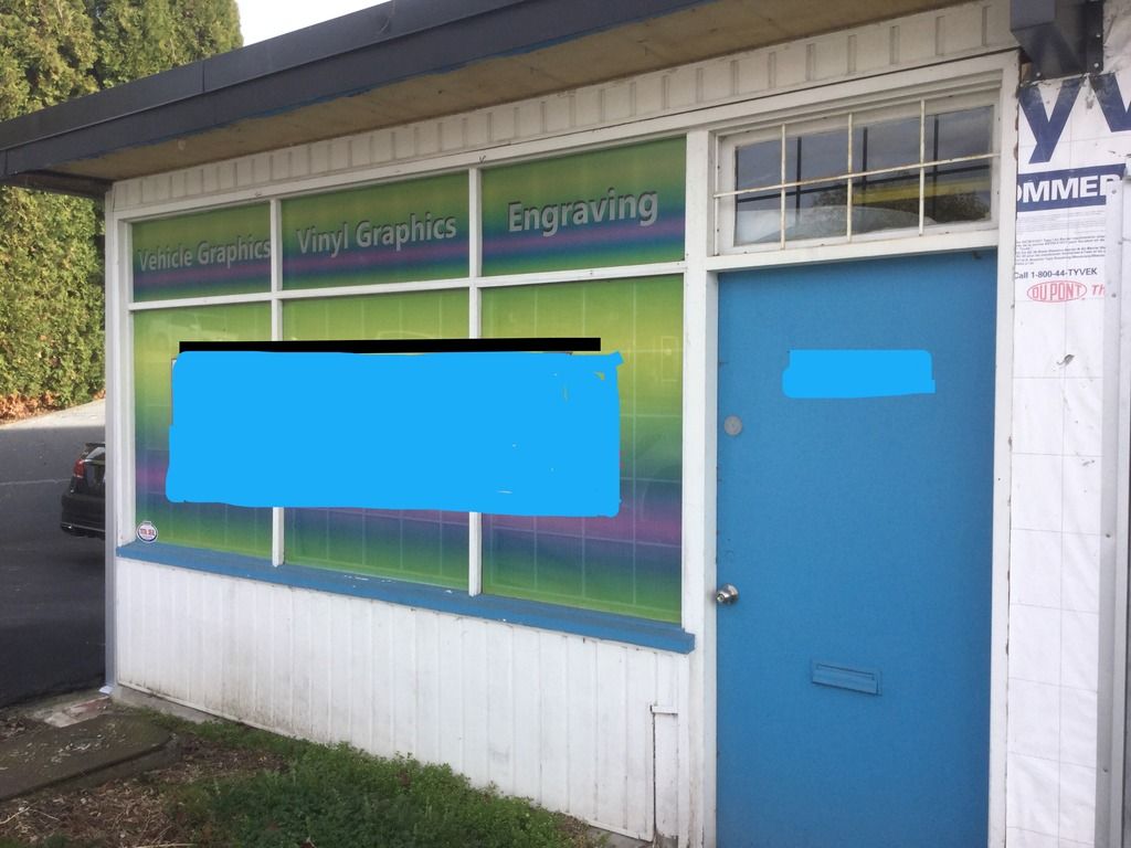

When we started on the building 27 months ago we were dedicating the front room to parts storage. Not long after we started reos we were considering configuration for additional car staorage. The east front room had unrestricted access to the street and the though of converting it into a single car storage, and still room for parts was hatched. It was not a priority two years ago but put on the too do list. This past March we agreed that May would be a good time to get this done.
The plan was to demo the old wall and build a new one with an opening for a car.
Here is what we started with:
Friday May 18th, construct a temporary support wall.
8: AM Saturday May 19,the man door gets opened for the first time in xx years.
The demo begins
Thats Mike J doing the demo, he has been assisting us on many occasions. He is good at demo. Picks stuff apart in small chunks.
By noon we had a cleared opening to start the new construction.
