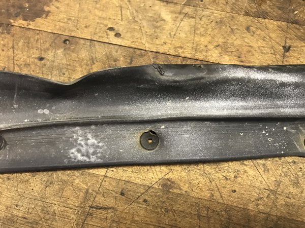

While we had the fender on the passenger side loosened up to remove the antenna it was a good time to fix some cosmetic issues that have badgered us for a while. About 20 years ago Dad had new rust free doors installed (the rest of the car is remarkably rust free). When the shop painted them they got some overspray on the forward jamb pieces. A little light wire wheel and some mineral spirits made short work of the overspray. Since the passenger side now looked much better we decided to do the driver side as well. Now we are just waiting on the rebuilt antenna to return and hopefully we can enjoy this summer.

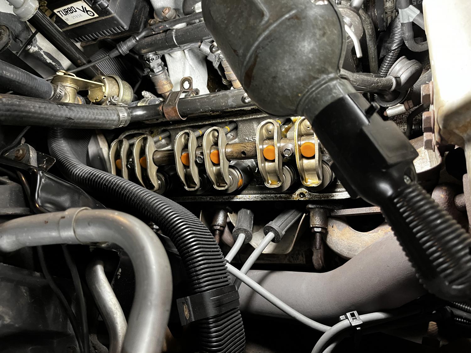

Winter project time here as the snow has started to fall already.....The valve cover gaskets have needed replacement on the Regal for some time now. Tackled the passenger side last night as it was leaking the worst and I assume the most difficult side. I don't think Dad ever had the valve covers off this car in over 130k miles - silver cork gaskets still. Bit of a challenge to get everything disconnected and get the valve cover off with the A/C box so close but after about 90 minutes everything was complete. Amazingly clean inside given the age and miles - a testament to regular oil changes and Mobil 1. I'll tackle the other side soon and get a correct breather installed too.

Nice work. Have you ever sent oil sample to black stone ? I just did recently on one of mine and always appreciate the info..
