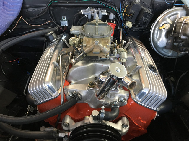

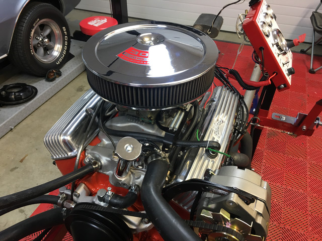

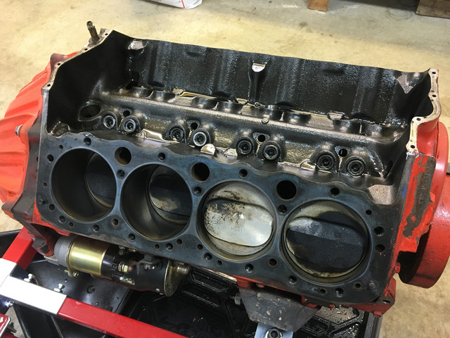

Enter 2018
A little update for the 68. Back in early 2017 I pulled the original motor out of it and put a fresh 360 solid roller motor in it for the summer. Great build that made some great power but a little too radical for long highway cruises. Being that the bulk of my cruising involves highway runs to and from neighboring towns, I've decided to go back to a hydraulic cam to put less load on the valve train.
When I pulled out the old 350 that was in the car for about 30 years, I freshened it with a balanced assembly using a forged 1182 crank, a set of pink rods, and the old TRW 11:1 slugs with new rings and bearings. The old 462 heads were treated to a little port & polish work while screw-in studs and guides were added with Comp Magnum rockers. I used a Crower 00471 Hydraulic Roller for this build and it's still lumpy enough for the folks who like bigger cams but responsive enough to get this little 4 gear cruiser moving along.
I ran the motor in this week and Mike Thorpe came over last night so we could adjust the valve train, tune the carb in a little bit, and do a few checks during its second run. Mike's now rebuilding the 4053DZ carb that used to top this 610 intake and that will be added to the motor once it's installed back into the car. No leaks or issues with this hot little small block, so the next move is to swap it back into the 68. This one should make an honest 425 horsepower while being a bit more forgiving on valve train parts with longer distance cruises.

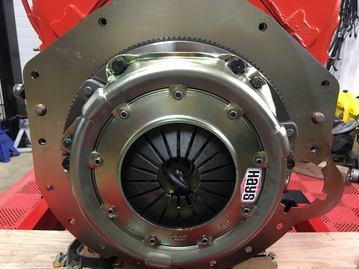

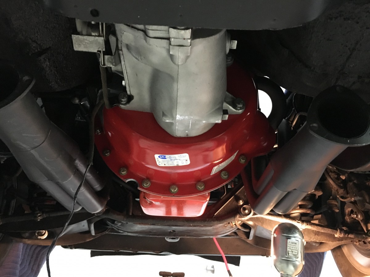

Fathers Day progress.
Installed the freshened 355 motor back into the 68 yesterday along with the rebuilt M22 that came out of it last year. Kept the scatter shield and Hays clutch since both were new last year. I then pulled the vacuum pump out hoping this cam won't need it but that is still to be tested since this new Crower cam is pretty healthy too. I did leave the MSD 6 Digital ignition in it since most of it was hidden and I feel the new motor will benefit from a good ignition system.
My friend Mike rebuilt the DZ carb last week and I had the 610 intake tumbled so everything looks good and clean now. Added the scripted valve covers to help clear the roller rockers and a high flow water Edelbrock pump to keep things cool. Should make a great little driver once again and now it'll be capable of some long distance hauls. Tonight I'll button up the carb, plumb the coolant and it's ready to roll once again.
Now to rest my back for a day or two.
