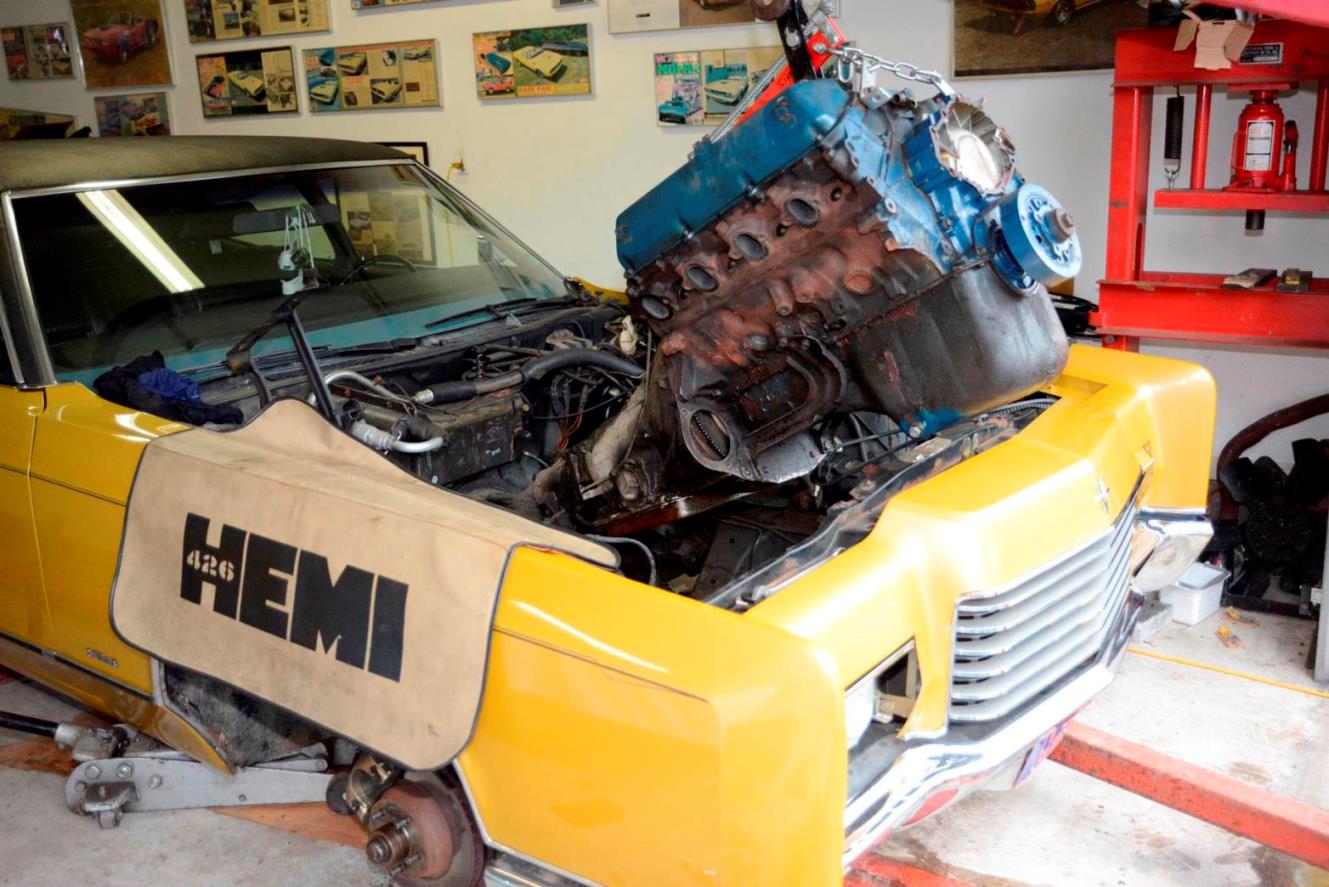

Spent the weekend unbolting everything and removing the engine and transmission. I now realize why the factory manual recommends removing the engine by itself and the transmission later. This has to be the world's longest transmission! The adjustable leveling engine lifting saddle really came in handy as I had to pull it at a diagonal to get it to clear the nose since the entire front end rose about a 10 inches in the air once the weight of the engine was taken off the frame. I then had to pull the front tires and lower the body to the ground on two floor jacks just to get the assembly to clear the nose. Did it all by myself, with the wife and son only assisting during the final maneuvering over the front sheetmetal when someone had to hold up the trans yoke to clear the final hurdle while the hoist was pulled forward.
