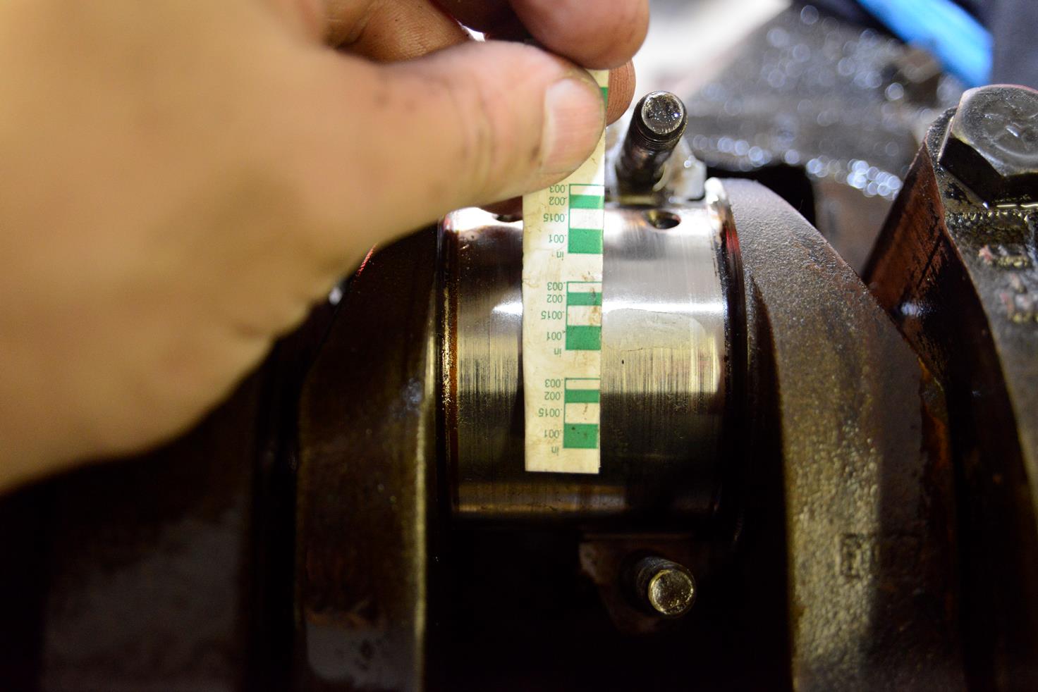

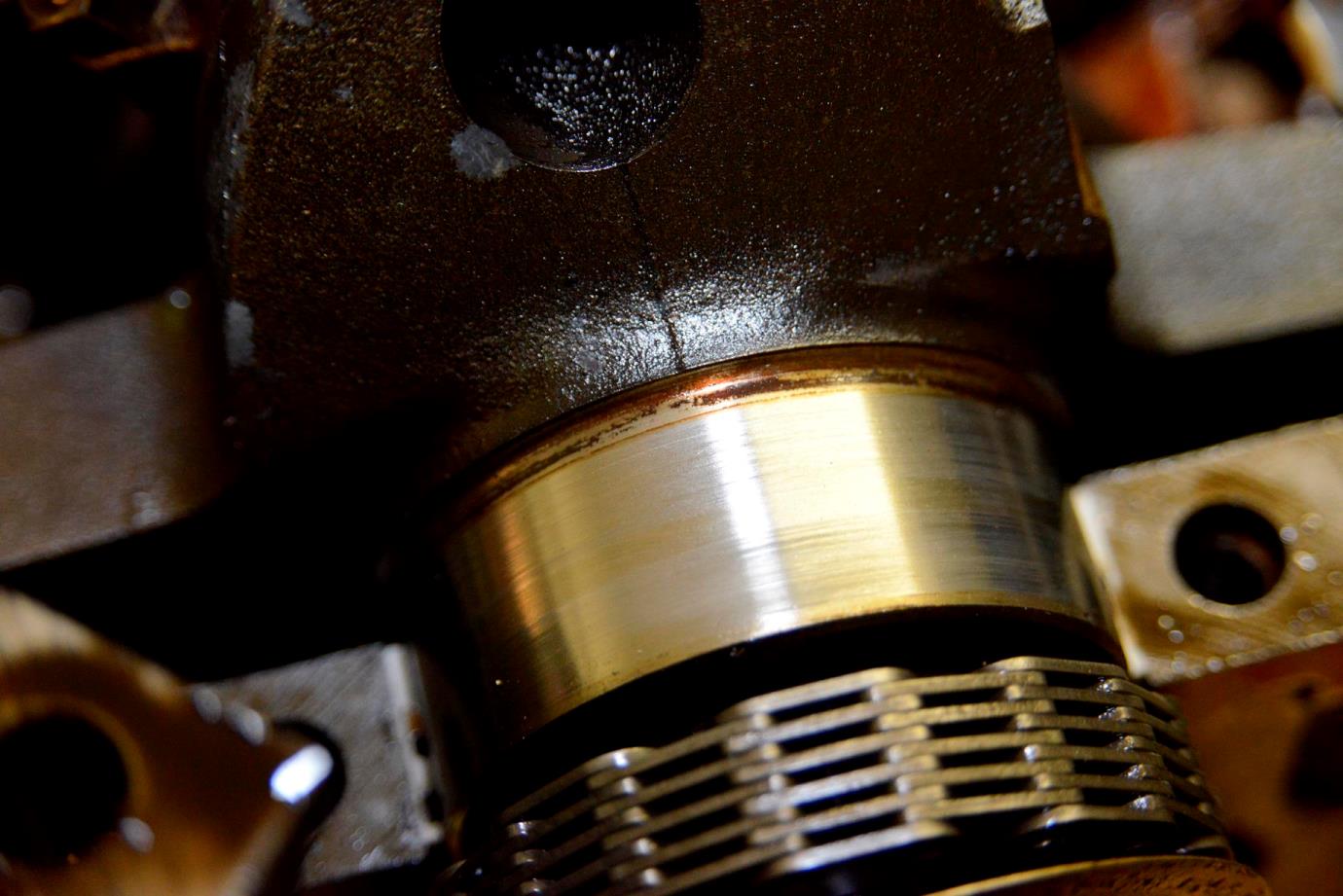

I pulled the first main cap to check the bearings. The crank looked great but the bearing was all copper. The rod bearing I checked looked fine and still had all its material intact. I'll Plastigage each one before I pull it all apart in the coming days. I like to know exactly how things were wearing in case I just go with a polish and re-bearing at STD size.

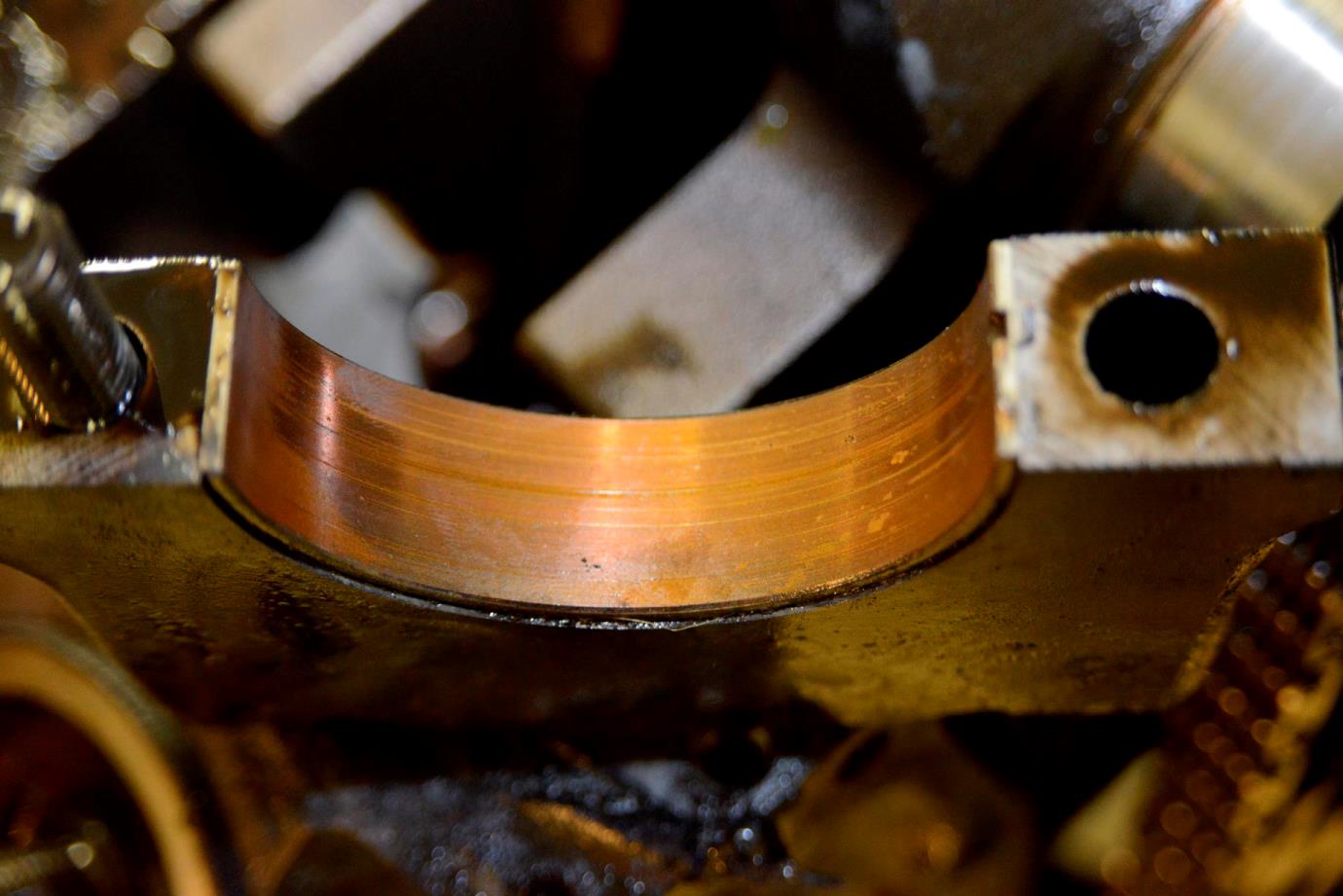

The rod bearings looked decent but you can see the small copper wear pattern on the tops of each rod bearing - most likely from my Dad running the 10-1/5 to 1 compression engine on 87 octane for the random times he was driving it over the past couple decades. OUCH! All the mains were at the copper layer top and bottom. The crank itself looked very nice. I guess the original Ford Clevite bearings did their job and sacrificed themselves instead of the crank journals.
I Plastigaged a couple bearings and the rods looked to be really tight: much tighter than the minimum 001. line on the paper. The mains came in at .002.

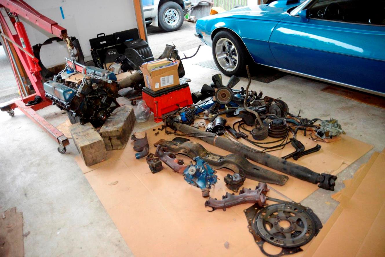

And here's the giant assemblage of parts as of this evening.

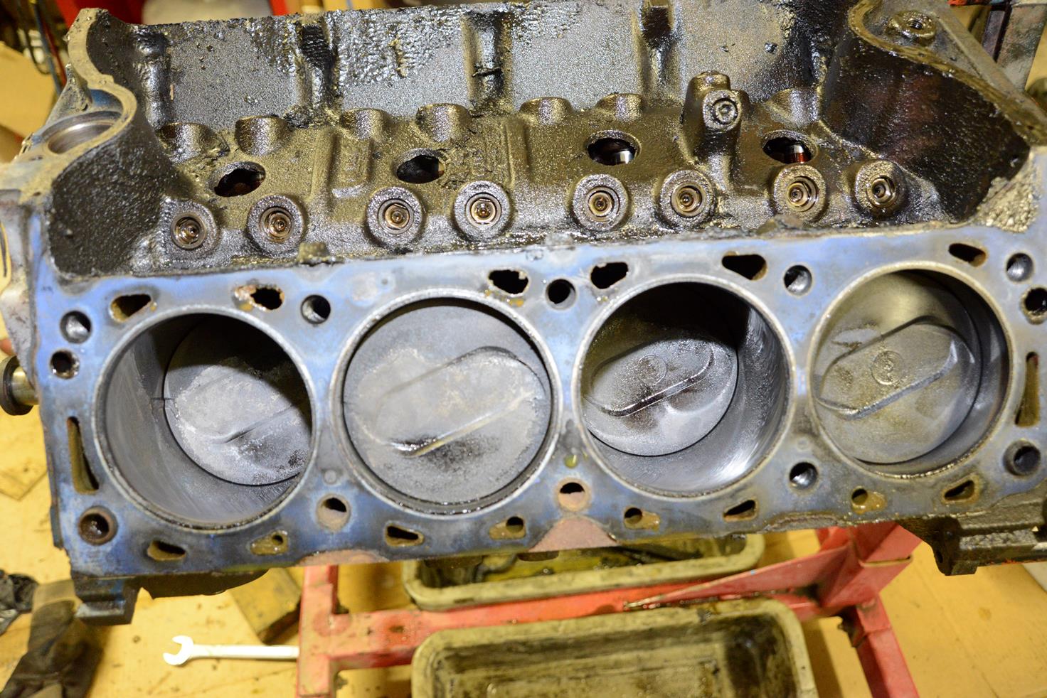

I dropped off the block and all the engine parts at the machine shop today. The machinist noticed the "Felpro blue" on the deck surface and said that the headgaskets had been replaced sometime in the past. It had to be when Grampa had it as I have no paperwork documenting any major engine work since we have had the car since 1991.

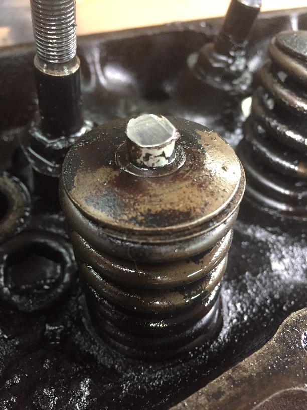

We also notice how badly the valve stems are chewed up. Looks like we need a new set of valves and rocker arms, at least.

I don't think I've ever seen valve stem tips look like that before.
