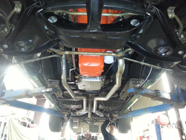

Someone correct me if I am wrong but I believe the 68 COPO Nova came with an extended oil pan and were factory installed from what I recall. It had a cut and welded extension on the pan.
Rick Nelson

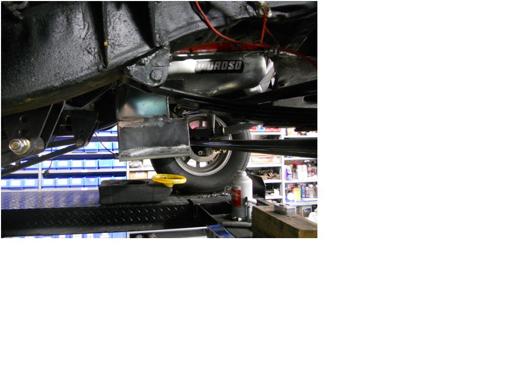

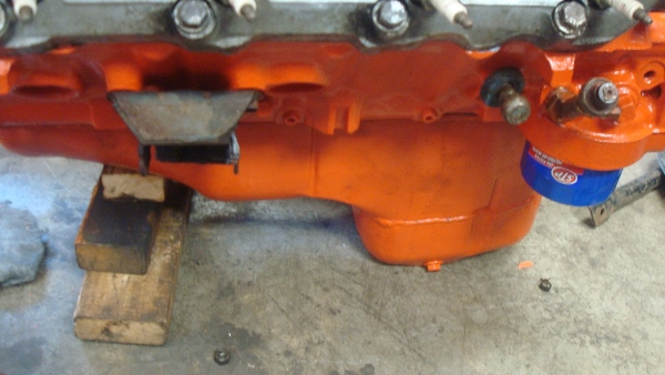

I have a pan with the extended sump, but it must've been a 'home-made" unit. The one in Rick Nelson's photo looks great. Mine kinda appears 'ratty'.

Chevy also made a deep sump pan for the 409, listed in the Heavy Duty parts section. The added sump looked very crude like someone made in auto shop.

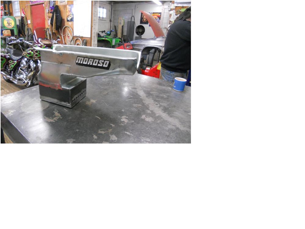

Default Extended oil pans
hi
my original 55 nomad gasser had an extended oil pan on it when drag racing back in the day with cooling tubes through it, but was rusted out on the bottom
so we fabricated another to the same dimension and it is on my gasser now
holds 10 quarts, but ensure you extend the oil pickup for the pump
i also ensured i use a HD high volume pump rather than stock configuration
thought you might be interested

Here is one on a L88 I have. The engine was a over the counter L88 I do not know if it came like that or some one installed it after.
