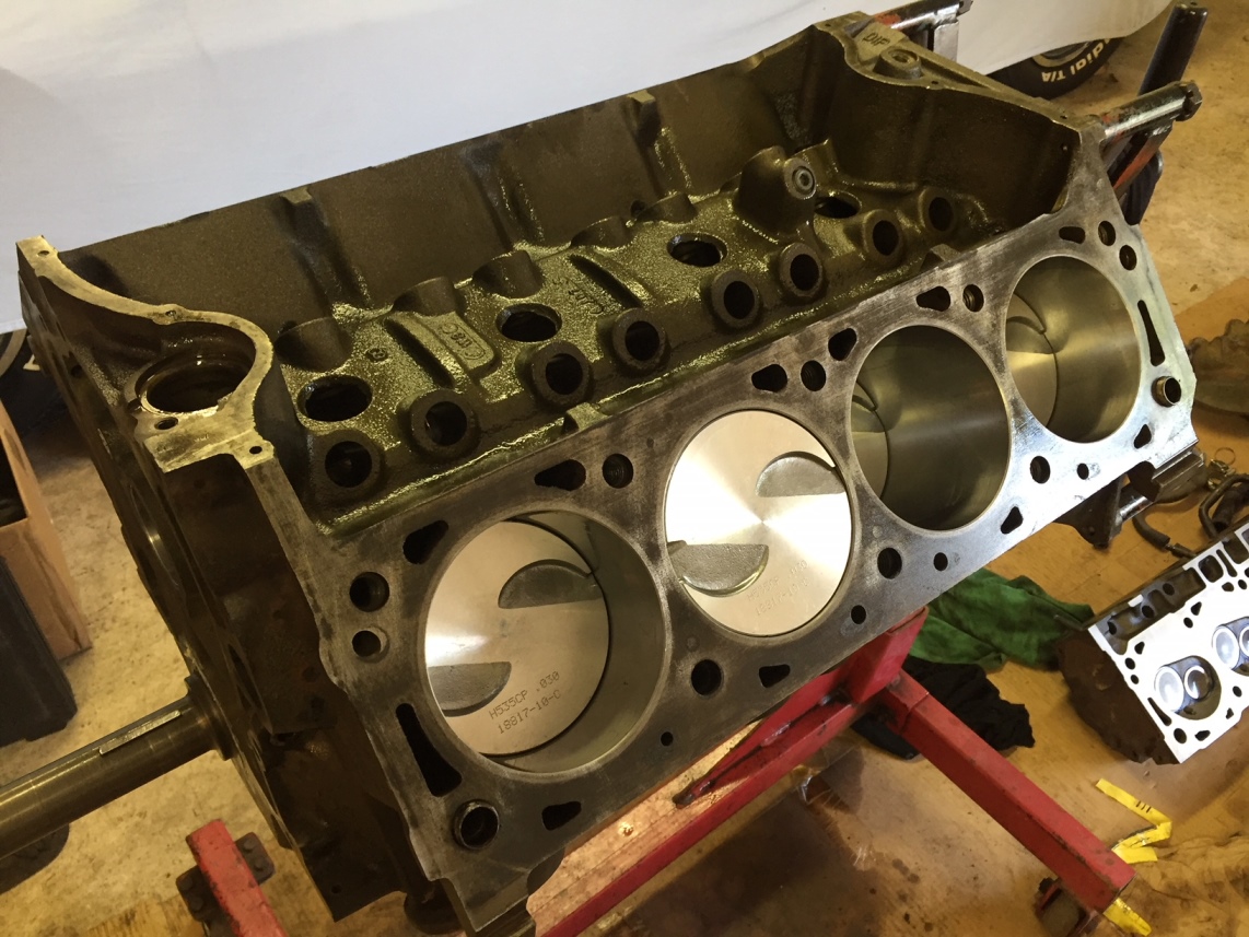

Got all the pistons and rods in today. Plastigage check on each rod bearing clearance was .015. Rotational torque when all eight were installed was 300 inch pounds (25 ft lbs).

Still at it today. Measured the deck clearance with the dial indicator. Came out to .037. CC'd one of the chambers and got 74 cc's. Installed the cylinder heads, lifters, push rods and a new set of rocker arms. Then installed the intake. It weighs a ton! I think it was almost as heavy as one of the cylinder heads.
Worked out the calculations for compression ratio and it comes to 10.78 to 1. It should be "peppy" as Gramma used to say.

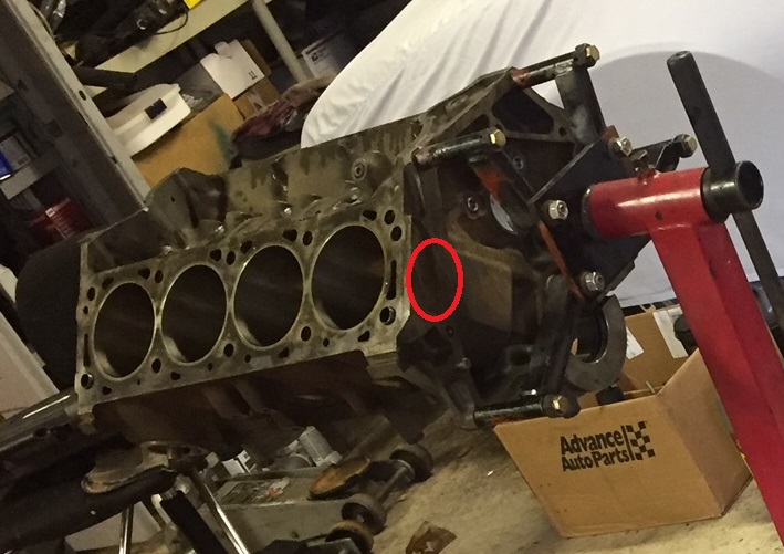

BTW, in case anyone wonders, the VIN stamp on these blocks is on the rear of the block, just below where the driver's side cylinder heads bolts up.

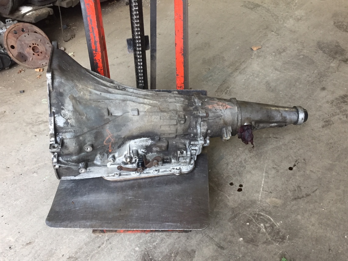

Since the engine is mostly back together I was able to drop off the C6 at the transmission shop. It's an old Lee Myles that has been in business for 50+ years, in Union, New Jersey. The owner knew my uncle back in the 1970's when my uncle owned the Lee Myles franchise on Kennedy Blvd in Jersey City, New Jersey. It's a good shop. They have rebuilt transmissions for me for several previous projects. I even had them call me once after I dropped off an M22 and they called me back the next day and said it doesn't need rebuilding, just a couple of new gaskets: no charge. Nice!
