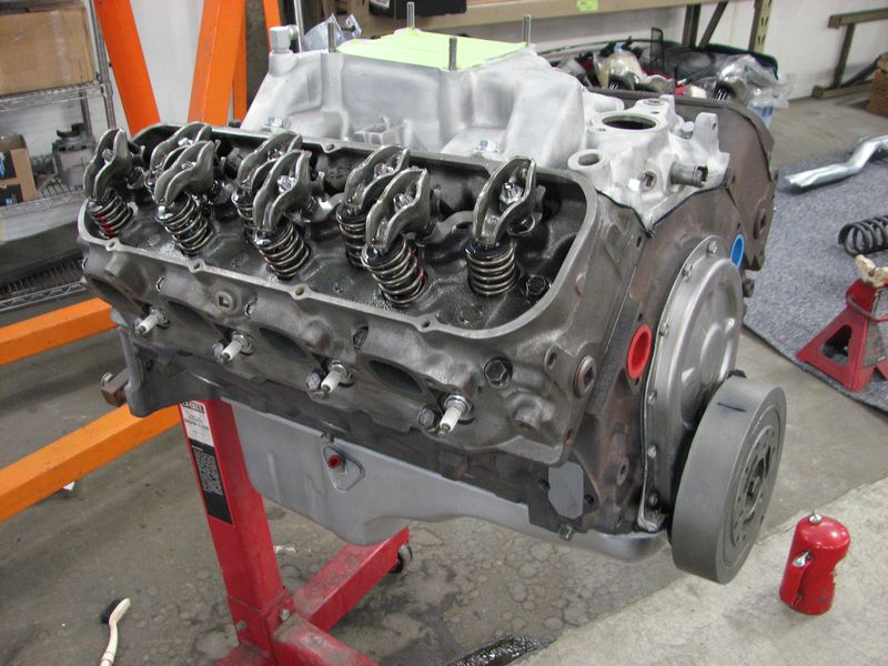

The engine was rebuilt by our own Eric Jackson (Vintage Muscle Car Parts) who did a great job pulling 478 hp at 5500 rpm and 472 ft pounds of torque at, get this, 3500 rpm. This thing will have some power though I am told by a certain young lady that I will never find out just how much. We made absolutely no power adders on this engine and it was rebuilt stock. Stock bore, crank, rods, pistons, a nostalgic cam with factory specs, stock heads and intake. Only the carb and distributor was blueprinted. After completion Eric worked with "Ohio George" Montgomery and dynoed the engine. Kudos to Eric for getting this thing done and with that much power. In comparison, our LS6 454 engines (that I have rebuilt locally) are generally .040-.060 over bore and otherwise stock and pull 475-498 horse so I am very pleased with the results. Correct me on any of this information Eric if I am listing it incorrectly.

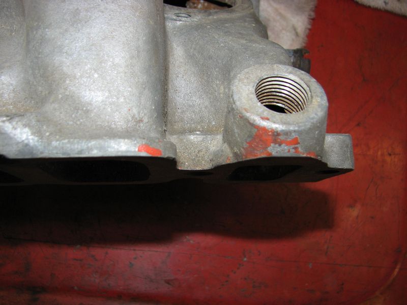

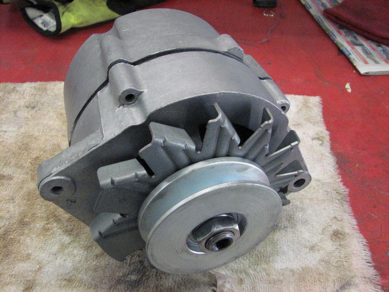

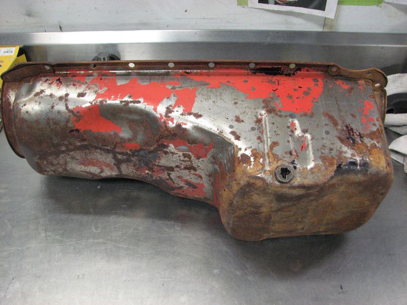

Once received back from Eric it was time to completely wash and clean the engine in preparation for paint. Believe it or not, that can be as much as 8-10 hours. Keep in mind, painting and engine is no different than painting a car but and it has to be 100% clean of any contaminants, primed and painted. Several years ago I had some NOS Chevrolet engine parts that still had orange paint on them so I had some custom mixed for all of our engines.

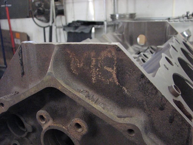

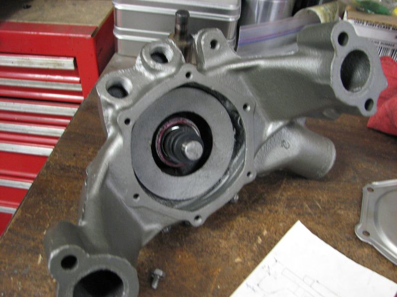

I first prime the engine with high temp cast iron colored paint and with the oil pan, timing cover and rear water pump cover painted with a natural steel color. I used single stage and spray it through a gun, NOT a spray can. From there with the exhaust manifolds (a donor pair) installed I spray the engine with valve covers, by-pass hose, bellhousing, flywheel inspection plate, water pump and few small items like lift hooks installed. I restore our engines with overspray in some areas and lack of thick paint in others. This comes from 35 plus years of experience and also documenting during tear down. This particular engine was very original and you could still make out how it was originally sprayed and any markings that were on it. All were duplicated.
