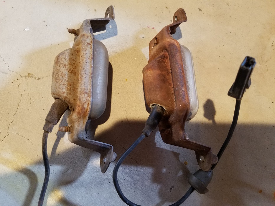

I have a question pertaining to the tag light for I believe the tag light is incorrect for your car and appears to be a 69 Style. Did you replace the original for a better one or is it the factory installed original. I thought all the 67 68 tag lights had a small tab or at least on all that I have seen.

I will have to text Tom. I know what you mean about the tab and the wire should be brown ... I have more items coming back and forth with Tom

Tom says he has several items going at one time ...he says the wire is dark brown but the one in the photo is indeed a 69 ...because it does not have the tab for 67-68

The wire to the tag light on 67 / 68 are black with a gray wire grommet.
The 69 has the brown wire and gray wire grommet.
Here are two original 67/68 tag lights with the black wire and also the tab on the end.
Hope this helps!
