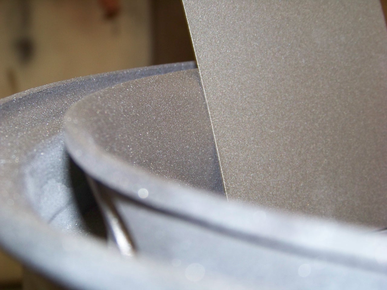

I had the card scanned and then did a spray out which was light, so I added a little black tint and I believe it is pretty close, though the texture is a little odd, am spraying the sets tomorrow so I will report back with the exact amount of 806J added &

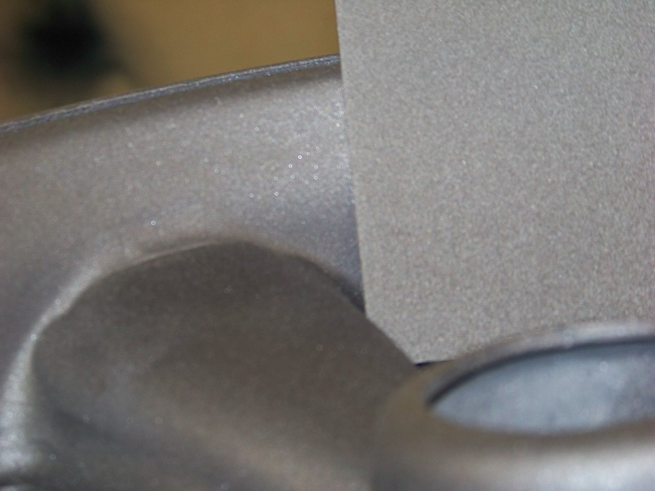

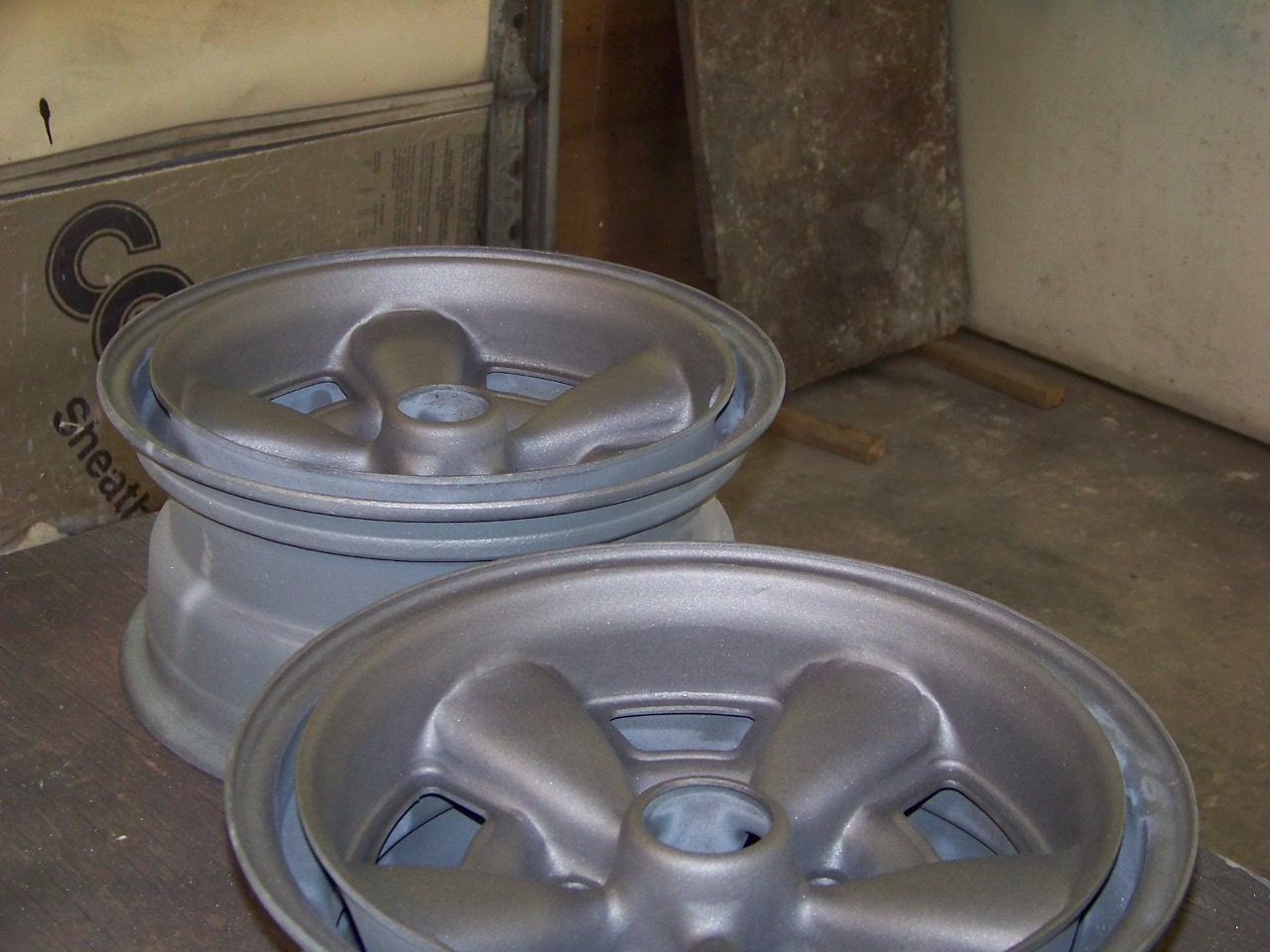

The texture on the card you sent is more even with less noticeable grain than mine.
I originally tried SEM texture coat but it is like 60 grit sandpaper... WAY too rough, then I tried Rust-oleum texture coat first then shot the mix over the top which is what is pictured above.
I am going to do lay down a wet coat then dust them with the mixture needle run close to all the way in for a mist tomorrow.

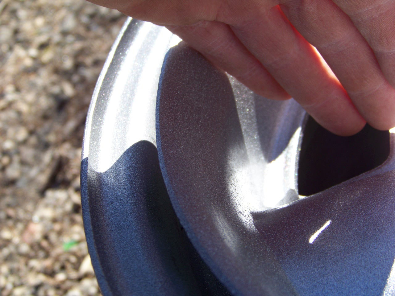

Here are a couple more to try to get a better feel of the color.
The last TWO ARE A WHEEL with ONLY SILVER TEXTURE trying to show the texture prior to the dark gray color.

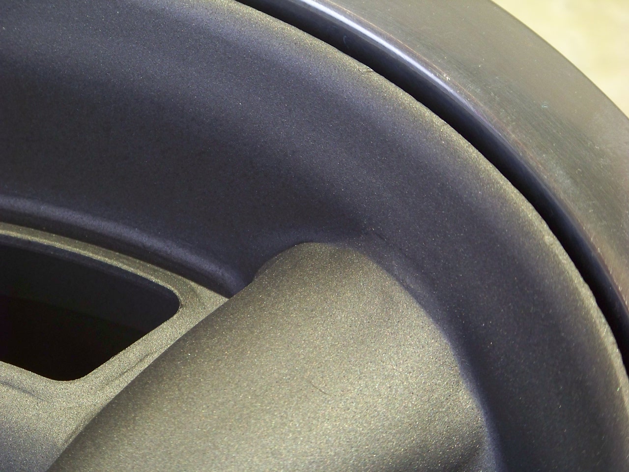

I think I nailed it this time...
I used 6 ounces of the mixed paint - shown in the photo below.
Added 75 ml of 806J
Then added 2 Ounces of Flattener
Catalyst
3 ounces of chroma reducer -
I sprayed it with a 1.4 needle and nozzel with the volume almost off from about 10" moving fast - I ran gun passes using my wrist to swipe the inner area from the rim lip to the center down the lower part the ribs dusting over so as not to get too much build -

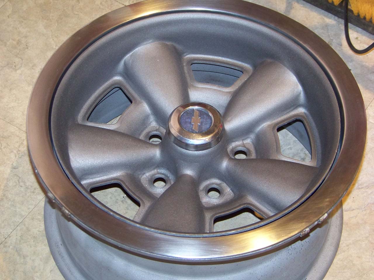

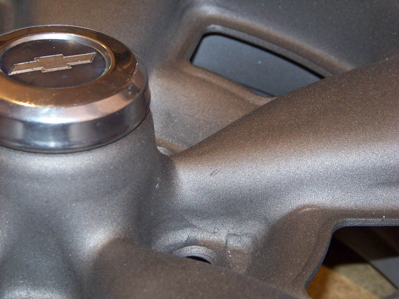

I can't tell you how satisfied I am with the wheels... I threw a center cap and trim ring on it and took some pictures... The lighter ones are with flash the other's are without flash.
