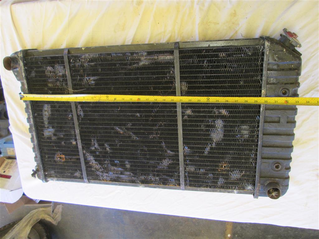

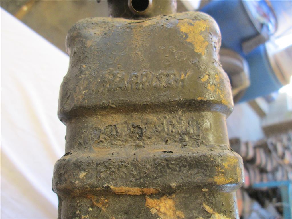

I was wondering if anyone could help ID this radiator. It is a an original Harrison unit and has a 4 row core. It has pretty thick paint on it but I can make out a ZV code on one of the tanks. It came out of a 1967 Camaro racecar. Any help would be greatly appreciated.
Thanks,
Jason

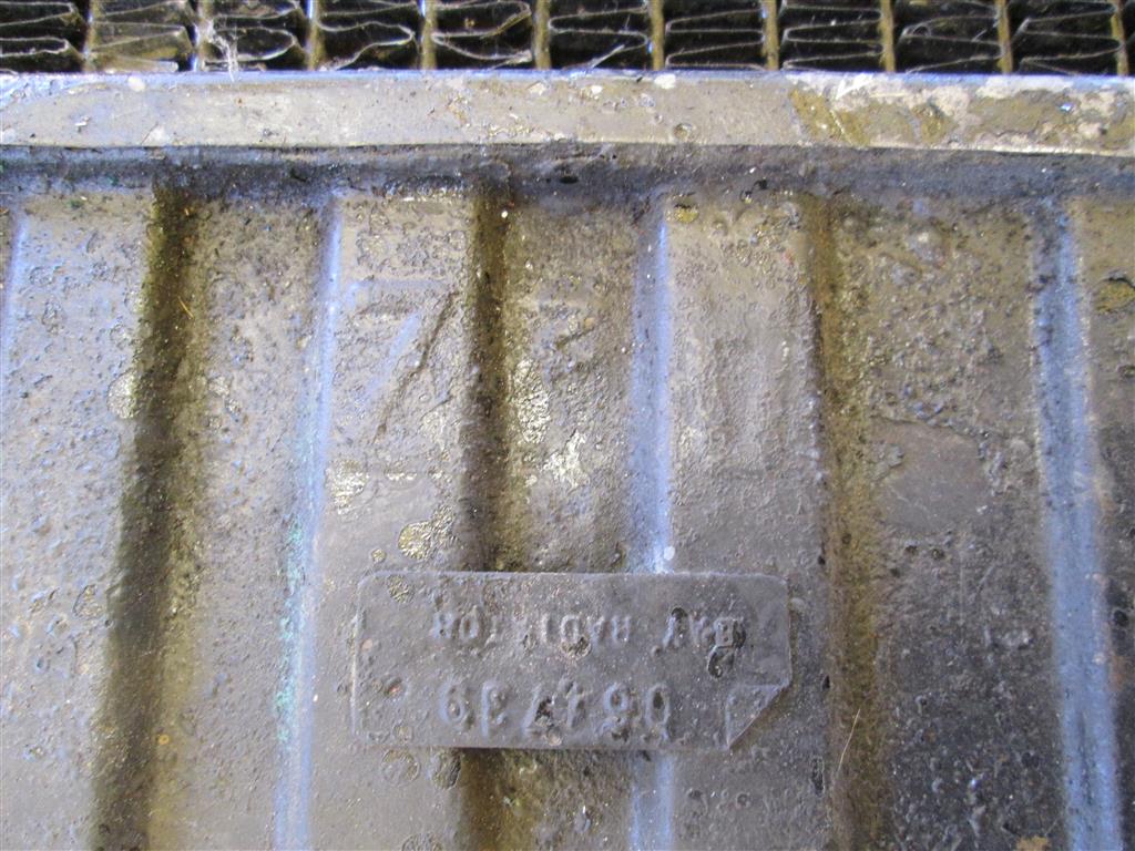

Looks like A Z with a 2 between the letters to me.
Not a 1st Gen Camaro

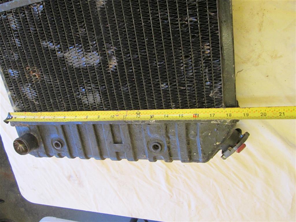

Look @ the angle of the filler neck..that's 1972 & up.

Thanks guys. I knew it was not original to the Camaro. Maybe 2nd gen Camaro. It is pretty beat up but I can't bring myself to throw out an original Harrison heavy duty radiator.
Jason

there is a K above the 2... it's for an EARLY 1973 model.
K = November
2 - year manufactured
My brother's 1973 Z28 built in Jan has a L2 radiator.

Wasn't K October? Pretty sure I've seen 'M'-dated rads, but maybe it changed in the 1970's?
I did not know that. Were earlier tanks more vertical? Did we ever figure out the original application for the "AZ" tanks? I believe I have one of these in our Chevelle and I never knew exactly what it was from.
