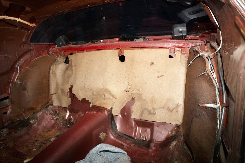

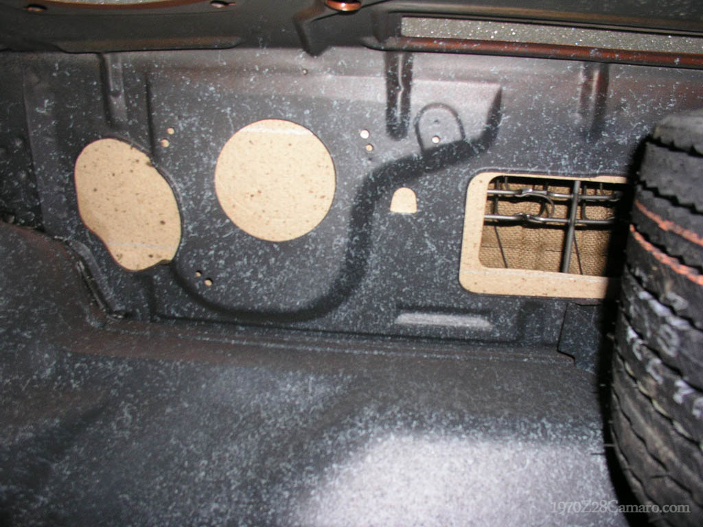

Any good sources for large sheets of material they made into seat/trunk dividers back in the day. From what I've gathered off the internet, the material is referred to as chipboard. Matching pictures indicates its unbleached. Uline sells 40x48 in 0.022" to 0.120" thicknesses, but the cost is in the hundreds. Only need a couple of sheets. Dividers sold by the parts guys have the correct cut, but are made mostly out of solid black cardboard.

Measured my divider...looks to be about 0.090 thick. most likely a nominal of 3/32" originally.
For the insulator, look at the first photo you posted on the inside of the trunk. You can see the foam peeking out around the openings. Apparently it could either be foam or jute. I haven't discovered where or when it transitioned or if it was an either-or thing. My car was a Z87 car and it supposedly had "extra insulation" as part of that option package, but nobody has ever said what that actually is other than the underhood mat and the cowl seals. Maybe the foam was part of that?
