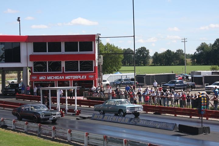

I had to convince Keri to take this picture.... although she warmed up to the three wins to zero wins theme pretty quick!!!
Ryan W31
  #3072
Old 09-17-2019, 10:52 PM
Posts: 9,337
Thanks: 32,028
Thanked 4,442 Times in 1,888 Posts
----Love those T's, Ryan! You done good, my friend. A weekend without breakage is a positive. Don't ask me why I know that, and you surpassed that hurdle. I was in your country while you were smokin the tires in mine. Just got back 2 hours ago. Love Canada! I think it's the cleanest country on earth, and everybody seems to be smiling all day long......Bill S

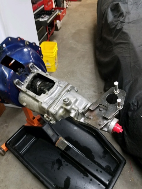

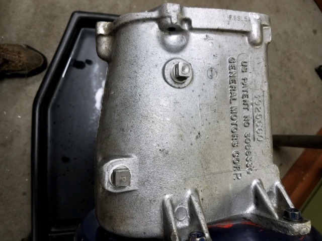

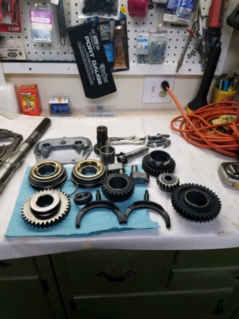

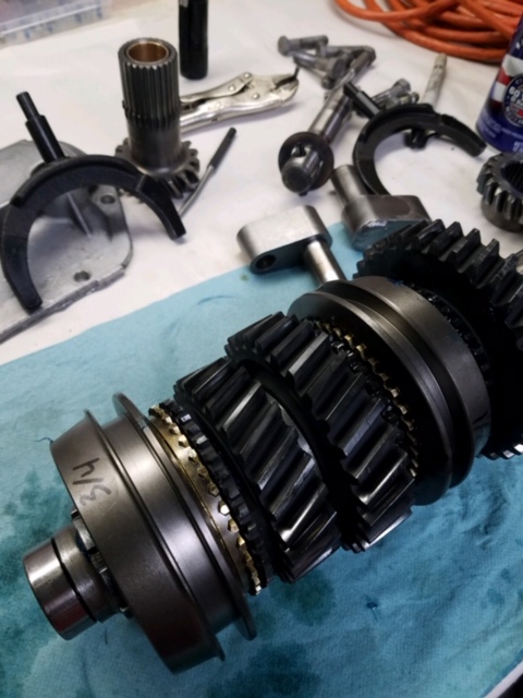

Status... temporarily grounded.
I pulled the trans, and met Nick in North East PA to hand off. He has disassembled, analyzed and sent all the “shifty bits” to Craig Wright in AZ. Craig quickly diagnosed the torque lock sliders as “NG” and the 1-2 was too tight. Nick used the items supplied as a kit but the kit didn’t work as planned. The trans is going back together currently.
I have to have the car running soon as next Friday Weaver4, the Stagers, and Kenny Kroeker (a local photographer working for Bone Stock) will have a photo shoot here in town to make an article for an upcoming Bone Stock and Modified Muscle Car Magazine!!!
Weather is turning so I am not sure I will get another drag strip event this season but will be ready!!!!
Ryan W31
  #3080
Old 10-03-2019, 11:48 PM
Ryan1969Chevelle's Avatar
Join Date: Nov 2012
Posts: 5,959
Thanks: 581
M22Z (3) version 2.0
Nick Morocco has my M22Z (3) rescue completed. New sliders, new shift forks, shift shaft welded, heavy spring for combs, it should be happy now!!! He even added a drain plug (magnetic)
Ryan W31
