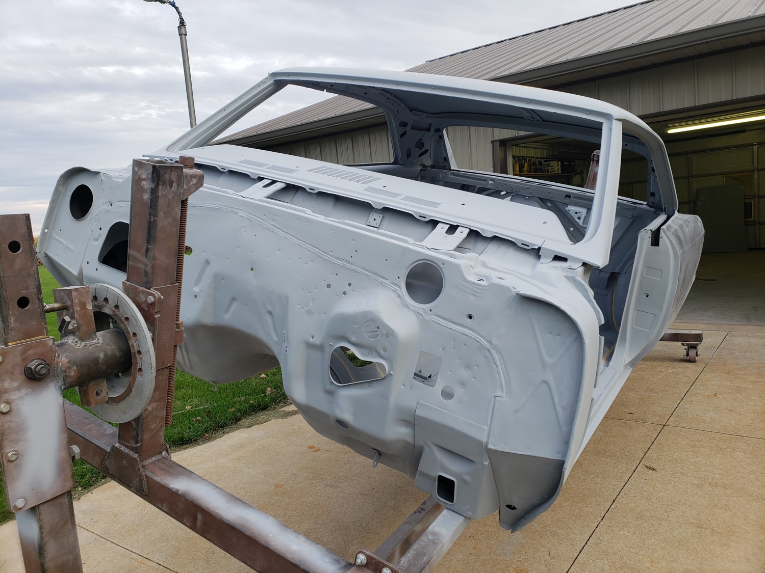

Default The end of Metal Work
It looks pretty ugly, but all rot has been removed and all panels replaced with used GM metal, next step is to acid the body panels and sand blast the rest. Sadly I thought I was done, but as you will see in a few pictured down the line I tried shrinking some dents on the roof with some heat and that just turned into a massive oil canning mess

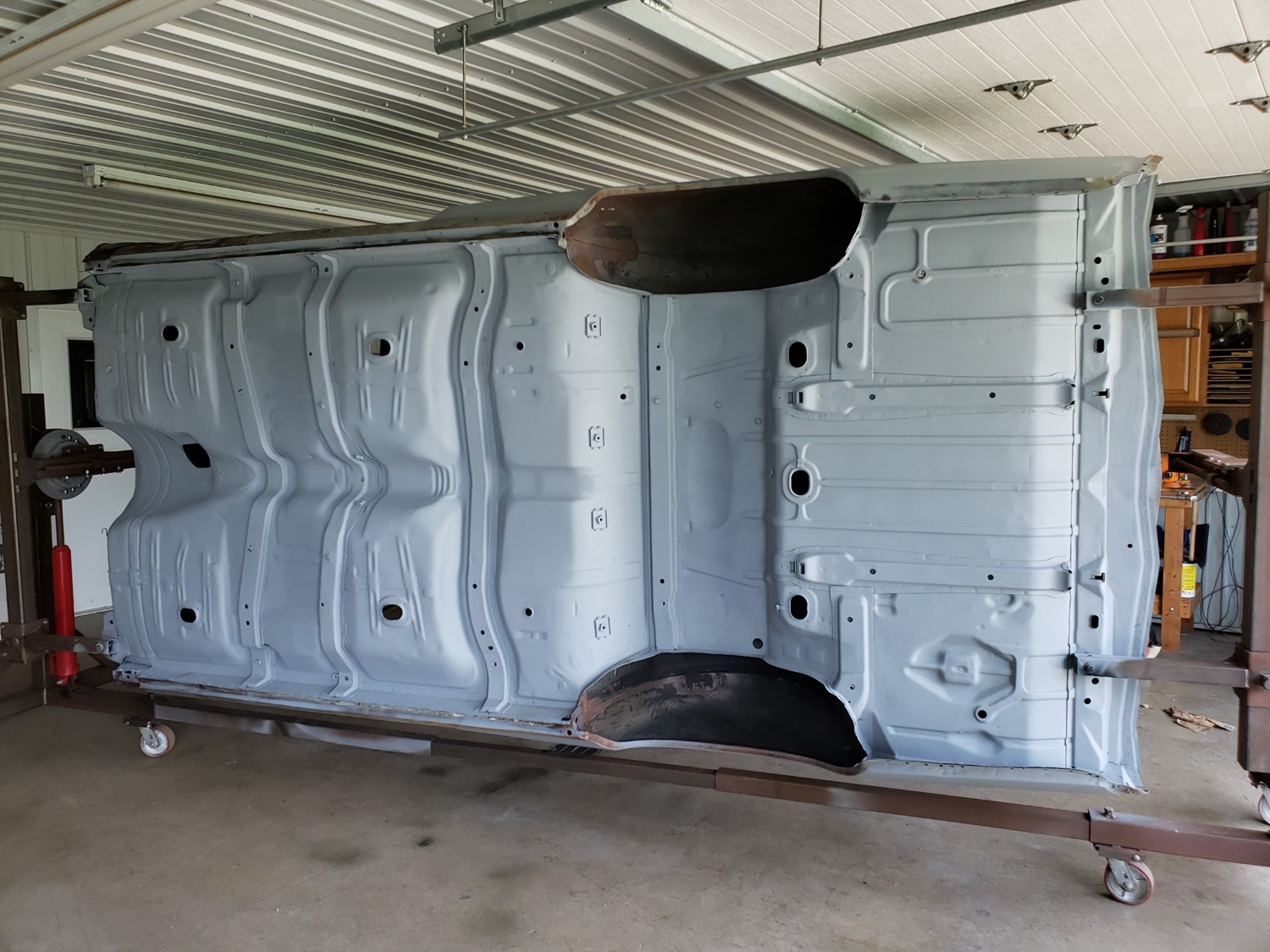

Default Underside Blasted and Primed
I ended up blasting in June. I about died doing the job in the heat.

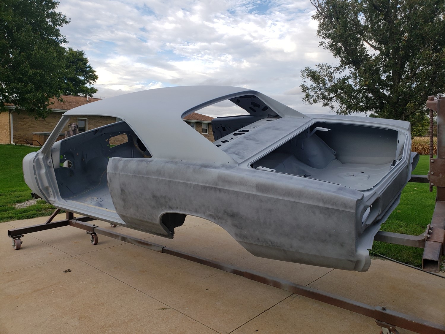

Default Body Work Complete
These pictures represent a few hundred hours of block sanding and just sanding in general. Panels have been guide coated. Body seams have been seam sealed. Time for edging and chassis black paint now.

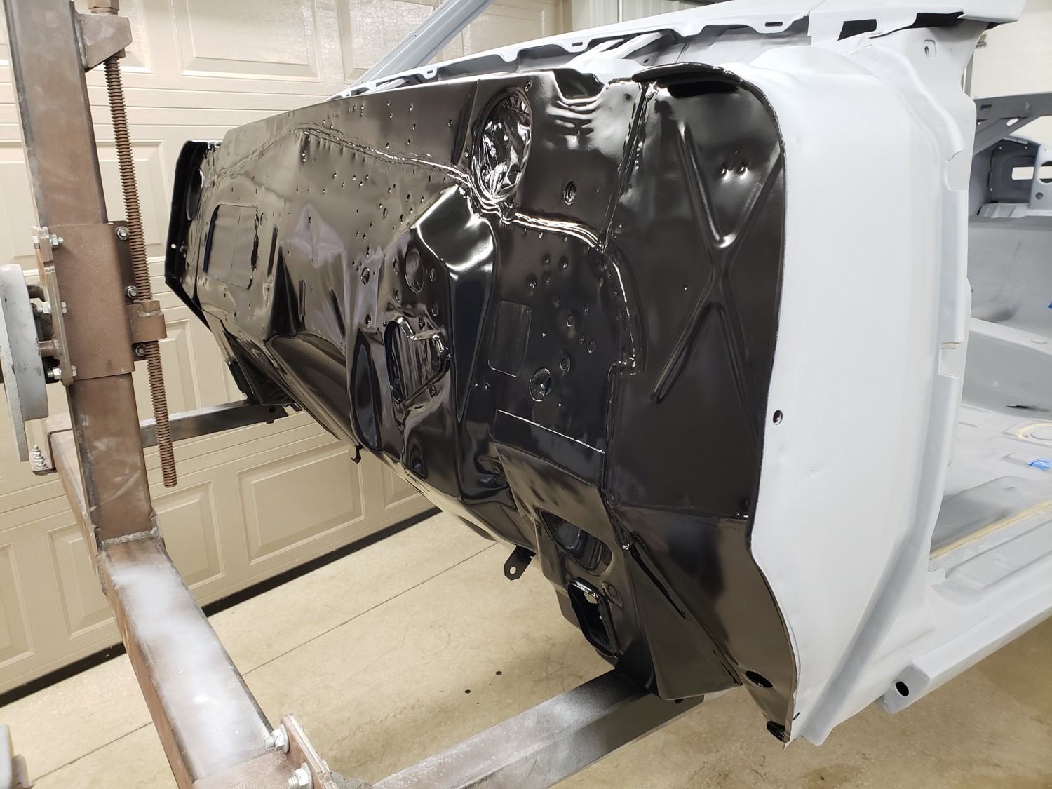

Default Chassis Black on underbody and Firewall
Fresh paint finally laid down
