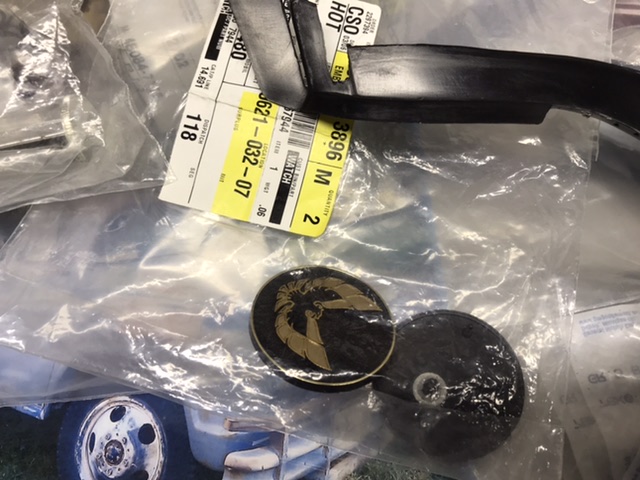

The strap is the same used to hold on the emblem to cover window crank hole. Ames still sells the box and the strap. Boxes have the jute glued on. Boxes may not be OG these days. May be repop. The bracket pop rivets on the speaker. I may have one on a bad speaker.

Lol, speaking F body, if you have power windows, there’s a hole in the door card, they put a emblem in there to cover the crank hole, The retainer is same as speaker box.
Go to the Ames perf and look up the parts you need.
http://www.amesperf.com/?gclid=EAIaI...SAAEgL1gvD_BwE

Here’s the emblem I’m talking about. Same retainer is used.

Burd , now I understand.
