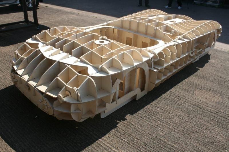

Here's a couple examples of body bucks along with one guy that had one made for a Porsche by a company in South Africa which were laser cut and shipped to him.
Gonna be fun!
