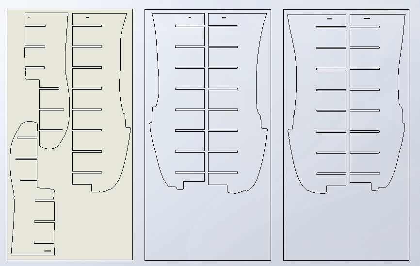

  #87
Old 01-30-2020, 02:41 AM
A12pilot's Avatar
A12pilot A12pilot is offline
Join Date: Nov 2014
Location: DFW
Posts: 2,789
Thanked 5,274 Times in 1,224 Posts
Great link Freddie!
We're getting closer! The stations are done on both lateral and longitudinal axis. These are the longitudinal ones that interlock with the lateral axis stations to form the structure. Next up is getting the quote from the CNC guy for laser cutout MDF stations! More to come with more details to follow. It's getting closer!
And yes, I plan to document the pricing on this project so nothing is a mystery. Why not? I think it would be good to show what a project like this costs especially in this phase of the plan.
Cheers
Dave

  #89
Old 02-09-2020, 02:03 PM
A12pilot's Avatar
Join Date: Nov 2014
Location: DFW
Posts: 2,789
Moving forward, the CNC company came back with a quote for the panels to be routed out. They're starting that process and based on their schedule, I should pic them up the first week of March!
Through sheer Yenko.Net comradory and the ability of many to help others in this site, I've found a Nicson 2x2 intake complete with carbs courtesy of Hawkeye's (Marty) sharp eye! I use this term sparingly, so consider it the ultimate Super Dave compliment: You da MAN!!
As I stated, here's my breakdown of the design phase of this. I used Mike at Partsnap.com for the 3D work and one of his suppliers for CNC work will provide the cutouts. To scan the model and do the 3D work on the stations was $2600. Considering the first guy I contacted, while enthusiastic and knew exactly what I needed since he's done them before, wanted $10k-$15k (not an exact quote, just a shooting off the hip estimate), I think that's a screaming deal and I'm beyond impressed with his work and detail. The CNC panels are quoted at $3100. So I'm in this at $5700. Of course the model cost at $75 and then the extra materials to assemble the buck will be superfluous (me so smart n' stuff!), so let's just round up to $6k for the design and execution (smart!) of the start of this whole endeavour (man... I'm killing it with big words today! )
More updates to come soon as I start to acquire more parts next week! Body buck assembly next month!
Cheers
Dave
