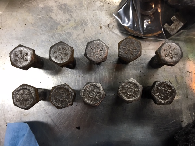

Got the manual steering box mostly cleaned up today - dated June 12. Also found what I believe to be an interesting assembly line thing. The bolts that hold the two-piece rotor together were different from one side of the car to the other.

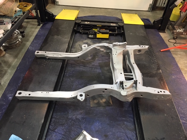

Default Front subframe update...
Got my front subframe back from a "bake" and bead blast session today. Turned out really nice and clean. Frame is in great shape with only minor pitting in a few places. Car should be getting some color on it in a few weeks. Won't be long and I can turn the ratchet the other direction and start putting this thing back together!

It's looking really good. I always love the look of a freshly restored subframe when it's all going back together. Painting or powder coating the subframe? Body is looking close to having color.
