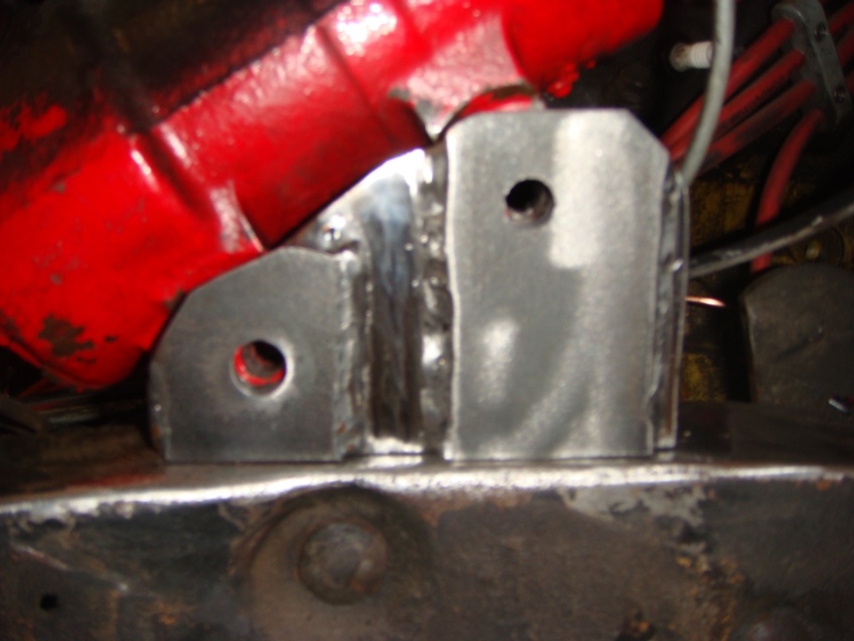

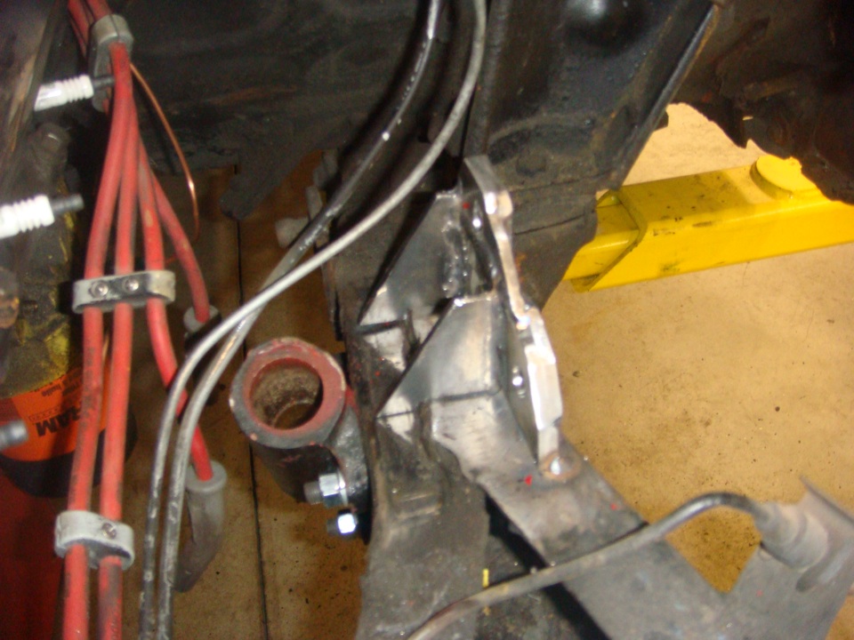

Cool Project! I did a 605 box conversion in a 55 Chevy 10 years ago and the factory pitman arm spline does indeed match up.
Here are a few photos of the crude mounting bracket I made to accomplish this.
