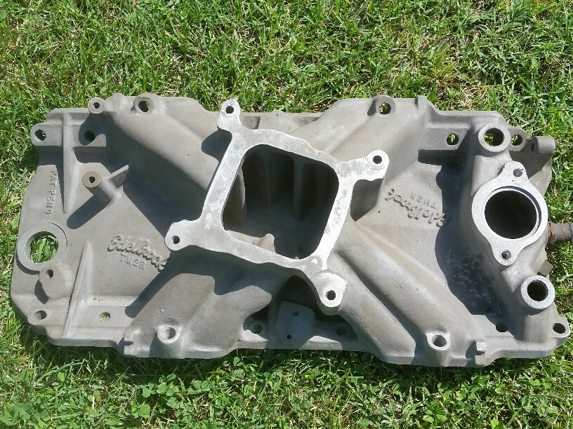

I've had one of those torkers sitting on a shelf for about 35 years. I need to let it go. I've got too many intakes sitting around that I'm never going to use.

I’ve hear mixed things about them. I don’t have any experience with them. I know it’ll be a choking point for this big inch motor but it screams the ‘70s and looks so cool. My builder told me they were the hot setup back then and were pretty normal to see at street races and cruises. If it worked then I’m sure it’ll still work good today.
