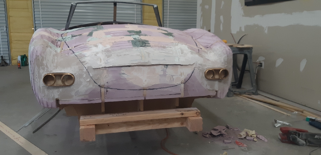

This rear is getting more work done to it than a farmer's daughter in an adult film!
Tail light positioning and I'm liking the lines back here more and more. I'm going to massage a template for the edges of the rear quarter to make sure they are symmetrical. Right now, it looks pretty good. License plate relief and trunk opening are there too.
I'm hoping by the end of next month the car will be filled and primed. I need to make a steel frame with rollers to position this on since the weight of this thing is more than I thought!
I'm closing in on buying the donor car too!
More to come....
Cheers
Dave
