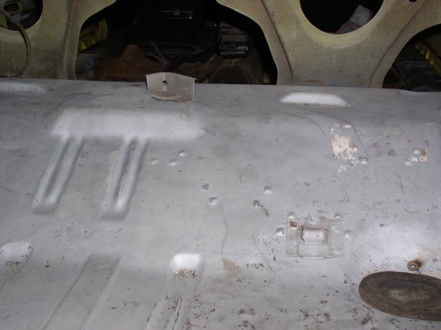

Moving forward to this restoration meant undoing everything I had done the first time around. Out came the power windows. Off came the rally sport. Off came the ZL2 hood. I bought everything new from GM when I bought the hood except the harness. Those were the days. No more JL8. Fortunately I kept all of the parts that I removed knowing I didn't want to lose any of the original pieces.
In November of 2018 I decided I needed to install another trunk floor. The car had 3 things that were not in it's favor, vinyl top, trunk mat & bad gaskets on the lid & lights. All of these lead to leaks which rotted out the trunk floor. After some study I decided an aftermarket floor wasn't what I wanted to use. A guy in Phoenix had the rear clip of a 69 with a nice floor & only wanted 150.00 so off to Phoenix. This is the hard way to do a trunk floor but it was worth the efforts to me. 160+ man hours. There was enough pieces from the rear clip to fix the bottoms of the quarters & the section where the back up lights were...Joe

Wow, kudos to you Joe for not taking the easier way out on that trunk floor, not that any of that is easy. Impressive and keep up the great work.

Yes, credit to you for grafting in donor metal. That's a lot of detail work!
