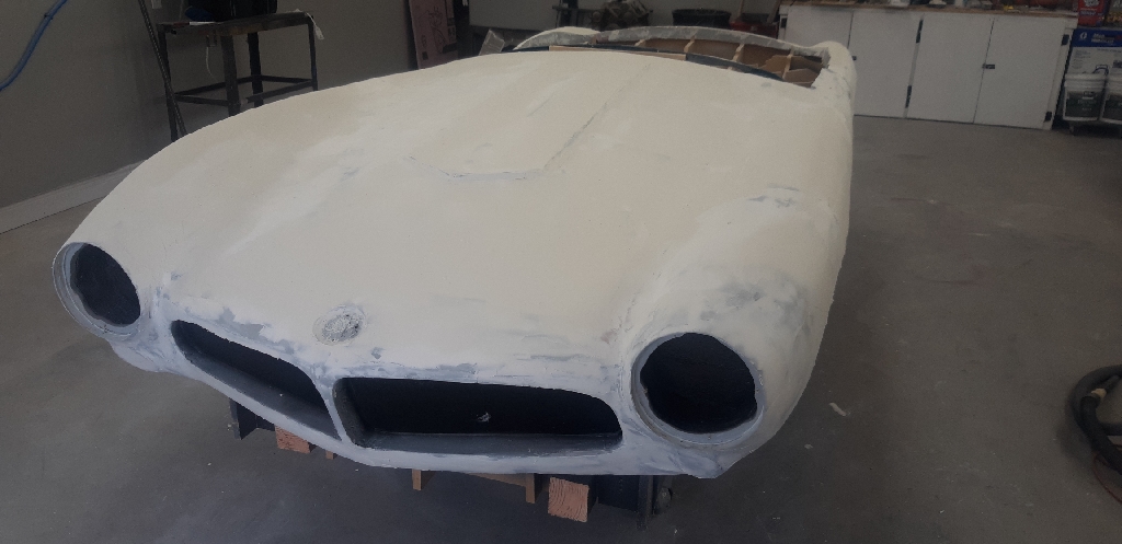

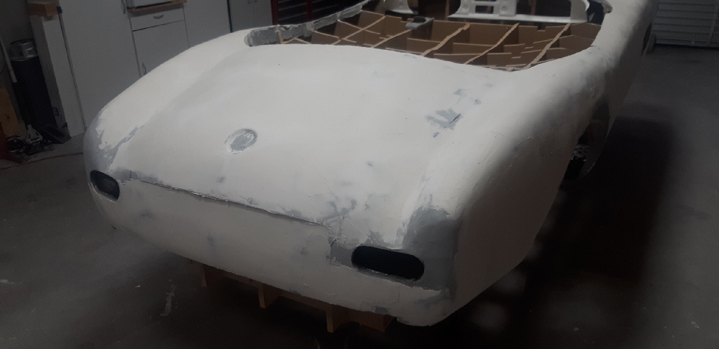

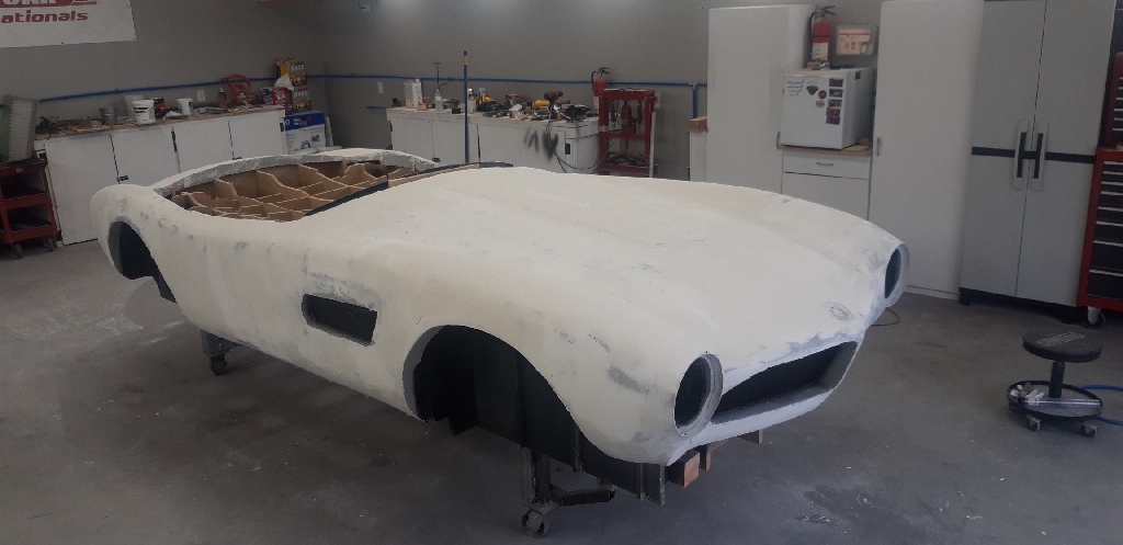

Old 09-02-2020, 04:22 PM
A12pilot's Avatar
A12pilot A12pilot is offline
Join Date: Nov 2014
Location: DFW
Posts: 2,789
Thanked 5,273 Times in 1,224 Posts
Round one of blocking is complete, and another coating of fairing compound is hardening as we speak. This needs to set a day before I can sand it down, which will be no problem since I'm headed up for my annual recurrent training for three days.
Meanwhile, I got some steel to start fabricating up the windshield frame. Next week I'll be buying steel to start forming panels and hope to have the body buck at the final stages. Also, going to look at a couple R107s for my donor chassis.
Cheers
Dave
