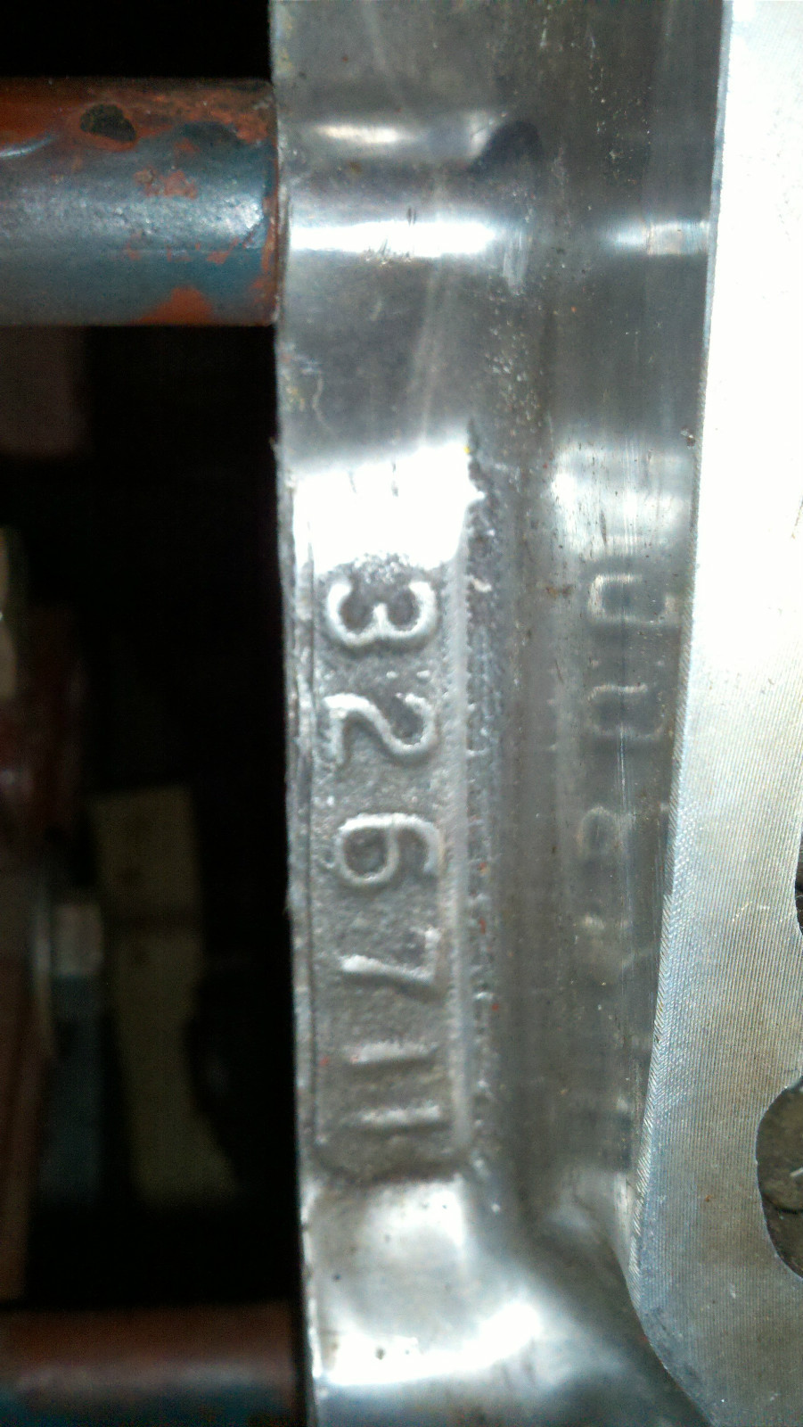

I have one of the 0-326711 Blocks.
I heard that Chevrolet ordered 20 Blocks (minimum order) of all 0-blocks.
Its the third Prototype / Eperimental casting of CanAm Big Block
They were supposed to be scrapped after trying them out but came out the back door to Racers. WDC Casting.
BTW Mine have provision for fuelpump.

Heres what I have found out.
And I thought WDC means Winter die casting
Can-Am blocks 68/69 - Winters
# 0-294550 = 4.250" bore with steel liners Experimental Prototype 67-68 Dry sump (427 ci)
# 0-321270 = 4.440" bore with steel liners Experimental Prototype 68 no boss for mechanical fuel pump(430, 465 ci)
# 0-326711 = 4.440" bore with steel liners Experimental Prototype 68 (430, 465 ci)
# 3946052 = 4.440" bore with steel liners (430, 465 ci)
# 3946053 = 4.440" bore with steel liners (430, 465 ci)
Can-Am Block 70 Winters
# 3946052 = 4.440" bore with steel liners (494 ci)
# 3946053 = 4.440" bore with steel liners (494 ci)
Can-Am blocks 71-72 - Reynolds
# O-399204 = 4.5" bore and steel liners (509 ci)
# O-495102 = 4.5" bore and no liners
ZL-1 Factory blocks - 1969 - Winters
# 3946052 427 ci.
# 3946053 427 ci
ZL-1 Factory blocks - 1997 & up
# 3946053 427 ci.
# 3992038 may be 4.44" bore w/ Liners - era?.
# 3946052 Yenko Casting LC 427
# 3946053 Yenko - Casting has YENKO
# 3946053 Yenko - Casting has Y E N K O
# 394605Y Yenko - Casting has Yenko Crest Logo
