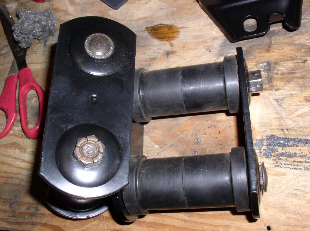

The original leaf springs were soaked in evap-o-rust, washed completely & then hit with 0000 steel wool. Sprayed lightly with satin clear. NOS bushings used in the forward eyes. (I hope I put the spring decals in the correct place)...Joe

The car being from Tucson, all the hardware & brackets were in great condition. Original "S" shackles & bolts/nuts & NOS bushings. Original spring pockets. Original spring plates & brake cable guides. I also have NOS spring pads. All powdered back to original color. Managed to scare up some original "832" rear shocks....Joe

Looking really good Joe. The diff housing looks terrific and I really like the clear look on the springs. I'm sure you're busy trying to decide what to put where and what to do first.

Joe, looking really nice. Spring decals are in the proper location.
All of the NOS leaf springs I have seen, have a bluish tint from the heat treat.

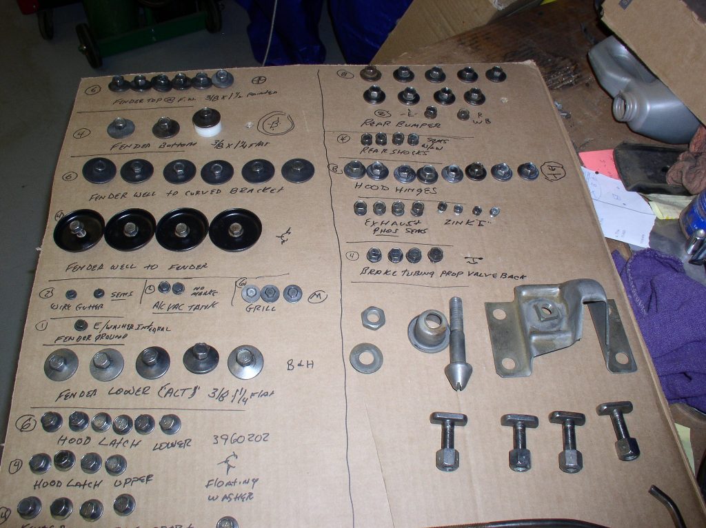

Over the last couple of days, I've been putting together bolts & items that require phosphate coating. I put them on this cardboard so when I'm done with the process, they can go back to the board....Joe
