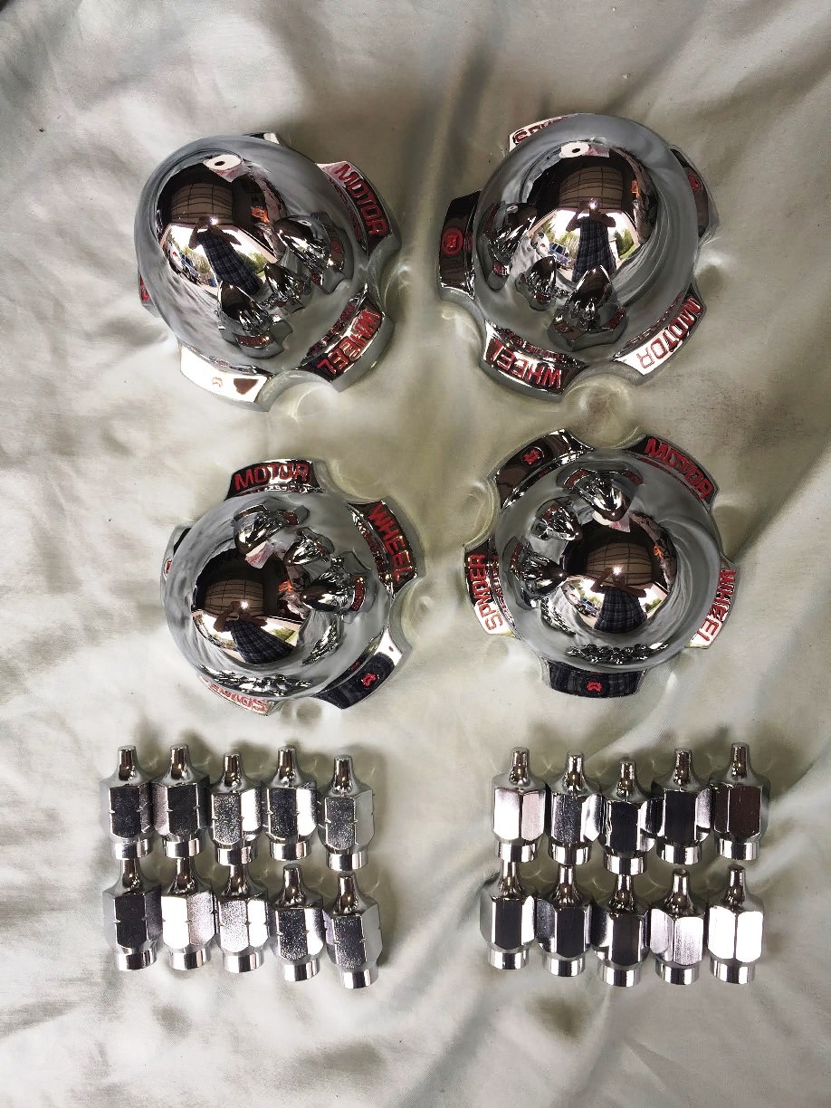

Look what arrived today! I found a machinist out in Wisconsin who reproduced the metal Motor Wheel Spyder centercaps several years and has only a few left. He also reproduced the original pointed lug nuts in left and right thread for Mopars.
An NOS set of center caps will run you over a grand. This was about 2/3 that price and better quality than 50 year-old NOS chromed potmetal originals. These are made out of thick brass and chrome plated. They are heavy! Like the weight of a metal coffee cup.
The main problem with the Spyder caps is that they stick out farther than the edge of the rims. So if you accidentally placed the rim face down on the ground once, you crushed the ends of the caps and ruined the cap's point. The other problem is that they were made of cheap pot metal and corroded after a few years.
So now I am 2/3 of the way to a set of 14" Motor Wheel Spyders for the car. Time will tell...
